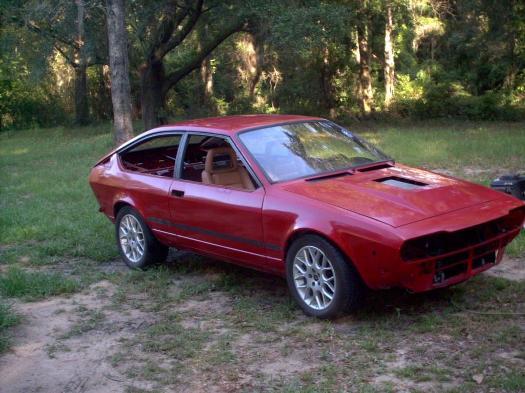

Like the pure shape of your red gtv looks great like that. Mines gonna have some way to go until I am at that stage

alfaboy 1970,
Stick with it!! It's worth it!! Trust me. I can see from your stable you're an 'odd duck' as I am and any other GTV6 fanatic. They are excellant vehicles and they reward for the time & funds investment (which it is) is definitly worth it. The rewards positively out do the investment as long as you are able to do it correctly..... This car required a lot of attention to get to this point. When 'she' arrived on the car carrier, I was quite dissappointed. However, after rolling up my shirt sleeves and digging in, she is an excellant example of a fabulous work of art and definitly worth preserving and enjoying.
The country boys painting my car love it as well as many customers who have dropped by the shop.
Picking her up tomorrow from the painter tomorrow and dropping off another (BMW M635CSi) tomorrow to retrofit the GTV6 for completion - yeah right - completion - I'll pull out, OK???
3.0 ltr to follow. 'Film at 11'....
