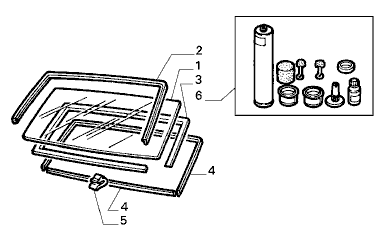

Try ordering parts from somebody like www.Difatta.com
All these numbers still in Alfa catalog:
60701206 inner gasket
60701207 outer moulding
60527756 spacer 3 ea
71711976 sealer kit
60598485 gasket under glass weatherstrip is listed in their data base pdf

Here is picture of windshield parts listed above
Windshield gaskets and trim
