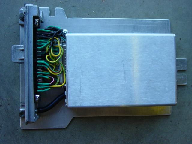

Yes it will but why bother ? Its easier to use the MS enclosure and mount it to an aluminum plate on which you also mount the L-Jet connector.I've attached an image which someone else ? posted on this site and which I copied.I works well.Will MS-II fit in a L-Jet box or is it just MS-I?

- finished.jpg (39.85 KiB) Viewed 20820 times

Grant when I started with MS I made sure that I could easily convert back to L-Jet if necessary.I even did that last summer just to get a seat of the pants impression of the value of MS - boy was I glad I converted
The setup shown above is based on wires run from a DB37 female plug (which plugs into the MS male DB37) and then those wires connect to the L-Jet plug which is mounted at the top of the aluminum plate.The car's L-Jet plug on the wiring harness then plugs into that.To reinstall the L-Jet ECU you just remove the plate c/w MS and L-Jet plug and plug in the old ECU.

Grant yes in order to use the stim all I have to do is take the MS enclosure off the mounting plate and plug the stim into it.
