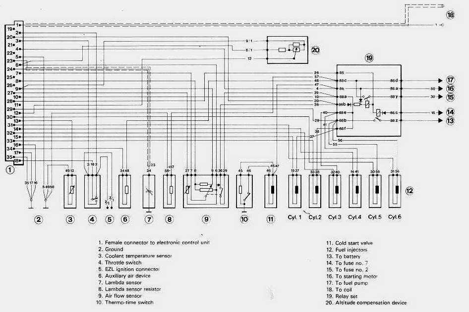

Got hung up working on the Spider and getting the A/C fixed in the Verde (didn't want hot air blowing all the way to the convention and back!) but I'm itching to get on with the MS project. My next step is to build the wiring pigtail between the DB37 and the Bosch connector.
Looking through the service manual I wasn't able to find a pinout diagram for the Bosch connector and I could have sworn my AutoForce tester had one but it didn't. So poking around on this site I found this thread with a diagram
http://www.alfagtv6.com/bb/viewtopic.php?t=166
Is this what you guys used? Is the posted pic accurate? Seems there was a little confusion around that.

James all I did was put a relay coil in the circuit from 88b of the combo-relay and terminal 20 (L-Jet) - 37 MS.This grounds the coil through MS.The contact controlled by the relay is between 88d of the combo-relay and the pump +

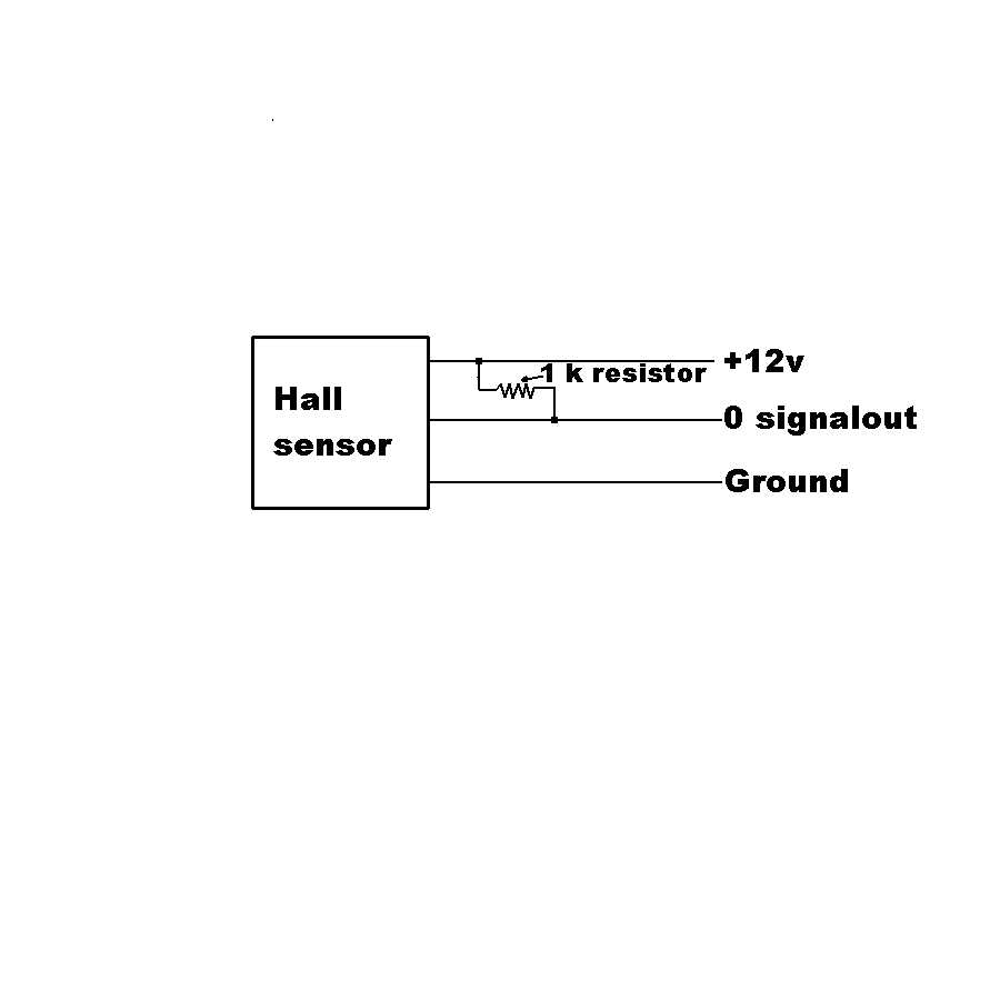

OK, I need some guidance on this mod to the wiring. Can you tell me what I need to do here? I'm not sure what a pull-up resistor is and where I'd need to put it and what mods I'd need to make to the wiring harness. I'm assuming I'd need to make some since the default is for the coil to be used for the RPM signal for LJet pin #1 right?Murray wrote:Kevin you should probably go with 50a.The ignition signal from the hall sender in the distributor is much "cleaner" and is easier to work with.You will have to make some small modifications to the car's wiring (pull-up resistor) when you install your MS in the car but we''ll guide you through that process when you get to it.

For the pull-up resistor - I don't have access to my notes at the moment but basically you'll need to install a 1 o2 2k resistor between the +12 qnd the signal out wires from your hall sensor to make it work.If I can get to my notes I'll provide more info.
Kevin here is a rudimentary sketch of the pull-up resistor required on the hall sensor.Basically when the hall triggers the resistor causes the "0" signal line to output +12V which is what MS wants to see to signal an ignition event.On mine I spliced the resistor between the 2 wires and then enclosed it in heat-shrink tubing.
