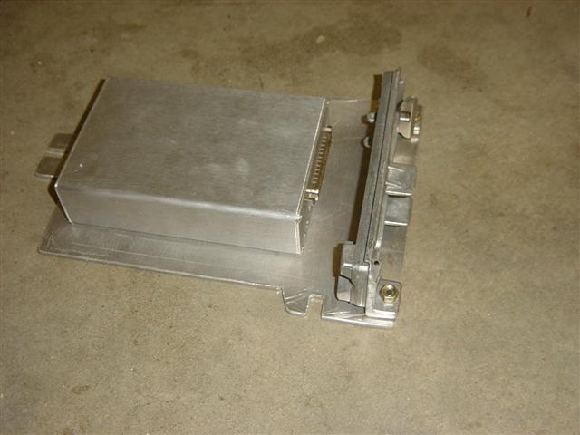

I've just about completed my 2nd MS install, this time on a stock 2.5L 85 GTV6. I took the easy way out this time and bought a ready built unit. The GTV6 mods to the MS board are finished. No big deal as I had some spares from my first install on my 3.0L 85 GTV6. Just follow the GTV6 MS install in the technical section and replace/add the bits required.
This install I've wired the fuel pump mod exactly as per the diagram. Steve's mod worked fine last time so I'll let you know if it matters with the emitter or collector hole in the mod. It is easier to install than Steves mod as the transistors sit the right way up.
This time I'm using the L-Jet socket of an old ECU and mounting on an aluminium backing plate shaped to fit where the L-Jet ECU is mounted and leave the MS in the case.
The DB37 plug to the MS is to be wired to the L-Jet socket.
I'm also going to try inline resistors with the LowZ 2.5 injectors rather than the flyback board, again, just to see if it works.
Here are a couple of pics so far.
David
Backing Plate
Backing Plate
DSC02879 (Small).JPG (32.23 KiB) Viewed 10946 times

Nice mounting plan - is there enough space to connect the MS output cable to the LJet terminating plug?

I'm going to leave the plastic housing off the cable plug for now. The mounting board is actually longer than the L-Jet case as there is room to locate higher than the L-Jet but no room below. There may be enough room to make the back longer still and then use the plug complete. I'll check that when it's all together.
