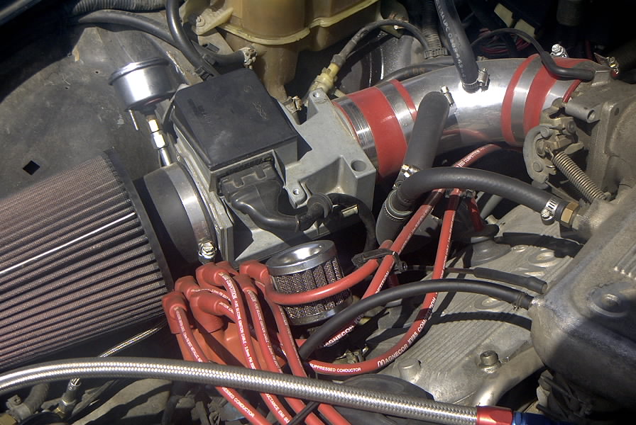

Here's how I did mine originally with the Vibrant intake tube. When I installed the MS, I just removed the AFM and put the filter directly on the end. The guy that had my setup now is doing the same thing on his Verde.
Just build yourself something like the picture below. Get rid of that restrictive stock plenum and runners.
