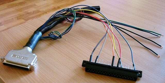

Hi Marcus, do you have any pics of your MS11 install? I have a MS11 v3 to install in my GTV6 3.0L but dont know where to start so any help would be greatfully accepted.

Post by mac74 »
Paul, It's not that much to see really, but I recommend you to slaughter an ljet-box to build the adaptor and also to get the db37-pigtail. As you can see there's still a few wires to be soldered. Hopefully I will just plug in the MS and start tuning soon ;)
Here goes:

Hi marcus, that was a quick reply, thanks. I have already got a gutted l-jet box ready to go, I just need to do the soldering. I have a schematic from Steve Rosser but I am no electrical wizard, I like to work from photo's as well as drawings. I also have a DB37 pigtail. I would like to make the transition form l-jet to MS11 as easy as possible.
