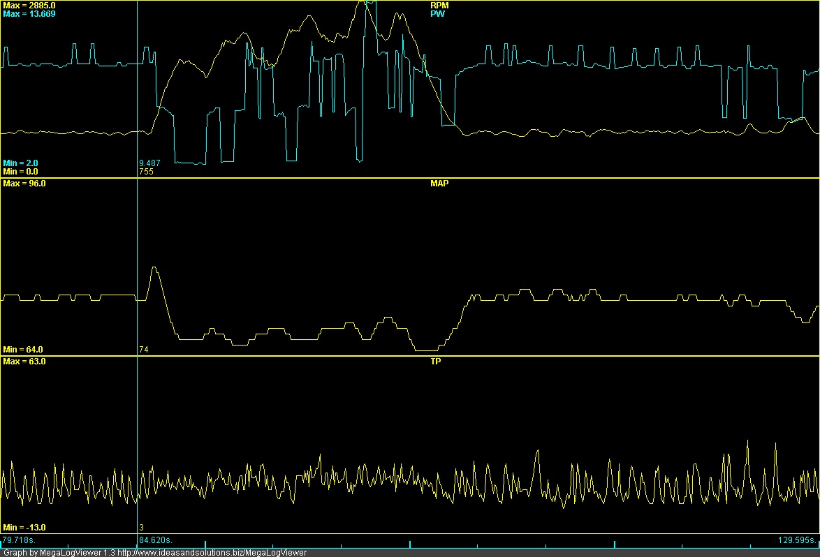

Steve thank you for the advice.I'll take it.I'm posting a pic.from my datalog which I ran this morning.I think one of the problems I've got is controller resets as the time value is all over the place.This is making me think that I better go straight to ignition control (It's a MS II V3.0 wired up for Hall input and direct coil control) because from what I've read my current coil negative input is probably bringing in lots of "noise".I presume by switching to Hall input I'll eliminate one issue.I wanted to go step by step -fuel then ignition but I don't want to start modifying my board just to deal will the coil negative problem and then have to change it back later.
Another strange issue I have is when I calibrate my TPS I get a closed throttle reading of 1009 and an open throttle reading of 1002 ? It's a brand new Bosch pot type.With a DMM resistance varies from2.2k ohms to 1.2k ohms.

>The rpm signal that the ECU is presenting seems to be reasonably stable.I think the "noise is coming in on the TPS line because at idle my log shows a flashing "accel"box.
Hi Murray,
Looking at the datalog their does seem to be tons of noise on the TPS, that would explain your accel light flickering - it shouldn't unless you deliberately prob the throttle. Also I don't understand how it can go negative - unless the TPS is moving about on it's mounting.
Suggest check the TPS mounting point then if OK swapping in some shielded cable for the TPS signal wire then re-calibrating it in MS. For shielded wire any coax will do temporarily, microphone cable, TV cable etc is fine to troubleshoot.
Also I'm concerned about your MAP reading as it never seems to go low. Hold the car at 3000rpm or higher and snap the throttle shut.... the MAP should dip at least momentarily nice and low as the engine slows, it might not be obvious on the laptop but you'll see it in your datalog. If you don't ever see lower than the 60's it shows now then check your MAP sensor works OK by appying a vacuum to it if you can.
Also can you post what acceleration enrichment settings are you using?
Steve

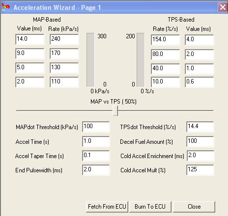

Steve here are images of my Acceleration and Warmup settings.

Ah OK, I reckon that might be it. Have you run the car since moving the MAP line from the cannister to the other plenum entry? That one change might well have done the trick as the charcol cannister will always have a flow of air through it (ie no solid vacuum) whereas the line to the FPR is effectively a dead end and therefore a source of consistant vacuum for the ECU.
Also I think the accel settings are bit too generous, this is an area where less is more. You are looking for the minimum accel enrichments that will give a responsive engine, too much fuel bogs down more than too little! Number one tuning trick is get a good idle first, so set your accel enrich to wholly MAP based, set the threshold to about 900kpa per sec, which should stop it intervening...
Cold start settings look OK btw.

I think I tracked the TPS noise problem down and I found it interesting.After reviewing the AR wiring diagrams I noticed that circuits numbered 2/1 & 3/1 run out of the TPS and into the evil EZ-L advance computer.I yanked these lines out of the ignition ECU connector and voila clean signal.Makes sense I guess because there are two shielded wires running into this thing -one from the Hall signal in the distributor and one out to the coil power module.
I've attached a piece my datalog just to prove I'm not making this up

Glad it works OK now, the datalog looks much better. TPS input is nice and clean & the pulsewidths are now nice and stable too, the MAP line obviously was the problem.
Your garage is unheated? I ask as the air temp sensor seems nailed to 70.0 (degrees f I presume) but if it's minus 20c then the sensor should say so. The log reads like the ECU is seeing a fixed resistance, so there's likely a minor wiring problem there too Murray, the wiring at the ECU interface is the most likely culprit. I reckon it's just the air temp sensor side that needs checking as the coolant readings are fine for a slowly warming motor.
