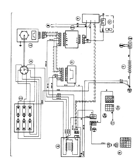

I'm looking forward to any discussion on using the existing alfa V6 distributor for spark control. Anything not to modify this crank pulley that I paid so much to get and then get balanced!
Thanks,
Bill
Bill,
Follow this link:
http://megasquirt.sourceforge.net/msns- ... -msns.html
You use the existing Hall sensor in the Milano distributor and the ignitor shown in the diagram. It replaces the CDI ignitor (amplified) under the coil. You can get one from a 164.
The CDI module is on the passenger kick panel. Take the hall output from it to the MS with the pullup and FIdle out to the ignitor through the same wire as the CDI uses.
Note that the tach in (24) to the MS (pin 1 on L-Jet) comes off the CDI to the L-Jet box. Take the Hall input from the CDI directly into 24 on the MS bypassing the L-Jet wiring, then run the CDI advance out to the FIdle on the MS (pin 30) to pin 6 on the Motronic ignitor.
See the Bosch wiring diagram below.
-Peter
