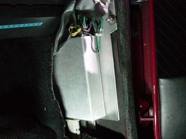

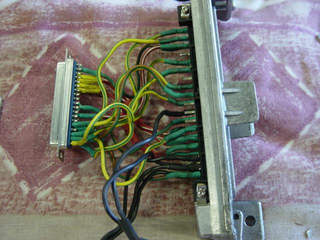

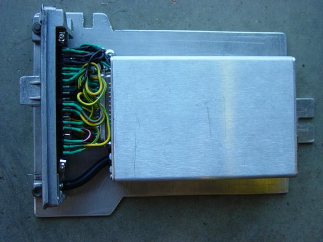

Very clean. Good idea to make a template for Bosch box for mounting. And you don't loose the DB37 for stim testing.
Nice work. I think I'll do the same. Right now the box is flopping around in the footwell.

Peter,
You need to make the plate longer at the top above the L-Jet box upper mounting hole to get it all to fit. I'll get the dimensions of my board and post then here. Also the backing plate ensures a good earth on everything.

Hey nice install David. Mine isn't nearly as nice, but I retained the Ljet header still bolter to that metal plate. In order to get the MS box to fit I have it sideways on the metal plate. I had to cut away the fiberglass housing where the old ljet box fit. I think I should be able to keep the serial port cable plugged into the MS box. I'll try to take pictures this weekend.
Bill in MD
