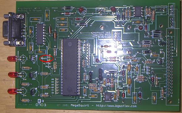

execute the download-firmware.bat and follow the instructions. you have to open your MS-case ;-) your are promted to power down your ms, install a boot jumper (see the pic where is located) you can use a small wire, no need to solder, just put in....then power up your MS...this operation shuld take less than 5 mins...

hmm, more weirdness...
When I short the two holes located in the square next to the word "boot" printed on the board I don't get a turn-on-blink from the LED and the .bat file complain about recieving "" instead of "boot>"...
Tried to do it without the jumper too but it doesn't make a difference, still have excellent communication through megatune.

Edit: When I open Megatune with the boot-jumper connected it says:
Expected "MSnS-extra format 024s *********"
Recieved "S - what???Boot>"
And a bunch of dire warnings...
Guess it means that the boot jumper works then. So why doesn't the .bat file work? :|
