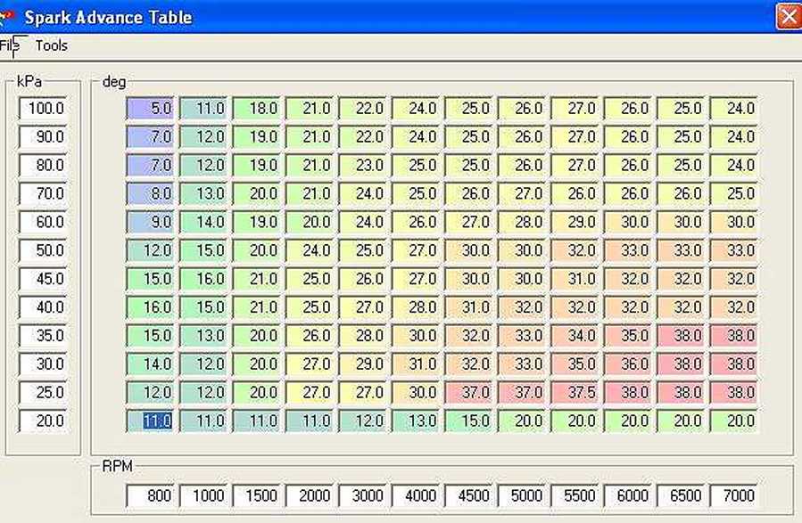

This weekend I'm going to take the last step in converting my 86 GTV6 2.5L over to Megasquirt II.I'm running S cams and have removed my AFM.I've created an ignition curve table by interpreting what others have done and said on this forum and would appreciate your advice before I move forward.I'll be "locking down" my Hall effect distributor and Megasquirt will fire my Bosch coil directly.

Thanks Barry.So by conservative you mean I'm missing out on some fun
I'm running "regular" low octane but you think I could push it up a bit ?

As Zman says,the ignition map is conservative..Im running 32 deg wot above 4300rpm.Push your 24 deg up to 28 to start off with...
The uppers and lowers are tolerances in deg. max and min.If you go for the stock settings you cannot go wrong....wrong.....wrong....hehe..

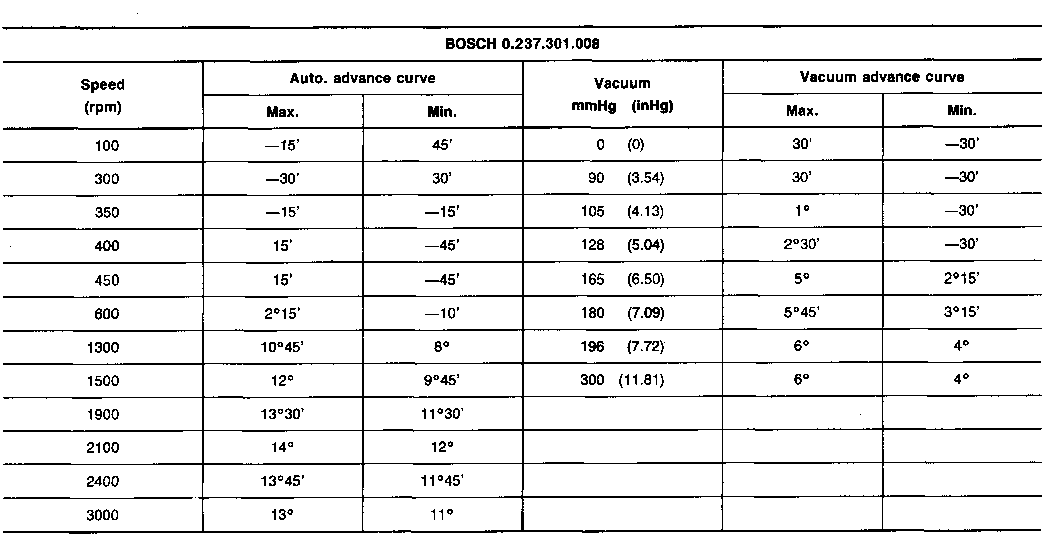

Just remeber that Alfa`s spec from Enzo is in dizzy speed..not crank speed..

Will do and should it be maintained at 28 all the way up to 7000 rpm ?As Zman says,the ignition map is conservative..Im running 32 deg wot above 4300rpm.Push your 24 deg up to 28 to start off with...
Ok so the distributor rpm =1/2 crank rpm.The uppers and lowers are tolerances in deg. max and min.If you go for the stock settings you cannot go wrong....wrong.....wrong....hehe..
why the +%/! do the tables start at 100rpm =200 crank rpm ?
and how could a tolerance of ( upper -15 deg. - lower 45 deg.) work ?

Id leave things at a conservative 28deg for now..If you want,drive on the road or dyno and push timing up for max krag..(power)

So referring to the AR table they give electronic ignition advance values ranging from 0deg. (for simplicities sake forget the 1/60 th of a degree) @ 200 rpm (engine rpm.) up to 12 deg. (once again simplified) @ 6000 rpm. So how do we get from there to 28 deg?
Then we have the vacuum advance/retard tables which I assume are overlayed on the electronic values ?These range from 0 -300 mmHg (0 - 50kpa) but what determines if the values in the table are added or subtracted from the electronic values.I understand that increasing values of vacuum advance the timing but what condition retards it ?

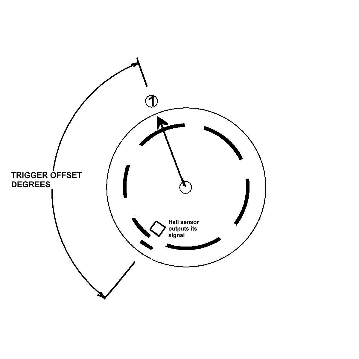

So referring to my rudimentary drawing do I have the concept of ignition offset right ?

The trigger for MS can be any number from (I think) zero to 90 crank degrees before TDC. But bear in mind the dizzy rotates at 1/2 engine speed, then your drawing would be to far advanced. The drawing definately shows it going the correct way, but too far.
The sensor in the dizzy has 6 triggers which are each 120 crank degrees apart, you want the trigger to occour roughtly half way BEFORE cyl number 1. This doesn't have to be exact as the car will start and run (badly!) with the ignition 25+ degrees off and you can alter the MS settings on the fly to dial in the exact number. For example my ignition trigger is something like 78 degrees BTDC.

Also agree with Barry, very conservative WOT settings, but you've quite agressive settings right off idle, so it will probably respond well from idle, but then feel noticeably flat higher up. But that's OK, it's definately the safe way to do it.

Ok so because the dizzy is spinning at 1/2 crank speed the actual 60 deg between windows becomes 120 deg.Gotcha.
The illustration above shows pretty well the relationship between the Hall sensor and the no.1 cylinder mark - I estimate 135 deg.
I have a Hall "window" that comes into the sensor field when the rotor is about 15 deg.before the no.1 mark so if that is my signal to ignite shouldn't that work ?

Murray,If I remember correctly here,the std. Alfa hall sensor setup triggers as the trailing edge comes through the gap.So when the edge is in the middle, it will trigger..Check it out by holding the coil wire in the left hand ...joking...but do check when it fires or triggers..Theres a lot of degrees in them thar windows.....
Can MS be programmed for a falling trigger edge,or a rising trigger edge??Always go for a falling edge if possible..

Yes the distributor appears to send its signal as the open "window"approaches the sensor,as you said about half of the vane still in the sensor.
MS can be set for either leading or falling edge so I'll take your advice.
