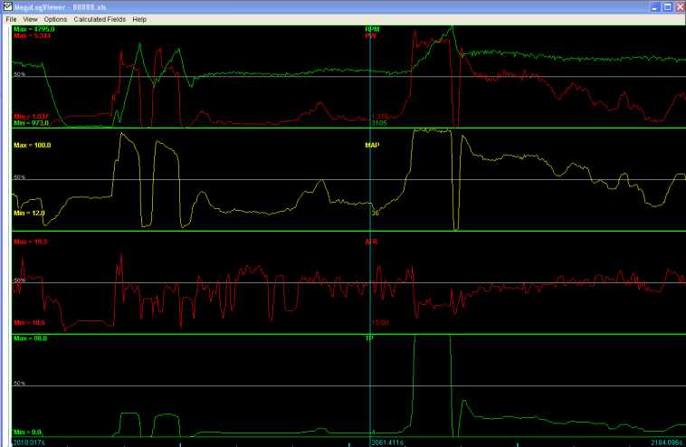

I have run about 3200km.(2000miles) and one track day on my MS so I feel confident posting this .msq file
I would point out that in order to get a smooth idle at 950rpm I have to run very rich mixture approx.12.3:1 to achieve an idle MAP of 40 so don't be surprised if yours is the same.
I recently completed a 1200km (600mile) trip through mountainous terrain and averaged 30 mpg.I have definately gained some power (guess about 5-10 hp.) and will dyno my car this summer.I have pre-MS dyno data so should be interesting.
I've kept the stock Bosch ignition for now but as soon as I have a gap between track events I will switch over to MSII ignition control.I'll update once this is done.
Here is my .msq file and a screen-shot of a datalog (right click and "save as" if you want to see it,for those who would like to see what they should look like.
