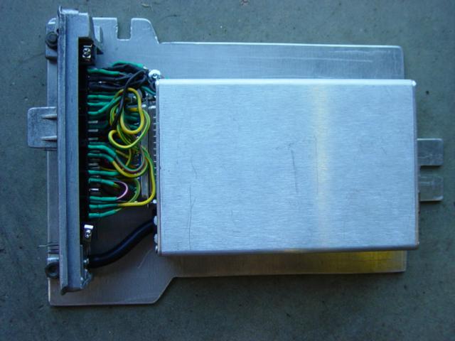

Kevin based on your description I guess your planning on installing the MS board directly inside the old L-Jet case as Steve R did in his wrte-up ?
I had the same concerns about the DB37 and decided to build mine slightly differently.Attached is an image I borrowed from somebody on this site (sorry can't remember who to give the credit to ) I decided that having the DB37 permanently available for hooking up to the stim was important and in hindsight it was the right decision.All I have to do is unscrew the MS case from its mounting plate and unplug the DB37 and I can bring my MS into the house for testing on the stim.This can be an important advantage as you progress towards getting you car running well.The other alternative is to get a spare L-Jet "male" connector and wire it up to the stim if you want to become really familiar with the wiring diagrams !

Kevin, I approached this whole project with the same concerns as you (being able to swap back the L-jet if necessary),In 2 years use I've never had to do that.In fact last summer I decided to plug the L-jet back in to compare and I was surprised how "dead" the response was compared to MS.
You can keep all your existing wiring intact and simply run parallel circuits for the ones that are unique to MS.For the hall-effect pickup this is really easy to do if you have a spare 3 pin plug (the one that takes the signal from the distributor).
