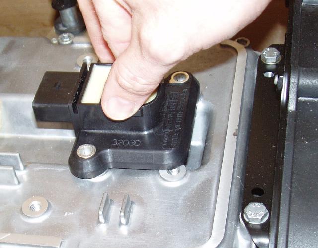

The standard Alfa 164LS Bosch COP units cost at least $100 each so I am wondering if I can find an alternative to use on my 164LS engine, fitted with Megasquirt-II PCB V3.57 running MS2/Extra firmware.
Here is a pic I found on AlfaBB http://www.alfabb.com/bb/forums/164-168 ... s-24v.html
These coil packs are used on various VW engines (root part number is 06b905115) and cost $30. So I want something similar, but without the onboard driver/ignitor (I just want to use the 'dumb' coil packs). This is because my Megasquirt has been set up with Bosch BIP373 Coil Drivers specifically for coil packs without an onboard driver.
Any ideas?

Are they a dumb coil? or do they have an ignitor built in?

06B 905 115 COPs have a built in ignitor - check this out:
http://www.msextra.com/doc/ms2extra/MS2 ... nition.htm
Search for '06B'.
When I move to MS3, I will go this route for sure.
