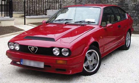

So here she's. Bought her 2 months ago or so, in Germany, it's '85 GTV6 Zender edition, as you can see the car requires restoriation, which hopefully will commence in summer. Couldn't expect more for the price, but the car lacks some decals -look at scudetto :( and has to have the job done on suspension and engine. Anyway it's GTV6 and I could't think of better car for me. The original color was rosso alfa but, previous owner repainted her into this green "british racing green wannabe" metallic.
And they say that only American cars have the license for engines sticking out of the hood :wink:

very nice ,i like it a lot,i alway's wanted a gtv6 in deep metallic green (and gold mags) :D .
i love the last 2 shot's 8)
