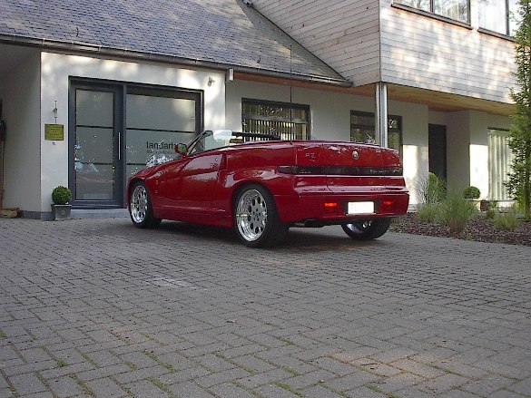

I advise you to think about the wheels carefully. The GTV6 goes well with a nice 5-spoke, or SZ wheels. I would personally source a set of SZ wheels. They would make the car look fantastic.
rz
Posts: 390
Location: belgium
Post by rz »
but then not the original 16",but the 18" woooooooooooooooowwwwww

rz wrote:but then not the original 16",but the 18" woooooooooooooooowwwwww
Marc, what was the cost of your wheels?
rz
Posts: 390
Location: belgium
Post by rz »
i think it was 3000 euro without tires :(
