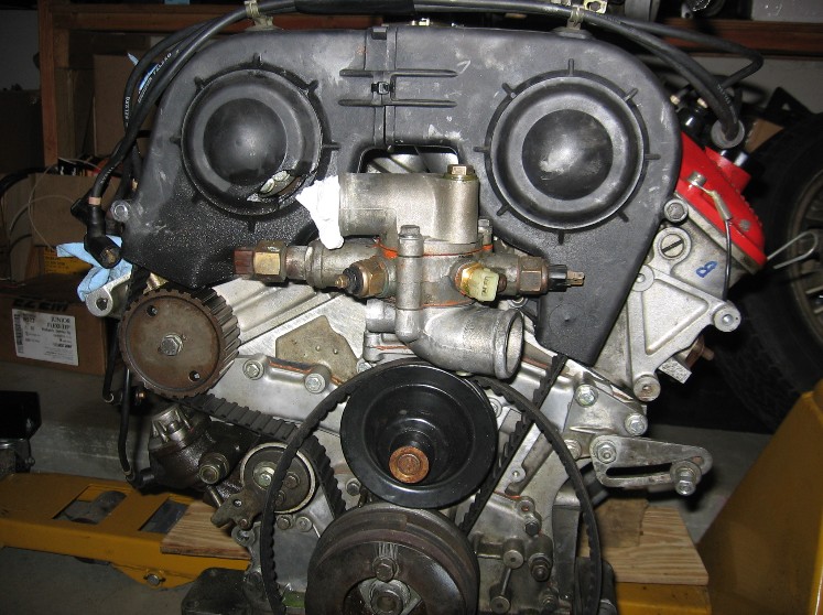

Its one thing to start a project but its another to complete it. There are a lot of cars that never get finished so well done. The best thing about the hood lining it stops the leaking water coming through the plastic piece on the hood if its not siliconed down properly, during a storm or washing the car. These 24v motors hate water and will just misfire when slighly wet.
I dont run timing covers on two of my 24v motors (lost them)but I have seen it happen at the track where a small stone got in when the chap went farming and the belts jumped ending in tears. I use fly screen mesh under mine and hope nothing happens.
I cut the bottom of the covers off just below the middle bolt. Lets U work on the tensioner without having to remove the whole cover. Top part I keep in place to run the wires across.
Putting a screen on the bottom is a great idea. They sell stainless mesh at:
http://www.twpinc.com/twpinc/control/pr ... S_Elec_1_2
I was going to fashion a front grill from this stuff and replace the black plastic.
82 GTV6 Restoration/Modification
Hi X-rad,
Do you think you could post a picture of how you did your bottom. We will be welding the brace to strengthen the front swaybar shortly. Therefore, maybe we will do this then as well. I have a new timing belt cover and just need to install it. I forgot to bring it with us when we were with Phil or it would already be done.
Screen is off at the moment. It was just tack welded to an IAP oil pan protector. This was heavy so I took it off and can't find it right now. The oil pan protector mounts with four bolt to bottom of chassis. You can probably just use a couple of flat clamps and sheet metal screws and mout the screen to the chassis bottom after your welding is done. Easy job.
here is a pic of the covers. They are not 100% protection by any means, but i think better than nothing, and a plce to run wires safely.
There are many used cracked covers which are mostly damaged down low. These can be reused.
- I think I cut the set on the new engine slightly lower than these to give a little more protection...
