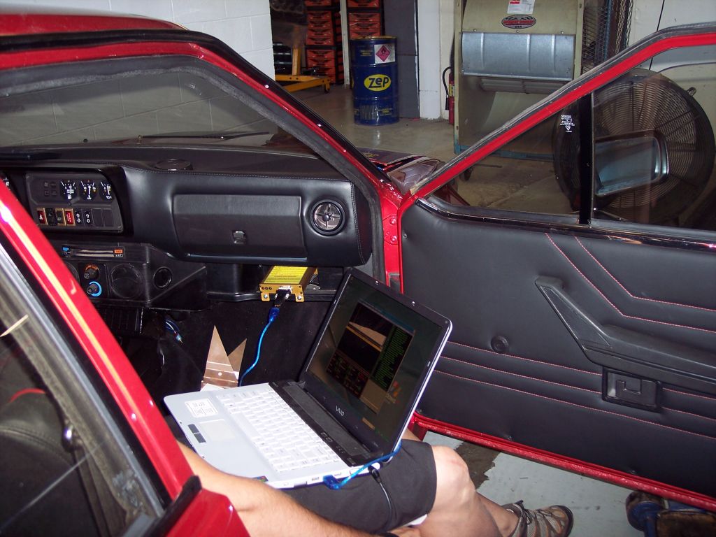

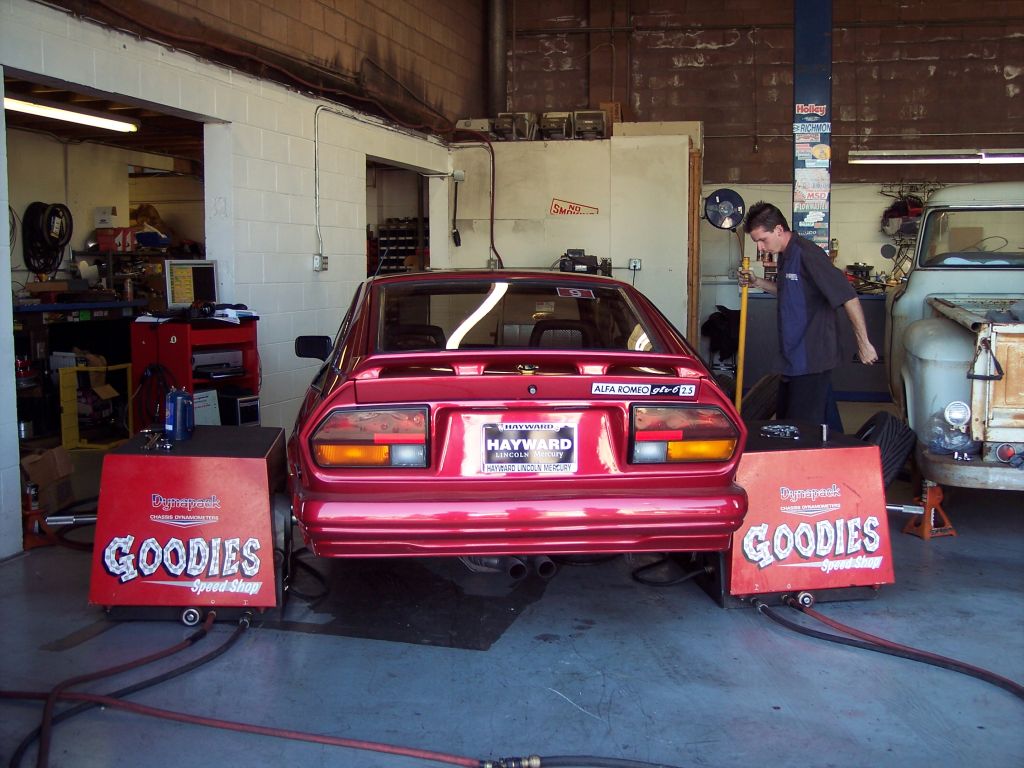

We met with Paul who owns the dyno tune machine with Phil and his son, Jordon to complete the dyno tuning.
After about 3 hours including hook up to dyno along with a minor tune issue (water in one of the plugs), we were able to complete the tune. We did not go for max power since this is a street car and Phil suggested along with others on this site to tune it alittle lower for safety and more reliabilty. We were able to get the paperwork to show 211 hp at the wheels which is more likely around 204 hp at the wheels.
We are happy with the result and will now be completing the final electrical issues, etc. Here are some pictures of the dyno tune.

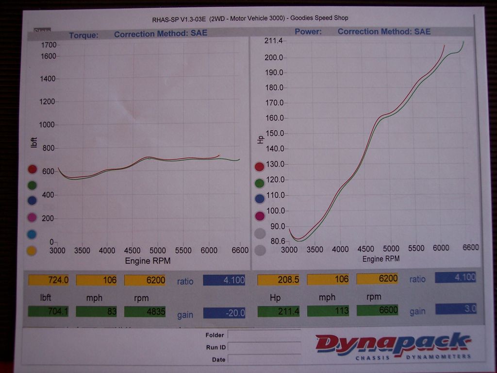

Here is the print out of the HP that I recevied from Pauls' shop. It is a far cry from the 400hp that we originally wanted. However, we are happy with the Alfas' performance.
I can now say that we actually finished this project and all my parts did not end up on ebay.
Hopefully, now I can have fun driving the Alfa around and fine tune the suspension, brakes, and any additional issues that I am sure will pop up.

Those torque figures are crazy!
Nice power curve though. Still looks good on the back of a truck!

Remember Rookie, there's a gearbox & diff multiplying that torque.
Great power there Chuck - wish I could get mine to that stage.

Hi Rookie Rox,
The torque on this graph is high indeed and I originally thought is was an error on tagging the correct file. However another Alfa Fan told me the following:
"Awesome car. On your dino graph I think the torque is the actual torque measured at the wheels whick is 4.1 times the torque at the crank due to the gear ratio.
HP=torque*rpm/5252.
So at 6200rpm the crank torque is 176.5 ft.lb and if you plug this into the equation you get the displayed 208.5 hp.
Jeff"
I think that the above quote makes sense and hopefully everyone agrees with this. Please let me know if this is correct.
Thank you for looking at my project.
HP=torque*rpm/5252.
Jeff"
Re: Introduction
There is no 1:1 ratio in the speedgears so probably fourth gear is used, 0.946 (?) which must be added too.

Yes you're correct, I missed the photo on it on the dyno and just saw the other flattering shots and the readoutcchan wrote:Hi Rookie Rox,
<snip>
