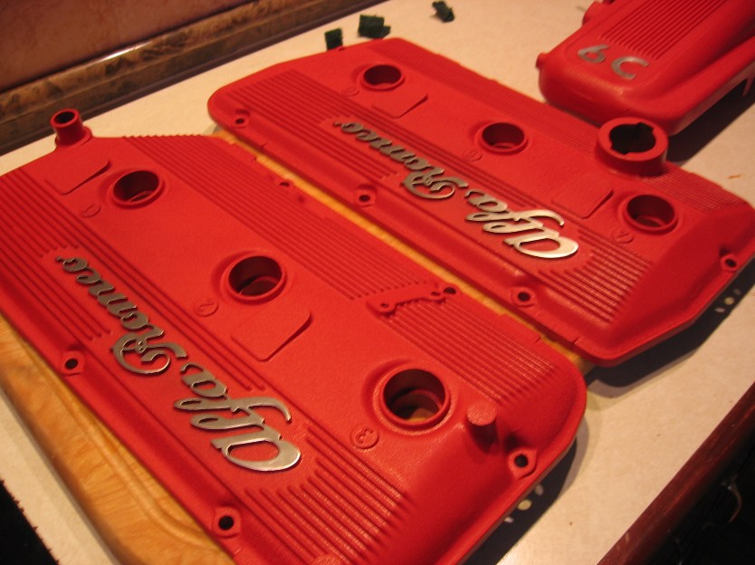

And with the above recommendations...Thanks Mats!
looking gooooood
wife is looking for her pot scrubber....it's in three pieces...oops :P
Re: xrad's gtv6
Looks fantastic. Well done!
Difficult to get the wrinkles that uniform, I'm impresed.
xrad
Posts: 516
Location: Canton, Ohio
Re: xrad's gtv6
Post by xrad »
Thanks. Three coats in different directions 10 min apart. When I look closely at the wrinkles, they are EXTREMELY uniform...it's almost weird how they line up...even on a pretty rough cast surface
VHT has had good reviews. I would use it again..
Re: xrad's gtv6
xrad wrote:Thanks. Three coats in different directions 10 min apart. When I look closely at the wrinkles, they are EXTREMELY uniform...it's almost weird how they line up...even on a pretty rough cast surface
The trick is to get uniform thickness, as soon as you get a "puddle" or even just thicker paint in a crease it will give you a larger/sharper wrinkle.
There are two problems with the VHT paint, the smell and the way the valve seems to stick pretty often. Other then that I like it.
Re: xrad's gtv6
If you want to keep the shine on the lettering and the colour of your paint, spray some coats of clear over the lot before installation.
xrad
Posts: 516
Re: xrad's gtv6
Post by xrad »
yes and yes!
VHT valve sticks about every thirty seconds :twisted: but does not stick if you shake the can every 15 seconds. When it clogged, I rinse it in mineral spirits...
I just put a little wax on the polished metal..

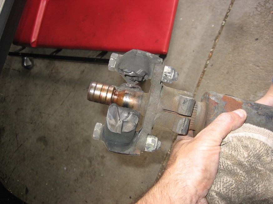

PO put in a new exhaust. Center section welded to front so had to torch it off to get out driveshaft.....pure laziness, no joints. Rear section welded all crooked and hitting brake bleeder and battery box...nice stuff there.
Front guibo mascerated. looks like it's been this way for a while..
Question: Front driveshaft bushing worn and now forward of normal position by 3mm or so. Slightly loose. Will this affect the shaft motion with a new guibo installed???
It was actually pretty smooth once above 2500 rpms!!
xrad
Posts: 516
Re: xrad's gtv6
Post by xrad »
Anyone have a response to above?
Re: xrad's gtv6
What is the question really? If it will make noise and vibrate? Probably.
Change the bushing?
ar4me
Location: Southern California
Re: xrad's gtv6
Post by ar4me »
Is it worn or just full of old dried up grease mixed with rust? Disassemble, clean, lube, reassemble, and see if it returns to normal or if there is permanent damage...
Re: xrad's gtv6
I had the same problem, but with the back bearings of the drive shaft. It will vibrate and cause a clanging noise if driven in the current state after a while. My mechanic replaced it with a used one as the one I had was too wobbly.
xrad
Posts: 516
Re: xrad's gtv6
Post by xrad »
Would be nice to change, but the shaft that retains the bushing is grooved from the rear edge of the bushing rubbing on it......
Will search for a replacement...
anyone have a good spare front driveshaft section?
Re: xrad's gtv6
Z , back is different in terms of tollerences to the front so the worn front has never been an issue for me. The front swivels while back is more fixed. Just regrease and put back . Worst case chainge it later , two our job.
