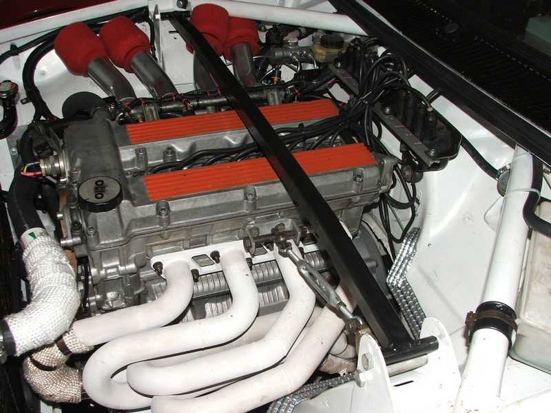

Mats, here is one way on the Cab.
- Copy of 20 Engine exhaust side.jpg (67.3 KiB) Viewed 6976 times
