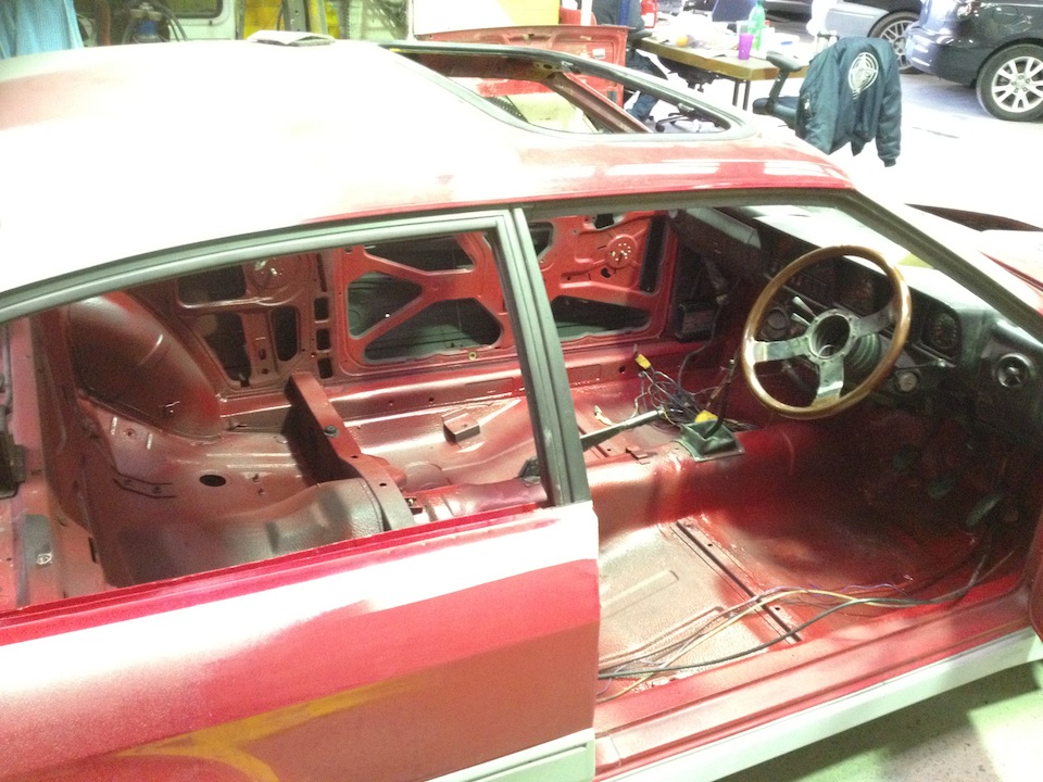

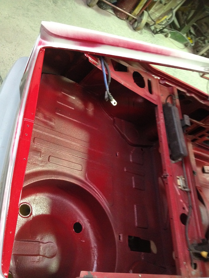

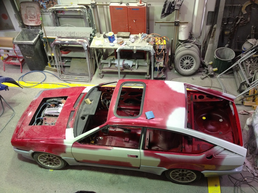

Ok here are the pics-
About Lizard Skin, first:
This stuff is awesome!
The panel beaters had a bit of doubt initially.
I put them onto the Australian distributors of this stuff for direction on what to do, and I'm happy with the results, given the limitations of the job- I still had all the lines running through the car, but all sound deadening was chipped away. They painted around/under all the lines.
In my personal opinion, this isn't the best way to paint a car- it should be stripped, bare metalled, holes welded up, prepped, primed, painted, put back together.
I had no desire to do this to the GTV6. I just want a functional and clean car and while I am spending a bit, I want to keep the spending under control- anyone can throw money at a car for a desired result. I don't want to!
I digress;
In their scepticism, they painted a scrap of sheet metal, half with the heat insulation ceramic paint, half bare. Lo and behold, when heated with a paint stripping gun, you simply can't touch the bare metal.
But you can lay your palm flat on the lizard skin. Yes it's warm, but in no way is it hot to touch!
My thanks to La Strega Nera for his insight into this stuff-
The proof will be in the pudding when I weigh the car for registration.
I'm hoping for under 1100kgs in full street trim- removing the booster cross over bar and running a dual cylinder brake setup will certainly help this, too.
The Lizard skin was painted with a light dusting of the chosen colour, to stop the paint from cracking (it's ceramic and flexes slightly).
The Zender bumper received some new fibreglassing around the front guard to help clear the tyre at full lock.
Kit is being removed and doors to follow shortly, for painting in the next couple of weeks....

by the way, you can get an idea of the actual colour by checking out the upper surface of the rear beaver panel-

Great pics - love that shot from above, even without a hood and hatch these cars have such a great look! GV
