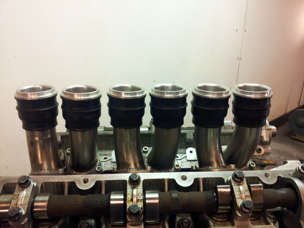

Are the intake runners by Beninca?

No, my mechanic made them himself

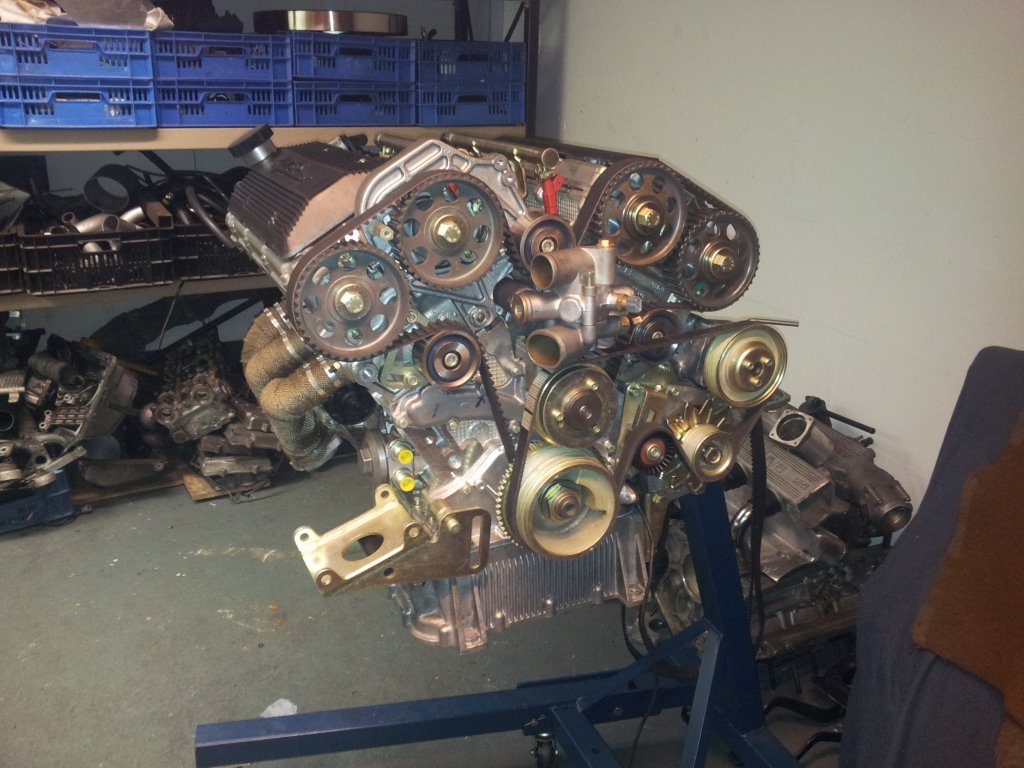

Well , I think you have won the award of the prettiest centre plenum 24v conversion . :D Have You got any more pics of the pick up sensor on pulley and alternator attachment . Always good to see how others do it . ( and steal ideas 8)

you can see how the runners fit the inlet

Hey, what kind of belt tensioner is that?! That isn't a 156 or a 164 one!!! Interesting! Is it a fixed tensioner? Looks like you took the spring assembly off a 156 unit and made it fixed.

i don't know what tensioner it is? it is a new 156 or 147 engine.

It's a 147 style, but where is the spring? Looks like this is a modified 147 style but it doesn't allow for movement. It's a fixed style tensioner.
Kevin? JK? Bazza?
