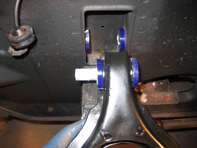

82 Alfa GTV6 Restore

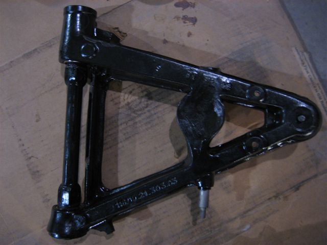

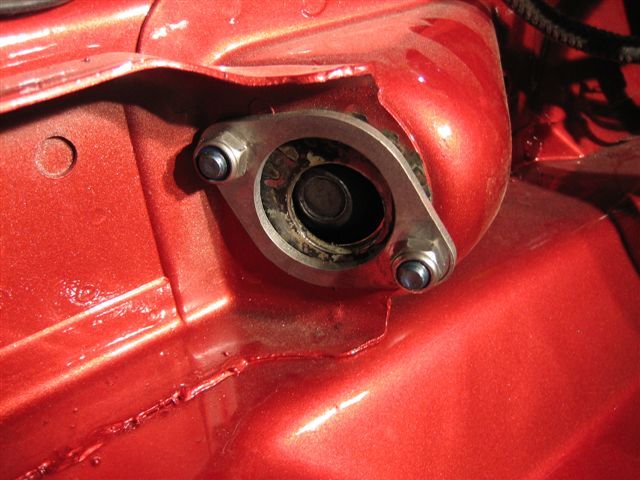

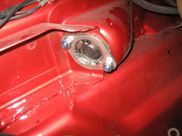

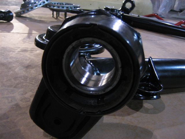

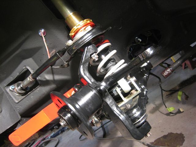

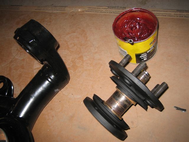

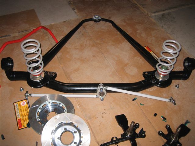

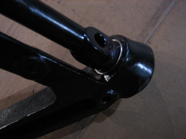

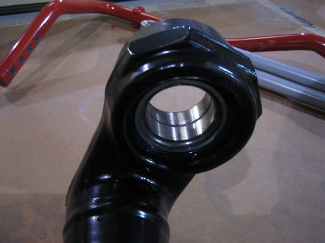

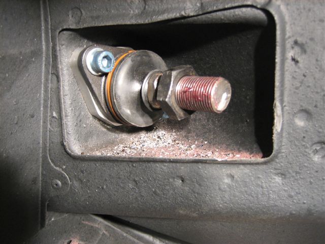

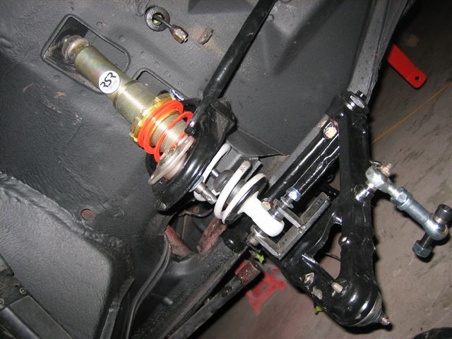

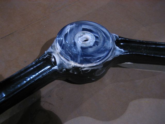

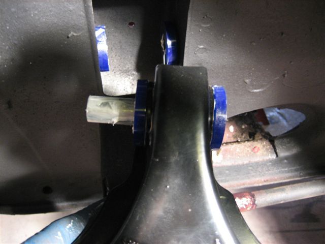

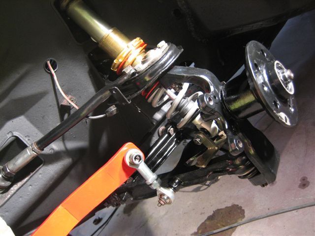

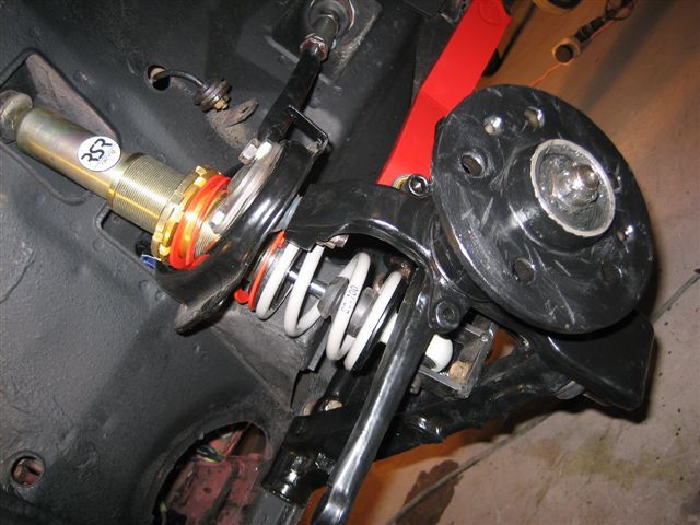

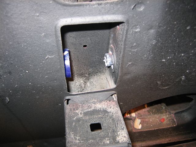

The suspension took longer that we expected but there were alot of small details especially putting back the bushings & bearings. This was very time consuming and not really that much fun. IMO. We had to press out the old bolts from my old rotors and put it in my new rotors. We also changed the castor rod to a ball joint. This was not that hard but took alot of time and careful measurement. We were able to accomplish everything but I was happy that I was not doing this on my own. Here are the pictures of the front suspenion progress.
- Alfa Front Suspension #5.jpg (53.34 KiB) Viewed 8801 times
- Alfa Front Suspension #4.jpg (59.59 KiB) Viewed 8803 times
- Alfa Front Suspension #3.jpg (53.56 KiB) Viewed 8802 times
- Alfa Front Suspension #2.jpg (41.31 KiB) Viewed 8801 times
- Alfa Front Suspension #1.jpg (62.05 KiB) Viewed 8803 times

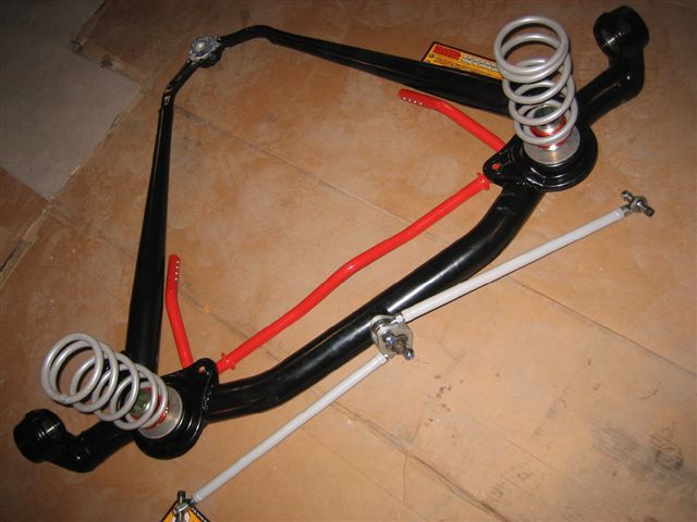

82 GTV6 Restore
Once we did the Bushings, etc. My hobby stating getting funner since I was able to put on my new parts and see them on my Alfa. I can really say my Alfa is lucky that it was not trashed.
- Alfa Front Suspension #10.jpg (56.95 KiB) Viewed 8798 times
- Alfa Front Suspension #9.jpg (59.58 KiB) Viewed 8799 times
- Alfa Front Suspension #8.jpg (57.52 KiB) Viewed 8798 times
- Alfa Front Suspension #7.jpg (31.95 KiB) Viewed 8799 times
- Alfa Front Suspension #6.jpg (42.61 KiB) Viewed 8800 times

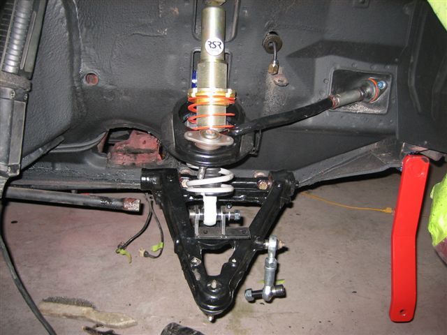

More Pictures
- Alfa Front Suspension #15.jpg (59.66 KiB) Viewed 8798 times
- Alfa Front Suspension #14.jpg (63.37 KiB) Viewed 8798 times
- Alfa Front Suspension #13.jpg (64.11 KiB) Viewed 8798 times
- Alfa Front Suspension #12.jpg (64.11 KiB) Viewed 8799 times
- Alfa Front Suspension #11.jpg (56.9 KiB) Viewed 8797 times

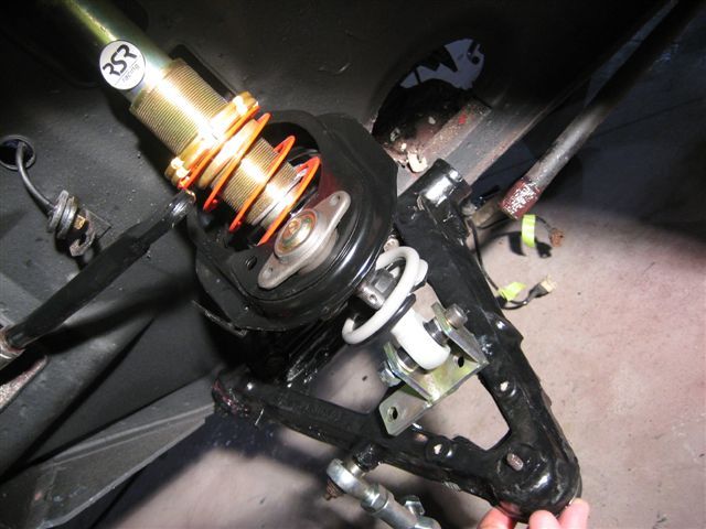

More Pictures
- Alfa Front Suspension #18.jpg (56.9 KiB) Viewed 8799 times
- Alfa Front Suspension #17.jpg (56.95 KiB) Viewed 8799 times
- Alfa Front Suspension #16.jpg (57.56 KiB) Viewed 8797 times

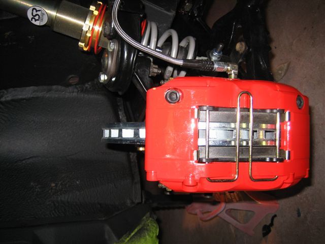

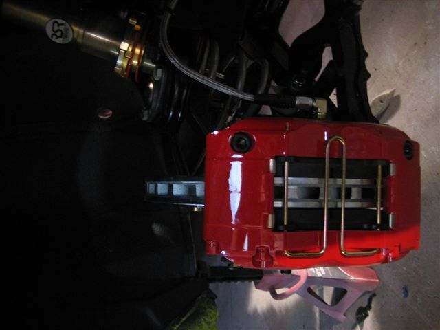

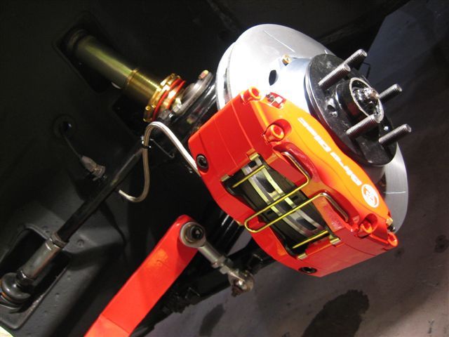

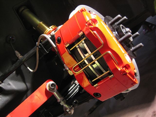

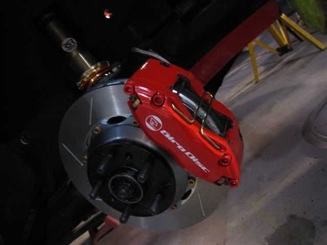

82 GTV6 Restore

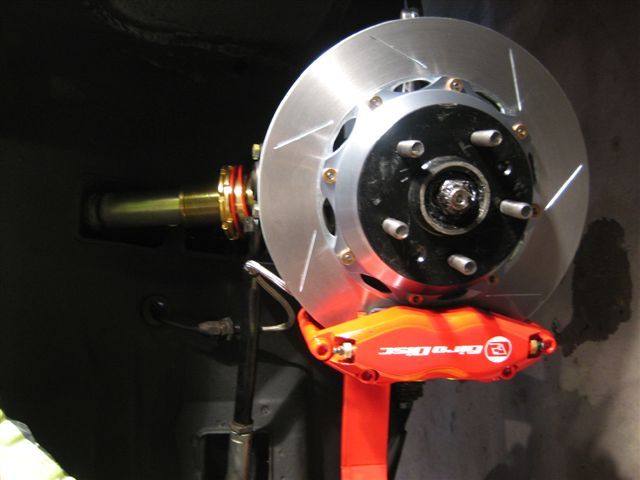

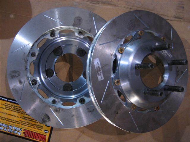

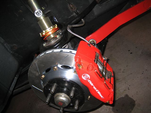

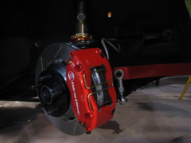

Once the Front Suspension was set up we put on the front brakes. I like the RS Brakes and it is so easy to change the pads. Here are the pictures of the brakes being done.
- Alfa New Front Brakes #5.jpg (33.07 KiB) Viewed 8797 times
- Alfa New Front Brakes #4.jpg (37 KiB) Viewed 8795 times
- Alfa New Front Brakes #3.jpg (56.68 KiB) Viewed 8796 times
- Alfa New Front Brakes #2.jpg (38.31 KiB) Viewed 8796 times
- Alfa New Front Brakes #1.jpg (49.96 KiB) Viewed 8797 times
More Pictures
- Alfa New Front Brakes #7.jpg (50.73 KiB) Viewed 8795 times
- Alfa New Front Brakes #6.jpg (36.12 KiB) Viewed 8793 times

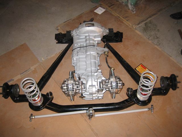

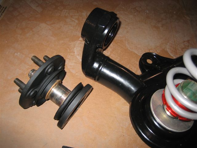

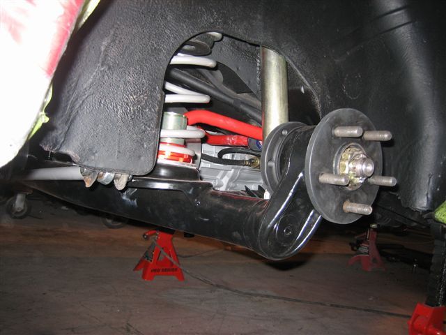

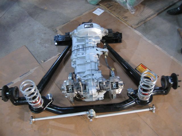

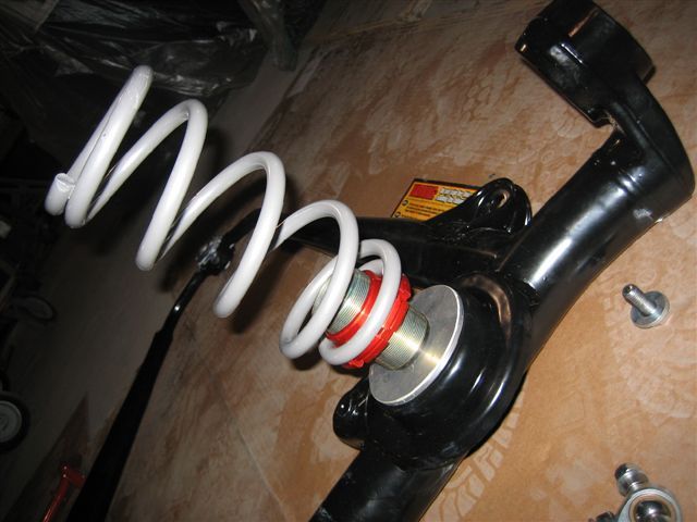

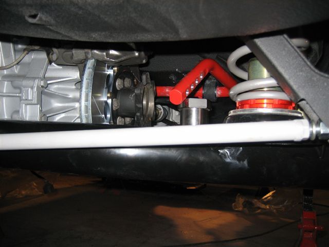

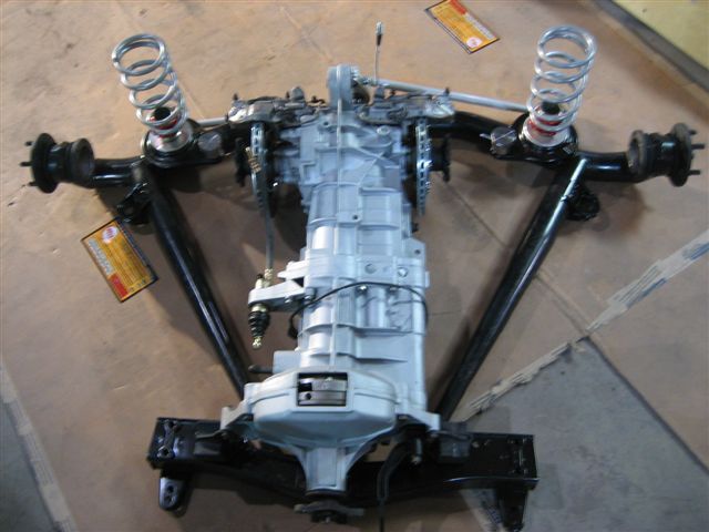

We then worked on putting the Di Dion together along with the rear suspension. This was not too hard except to put it back in the car. It was very heavy and since we did not have a lift it made it even more exciting. I think that this part of the Alfa looks the best especially with everything clean and new. Here are picture of the status
- Alfa New Di Dion #5.jpg (42.29 KiB) Viewed 8789 times
- Alfa New Di Dion #4.jpg (51.6 KiB) Viewed 8790 times
- Alfa New Di Dion #3.jpg (54.08 KiB) Viewed 8791 times
- Alfa New Di Dion #2.jpg (54.98 KiB) Viewed 8794 times
- Alfa New Di Dion #1.jpg (44.16 KiB) Viewed 8791 times

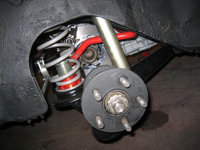

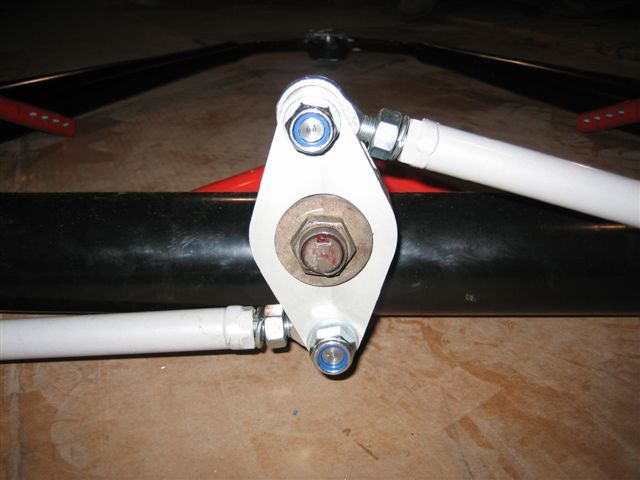

82 GTV6 Retore

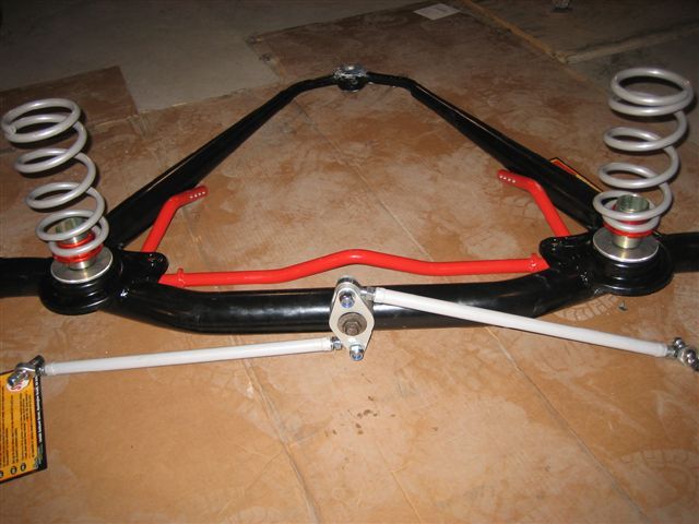

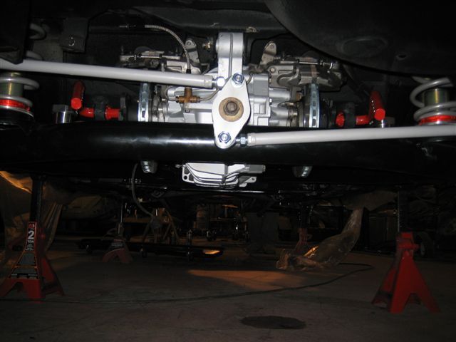

Here are some pictures of the rear suspension, etc before we put the di dion in to the Alfa.
- Alfa Rear Suspension #4.jpg (38.91 KiB) Viewed 8790 times
- Alfa Rear Suspension #3.jpg (38.37 KiB) Viewed 8789 times
- Alfa Rear Suspension #2.jpg (51.67 KiB) Viewed 8789 times
- Alfa Rear Suspension #1.jpg (60 KiB) Viewed 8789 times

More Rear Suspension Pictures
- Alfa Rear Suspension #9.jpg (51.51 KiB) Viewed 8789 times
- Alfa Rear Suspension #8.jpg (41.09 KiB) Viewed 8788 times
- Alfa Rear Suspension #7.jpg (52.93 KiB) Viewed 8787 times
- Alfa Rear Suspension #6.jpg (49.83 KiB) Viewed 8788 times
- Alfa Rear Suspension #5.jpg (45.79 KiB) Viewed 8790 times
So we were able to complete the rear suspension and were good to go. Just need to put on the rear wheels & tires.

Small things that still need to be done before that, alignment, drive-shaft and rear anti-roll bar final assembly, brake-bleed etc, but for the most part - the bottom is done and now the engine, GoTech and the exhaust setup comes next!
Brian - FYI; the brakes are full floating all of the way around! The rears are NOT simple old cast SZ rotors - these are zinc-dipped specialty, custom rotors that mount with floating hardware to aluminium hats! About the only thing that they share in common with the SZ rears are that they are vented...
In addition to being full floating and much lighter, the aluminium hats ensure a great deal less heat-transfer on to the hubs and in to the gearbox! The reconditioned calipers are GUTTED! They run brand new pistons, seals, o-rings etc etc and yes - the spacers to accommodate the thicker vented rotors!
The front Group 2/GiroDisc setup also runs brand new 4-pot Wilwood ultra lights (supper-super light-weight aluminium calipers!) The front rotors are 280mm - also zinc-dipped, also full-floating, also with aluminium hats - light, looks awesome, anodized - won't rust and keeps the heat out of that wheel-bearing!
Various Wilwood street/track pads available for the front and Ferodos for the rear... Custom aluminium mounting brackets for the fronts - all hardware included and three brand new stainless steel braided lines to round it all off! (Joe English told me that you guys talked - are you guys going for it?) I run them on my street/track Verde - I love 'em!
We are developing a larger meaner AP-based 6-pot front/4-pot outboard rear setup for the two 3.7 litre race cars based on the same principles but as an all-new total-engineered system with resized dual master cylinders and 330mm discs! The existing setup for aggressive street/track is the way to go! The quality is unreal!

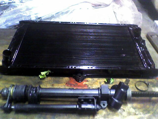

I think everyone is at Willow Springs this weekend. I wish I was able to go and see the races. I am at a pause today. My work project has been extended to the 1/17/06 so I took some time for my Alfa. Joe ( the interior person) stopped by and picked up my front seats & rear seats along with the rear interior parts last week. I will be stopping by asap to give him the front door panels, center console, and other misc items to be restored. I just need to pick out the final leather sample. I will also be picking the headliner material and new carpet. I picked up my rebuilt radiator. The radiator is in good condition and I did not realize that my Alfa has only have around 8 lbs of pressure in its' system. Seems low to me but that was what I was told. We cleaned up the steering rack. Unfortunatly, the steering rack rubber boots are no where to be found. Therefore, I will be shipping this to Andrew for his rebuilding since he has similar after market rubber boots. Since this is a street car I have decided not to change it for a better steering ratio that could be used for the track. Here is a picture of the new radiator and my steering rack. I will post some before and after pictures of the interior as soon as I get my new digital camera.
