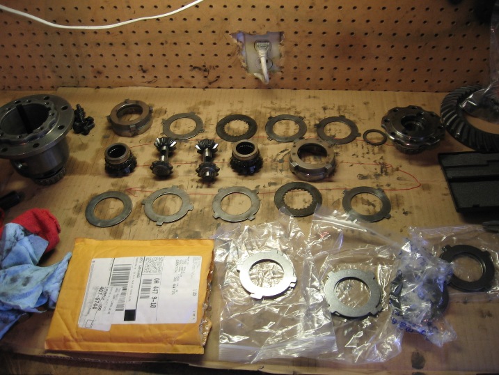

rebuilt my spare LSD today. Yes, I had the ring gear welded and machined....but it's the back up one...
LSD had 3 shims and one friction disc on one side , and 4 shims and one friction disc on the other side.
I had 6 new shims of 3 thicknesses. doing some easy math, I maintained the pack thickness on each side and replaced 5 shims and 2 friction discs.
bearings look like new..NO scoring, grooves or wear spots..
Next is to replace the sliders and sinchros and RR dogs. I have to pull apart a broken transaxle for some spares anyway...
