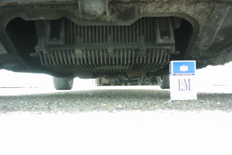

The lowest part of mine is the oil sump, and that is 84 mm. (The King Size box minus 3.
65mm from ground to exhaust is remarkable anyway.
But in my case it's not managable.
- Ground.jpg (49.96 KiB) Viewed 10141 times

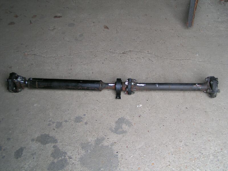

- Two weeks before I completely renewed the driveshaft; felx joints, center support, bearing.
- driveshaft.jpg (70.42 KiB) Viewed 9828 times

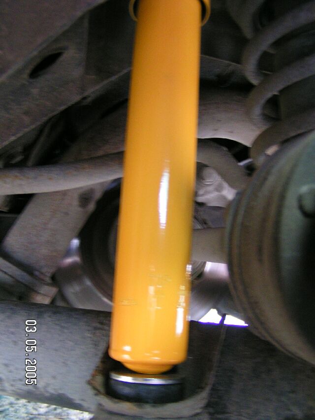

- Yellow Konis all around.
- koni2.jpg (61.75 KiB) Viewed 9825 times

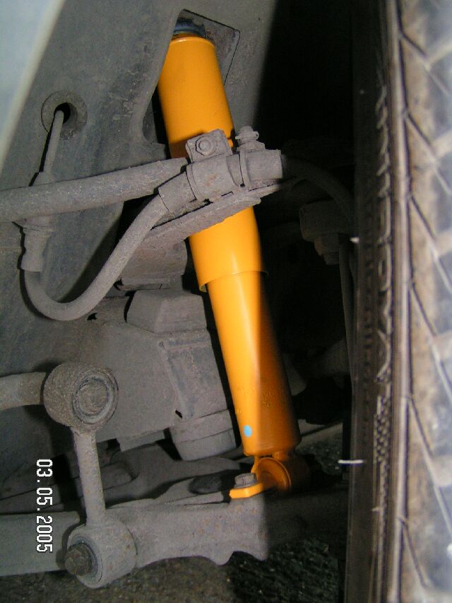

- Yellow Konis at the front. There's no picture about it, but the front sway bar was also replaced by a stiffer one from a Milano. Here the original unit can be seen.
- koni1.jpg (75.45 KiB) Viewed 9825 times

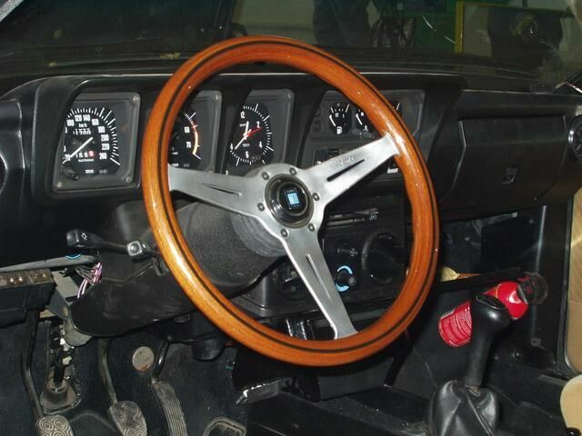

And the Nardi of course was installed.
- The Nardi was installed, with an almost custom fabricated hub. This is a modified RAID GTV hub extended with a Nardi 155 hub to get the right driving position and comfort.
- nardi.jpg (49.24 KiB) Viewed 9821 times

Thanks Guys for the reply.
I use my car in normal circumstances, it has never been on the track. Maybe sometimes...
The KONI's are set to factory setting, so at the softest level.
I used to have problems with nodding the front at braking and on bad road surface. This was because of lowering and the 'heavy' V6, I think, because the factory shocks were in good condition.
And I also did have problems with body roll and oversteer ( I used to have LSD already inside). I don't know why, but it often lost grip in hard cornering. The worst case last year can be seen on the picture.
With this setup - KONI', Milano sway bar and LSD - it handles really neutral, I still have comfort, nodding is lost (and this is because of sway bar, I'tried the KONIs with the orig one as well), and the gain in almost every corner I use is at least 10 km/h. So I'm pretty satisfied.
It wouldn't be so fine maybe on the track, but on the road it's competitive.
