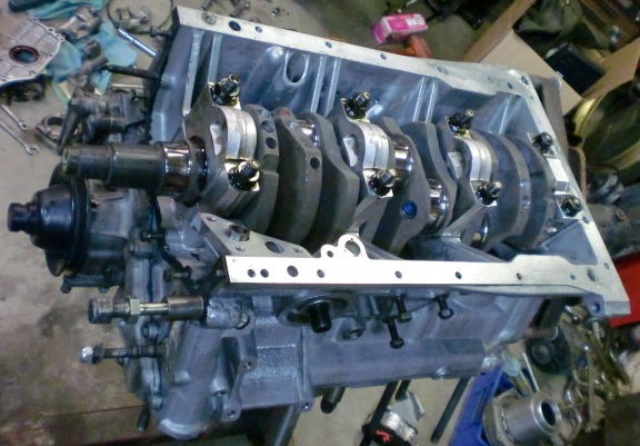

OK I found another crank for the car and had all the bits run through a balancing shop. I decided to replace the rear two con rods with spares out of the old 2.5.
Today I installed the new thrust and main bearings and torqued up the crank main studs.

I hope this works
- CIMG0241.JPG (96.46 KiB) Viewed 7968 times

The blue in the crank is a aluminium plug in place of the swedged in one that is stock....yes I ate up 2 1/4 in pipe taps doing this.
The welded up boss on the side of the block is for the belt tensioner to the a/c pump. It was broken off when the donor car was wrecked.
