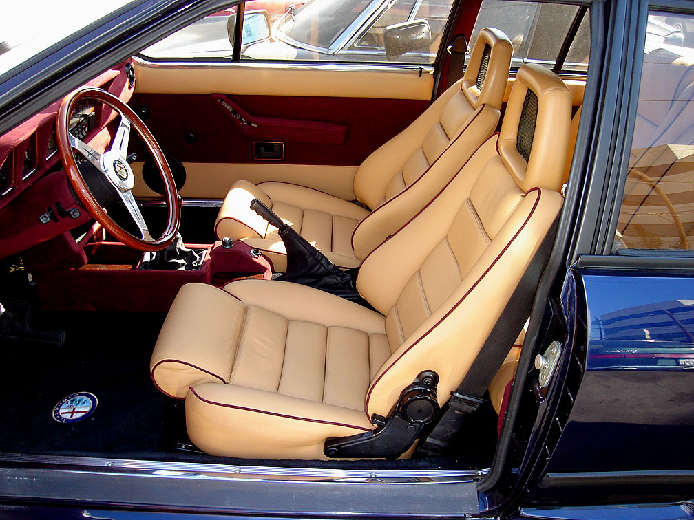

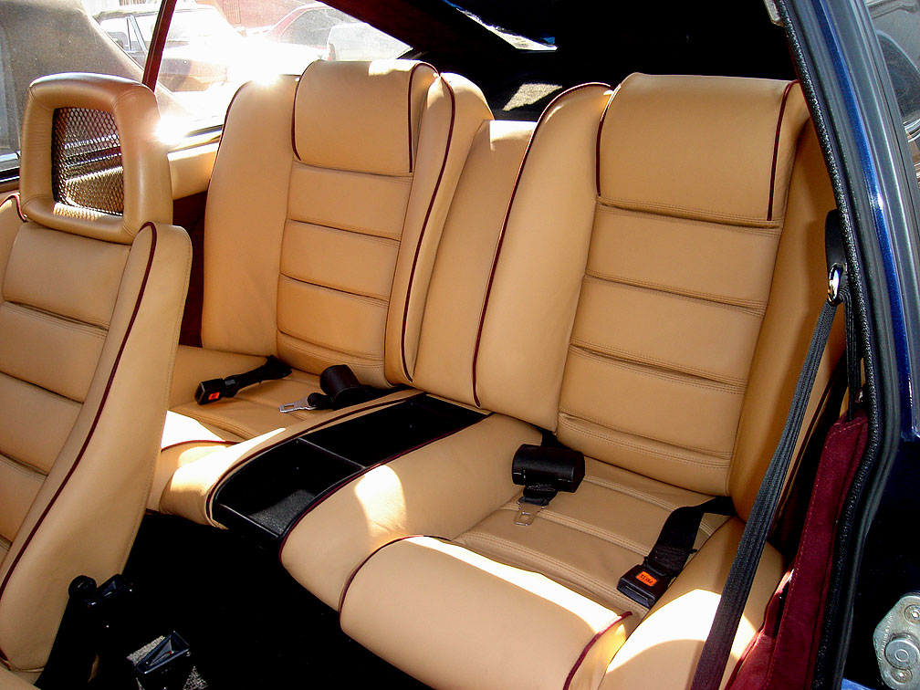

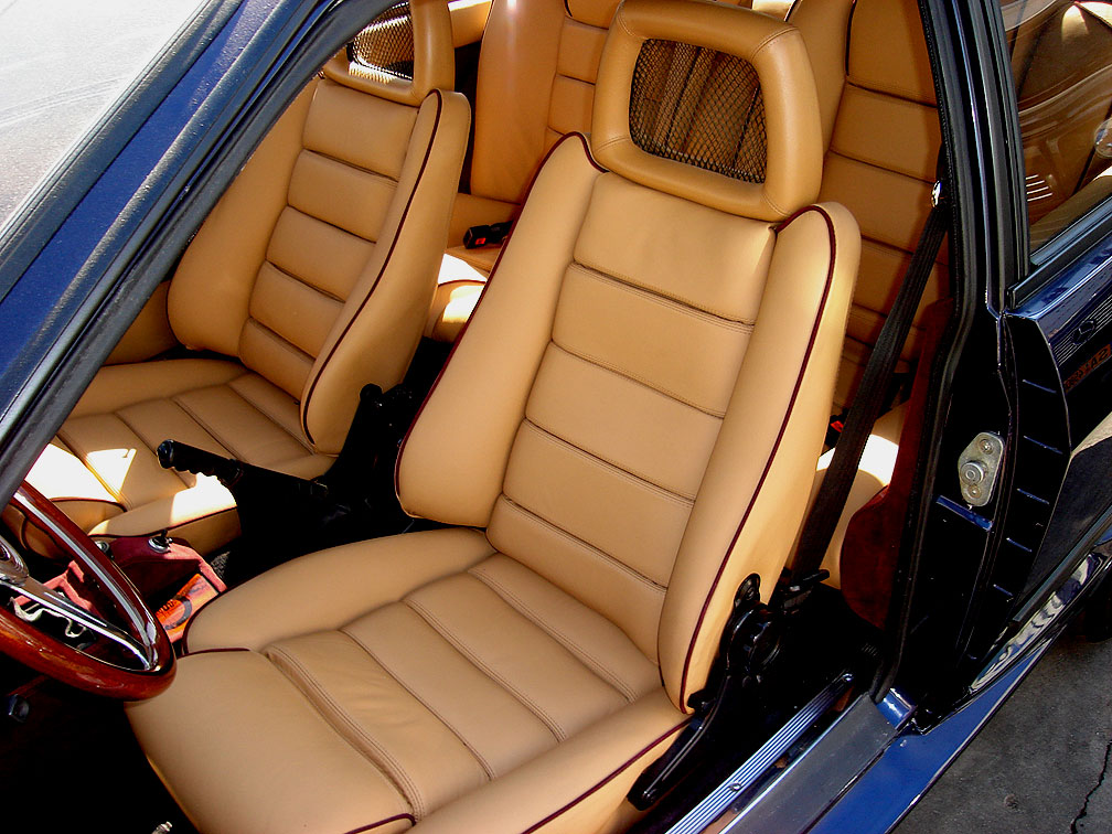

Reskinned seats installed
Hi all. Whilst the Callaway motor is being rebuilt by Historic Race Engineering, the interior got the front and rear seats recovered. There was nothing wrong with the orignals, however with the new interior the cockpit looked unfinished so went ahead and pulled the front and back seats and recovered them with identical tan leather with burgundy pips. Not to everyone's taste, but I am rather keen on it.
http://web.mac.com/rhodes1/iWeb/Site%202/GTV6.html
- interior11.jpg (210 KiB) Viewed 12219 times
- interior12.jpg (191.42 KiB) Viewed 12217 times
- interior13.jpg (164.46 KiB) Viewed 12218 times
Seats
Thanks guys. The seats are not pull over replacement leathers. I simply had Prestige Interiors use the old seat leather as a template to make the new ones and then pipe the trim using left over suede from what was used on the dash and headliner.
I am not certain of the replacement steering wheel size. It looked the same size as the original, but admittedly the Nardi is a bit more dainty than the original GTV6 wheel.

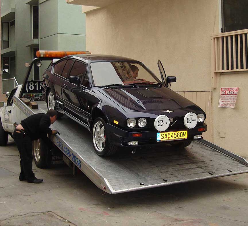

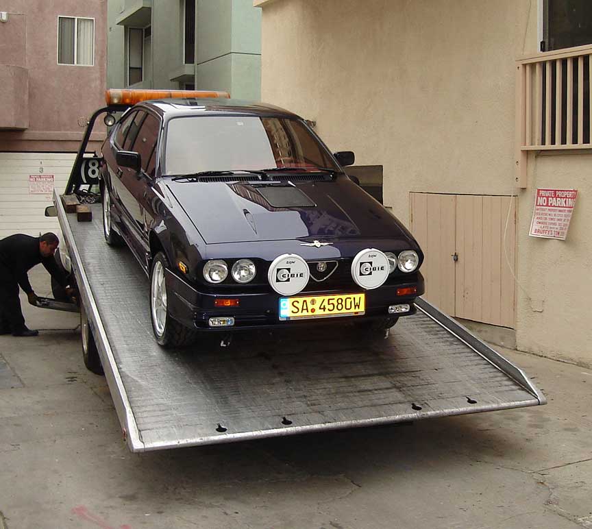

GTV6 heading to the O.C for the Callaway Motor
Hi.
Finally after a long wait my '86 headed down to Historic Race Engineering in Orange County, CA to have Greg Armstrong install the Twin-Turbo Callaway motor and the Milano-Verde transaxel with lightened gears. Greg is rebuilding the Callaway motor in total including forged pistons and gold clading all the nuts and bolts.

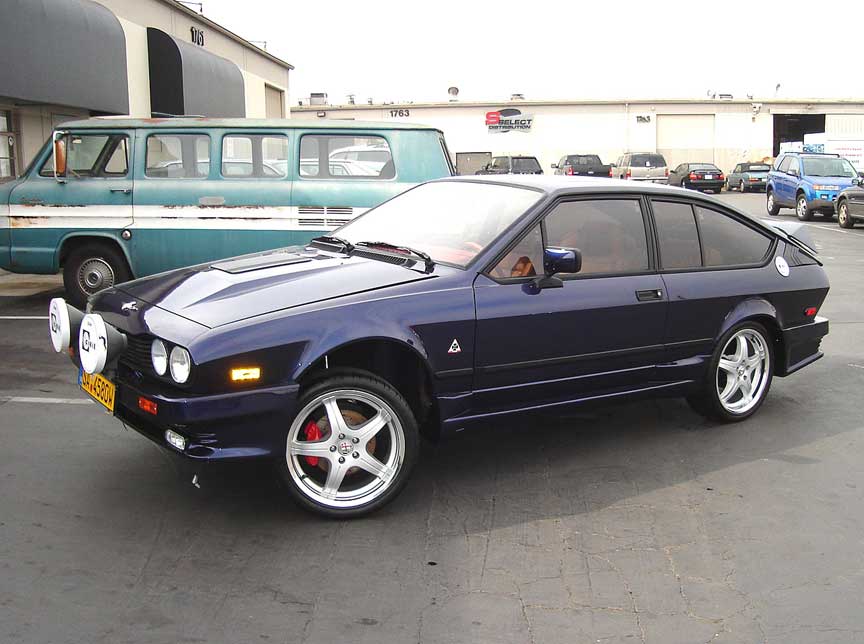

Including the more recent images. Have had the windows tinted dark brown. I like the rims on the car, but was able to get a nice set of 17 inch HRE chromes which will fit the Porsche 995 Brembo's a bit better.
I also include an image of the Alfa at rest in my garage and my Christmas present to myself, the 2007 Astin Martin V8 Vantage (I couldn't wait any longer to have something to drive fast).
Historic Race Enginering did Martin de'Campo's Callaway a few years back. Gregg there will do some similiar work, but some new technology has come along to sweaten the job and I have also now agreed to add power steering.

- feb920075.jpg (58.32 KiB) Viewed 11983 times
- GTV6 being picked up in the alley behind my house.

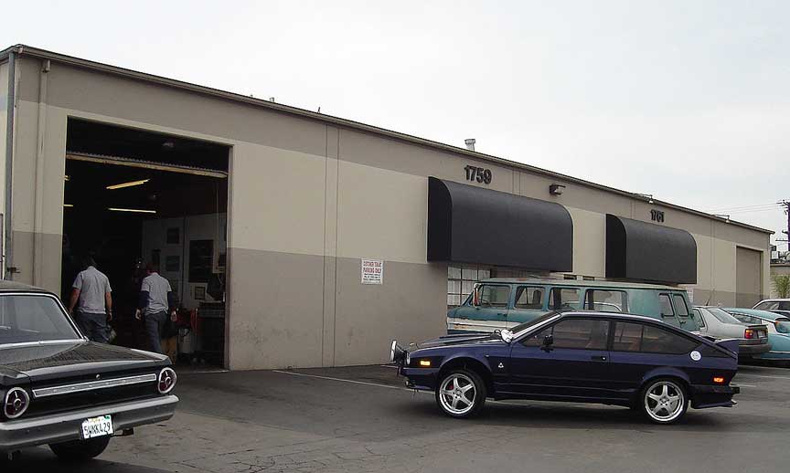

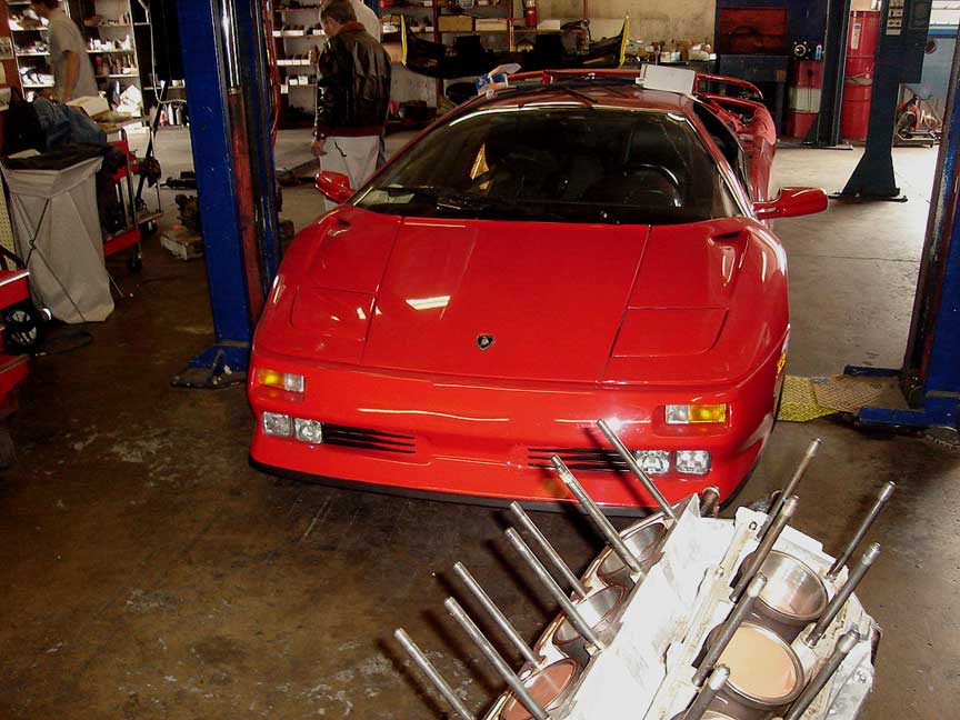

- Outside Historic Race Enginering
- feb920074.jpg (38.98 KiB) Viewed 11984 times
- The motor in progress with a twin-turbo Lambo Diablo, one of seven, done by Greg Armstrong

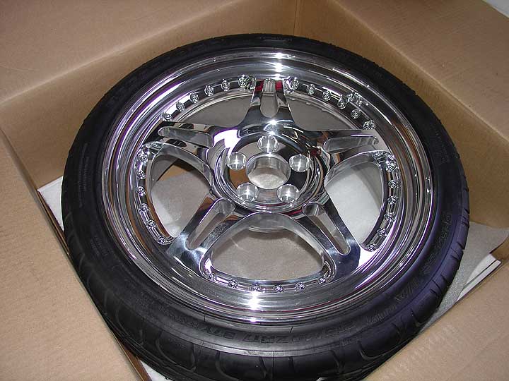

Rims
Yes those are. And they are for sale too. They have zero miles on them, and include the brand new tyres also with zero miles on them. $1000 for the entire package, cost me $1,664 USD last July and since then the car has not moved.
I am putting my original choice of rims on the car..HRE's just originally did not want to spend $6k on wheels. But with the total restoration I decided what the heck.
Anyone interested do please give me a shout.
RW
RW
They are 17"...
...rims. They do not rub anywhere. I copied what Charlie DeMarco of Serpent has long had on his GTV6 and he never had an issue with wheel rub from the tyre size either.

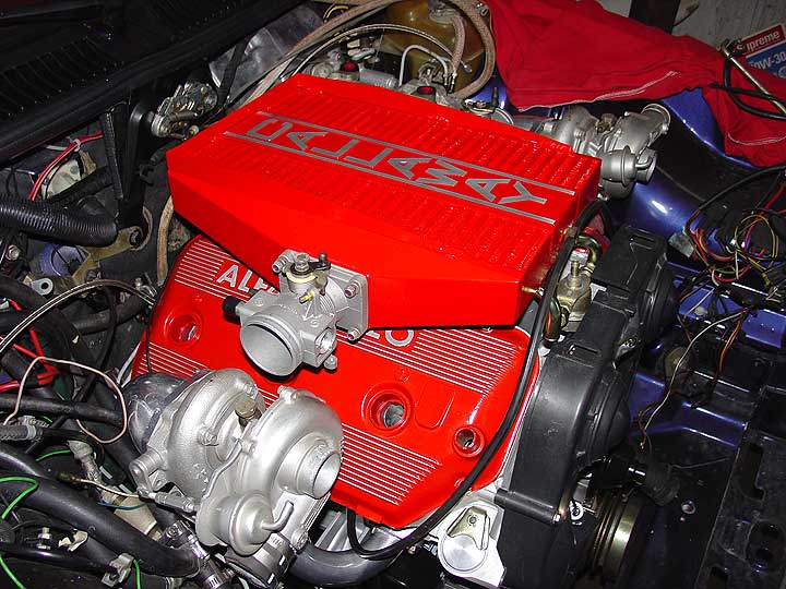

Callaway motor instillation
A small update. Now less than two months from completion of the Callaway. Gregg Armstrong showed me how things are coming along and I also brought in a few new parts. I finally found a replacement NOOS hood pull trigger. Mine still worked however the attachment for the fuse box was broken. Apparently these are getting difficult to find as not only are there none I could locate on junked cars, but also this one went for $255 on Ebay…sheesh! The new HRE rims and tyres were delivered today and do they look the part. Very clean 17 inch, three piece polished beasts.
We also broke down all the costs and exactly what will be done by Gregg to complete the Callaway project. I did also inquire as to why he gold cladded pretty much everything, and his explanation is that they will outlive me before they go rotten. Sounds fine, but I don’t care for the colour much.
The entire Callaway motor was stripped and rebuilt. The following work was/is being done to improve upon the V6 motor:

- The new 17" HRE polished rims just arrived in the box.
- HRErims1.jpg (60.23 KiB) Viewed 11392 times

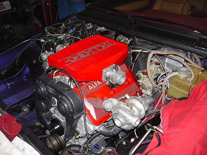

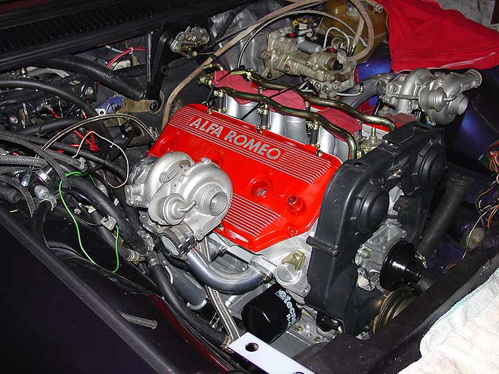

- Callaway motor rebuilt cleaned and insallation progresses
- callaway9.jpg (74.47 KiB) Viewed 11395 times
- callaway8.jpg (78.91 KiB) Viewed 11392 times
- callaway7.jpg (76.78 KiB) Viewed 11394 times

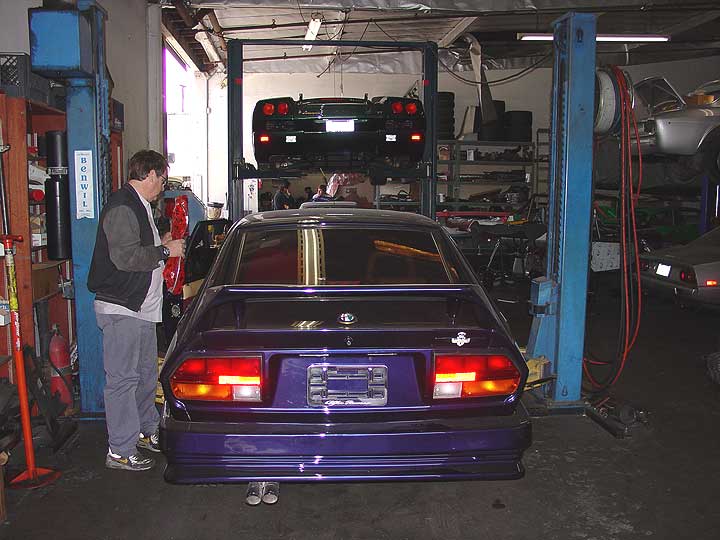

- Gregg tucks a just arrived NOS part into the car with one of his twin turbo Lambo Diablos on the lift in the background.
- Historic7.jpg (56.5 KiB) Viewed 11390 times
