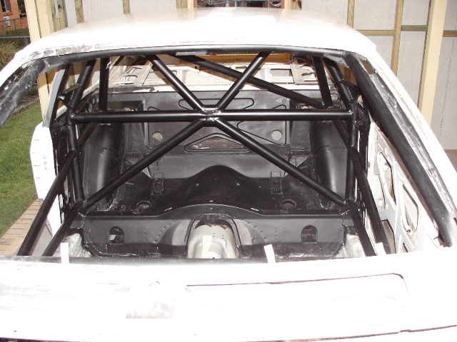

I want to install a cage in the 75, any idea if it can be rego'd here in NSW?
If not, I might just move it to QLD rego, cheaper anyway.

Hiya Ben, It will be getting a mod plate with codes for the cage, seats & seating capacity, brakes, fuel tank and ... well, just about every code you can think of. About the only thing I'm unsure of is if it is legal to run a polycarb / lexen rear screen. If it is, I'll bond one in.

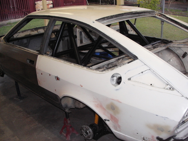

Yeah can register a cage but need an engineer's certificate.... bit of stuffing around- may as well do the QLD rego thing mate
Nice cage daniel- weight?

Are you chasing car weight or cage weight.

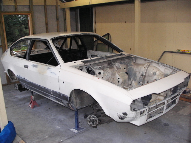

Car weight is targeted at <1050kg but I won't know until it is complete and put on a set of corner scales. It has been on a substantial weight loss program, though you can see that from the current pics. I'll still retain some luxuries like a stereo but a lot of stuff has gone.
Cage weight is around 40 - 50 kg. A little heavy but I used 350CDS to meet CAMS. Could have been lighter and stronger in CrMo.

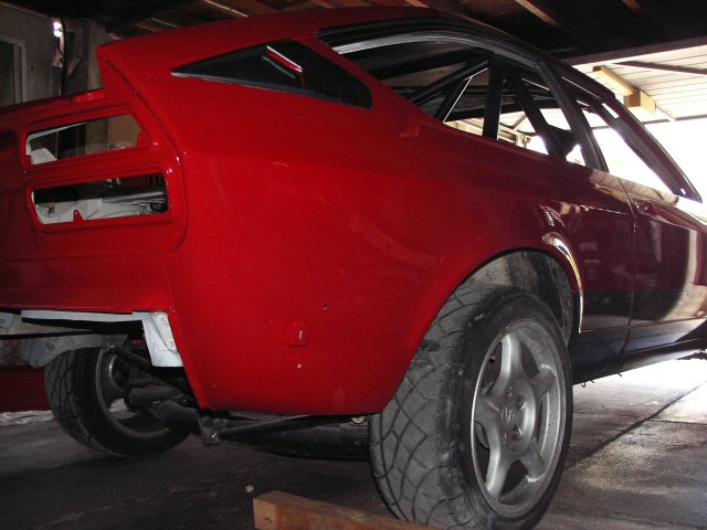

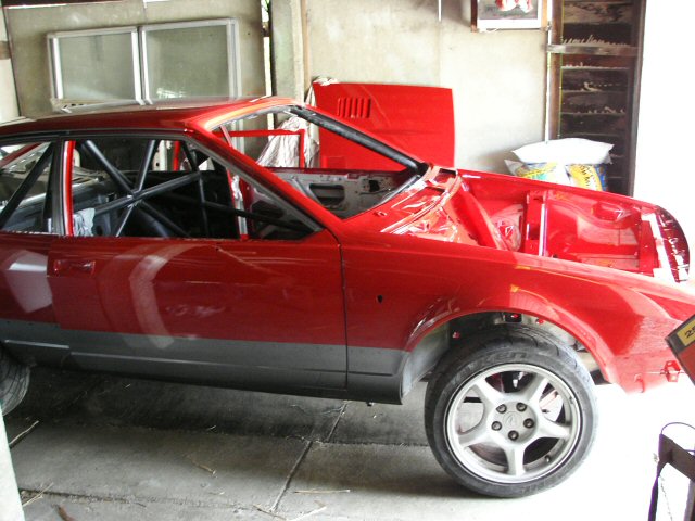

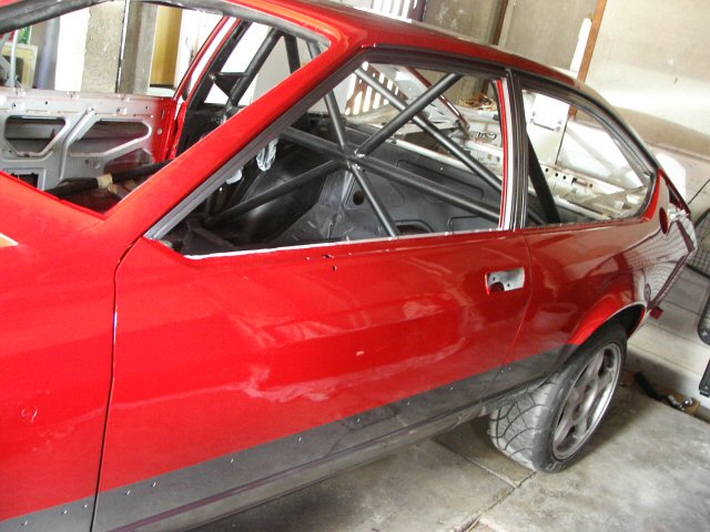

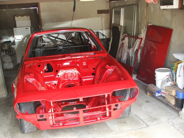

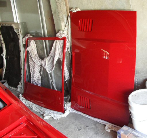

Because I was such a good boy this year, Santa brought me a new paint job as an early Christmas present
After all of that hard work, the paint looks great !
Now it gets down to the real work - stuffing in the 3.0 24v and putting everything else back together.
- Rear quarter
- 06-12-18 012.jpg (62.65 KiB) Viewed 11396 times
- Left side
- 06-12-18 006.jpg (78.06 KiB) Viewed 11396 times
- Right side
- 06-12-18 003.jpg (77.29 KiB) Viewed 11398 times
- Bonnet
- 06-12-18 002.jpg (62.55 KiB) Viewed 11399 times
- Front
- 06-12-18 001.jpg (85.13 KiB) Viewed 11397 times
