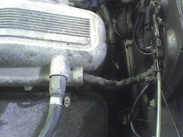

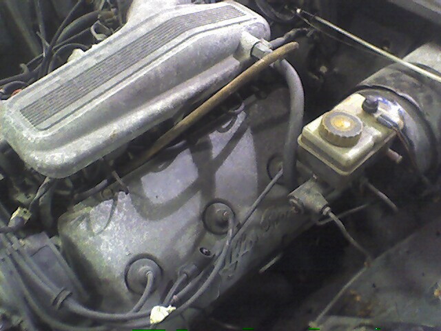

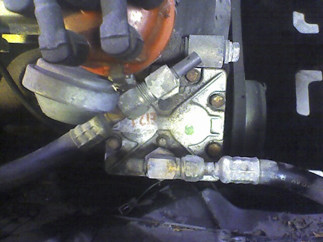

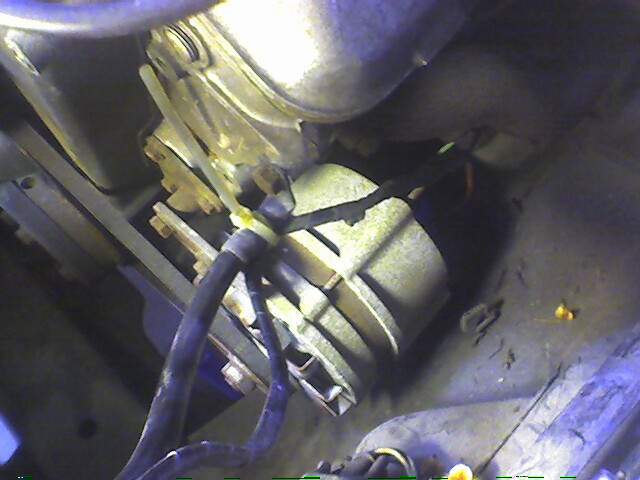

Alfa project right on track. We were not able to finish this weekend so I hopefully will get this out next weekend. Did think I was going to have so much fun actually restoring my car. Here are some more pictures of us pulling misc. items from the engine.
I have one question to anyone who may know this. The picture with Main Harnes with the 6 injector wires is the last main wiring to remove. It appears to be held on with one bolt and then the wiring is run on down the plen. Is this the only thing to remove and then to unclip the injector plugs? Is there any special procedure to do this? Thanks for any suggestions.

There is not special procedure. However great care should be taken to avoid damage to the injector's electrical plugs. They are secured with a little wire clip that has to be released with a tiny screwdriver or something like it. Then it will pull right off the injector. If you don't do this you will break the connector.
I suppose you could do that to minimize the freon attacking the ozone layer. However it has almost certainly already leaked out so I don't think it will do any good. If you want to minimize the amount of freon escaping then be sure to turn your A.C. on at least once a week, even in the winter to keep the seals from leaking. That will do far for to prevent freon escaping into the atmosphere than hooking up an already empty system to a reclamation machine.

Thanks for the information Gordon,
My associate did mention the freon and I thought this would be under great pressure when we removed the connections so I did not want to disconnect this without guidance. There was a presure release on the one side of the connector and we tried this and there was no pressure at all. So the enviroment already received my freon. I know that Alfa's Air conditionings are not that good anyway but I am sure it would help if it had freon.
