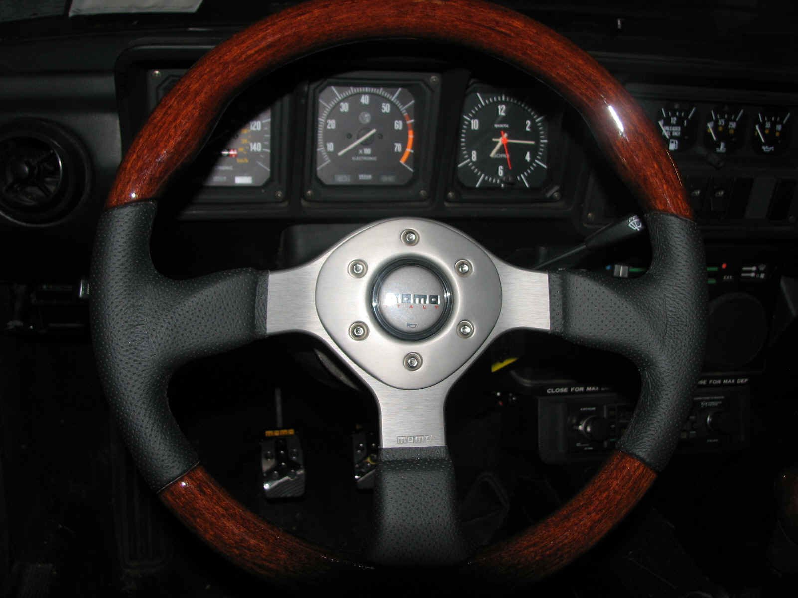

- Old world charm with new age technology - I love it! Look! - Momo pedals!
- IMG_2171.jpg (108.49 KiB) Viewed 9100 times

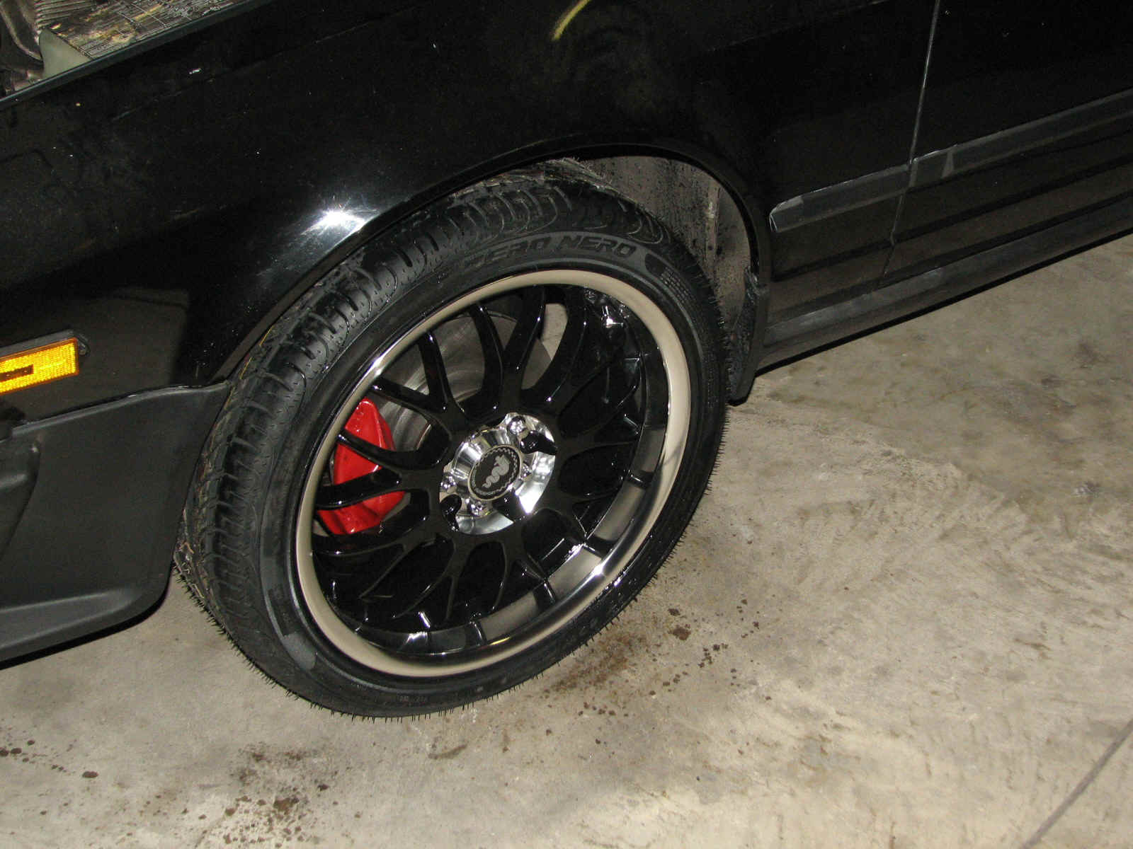

- wheel with red caliper (rebuilt brakes, new rotors, steel braided lines)
- Happycar.jpg (141.49 KiB) Viewed 9101 times

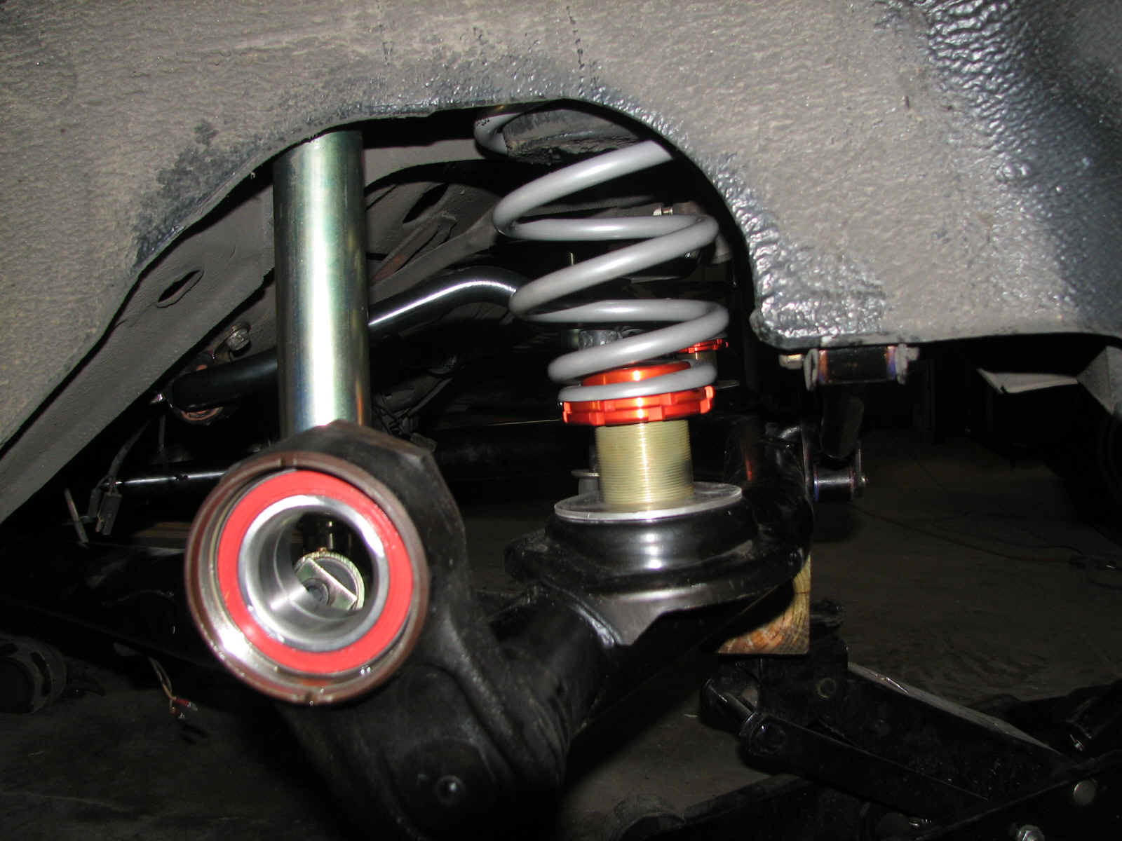

- Here is a beautiful wheel. It's the left rear. You can clearly see the RSR shock and coil spring.
- wheel_w_suspension_visible.jpg (223.85 KiB) Viewed 8949 times

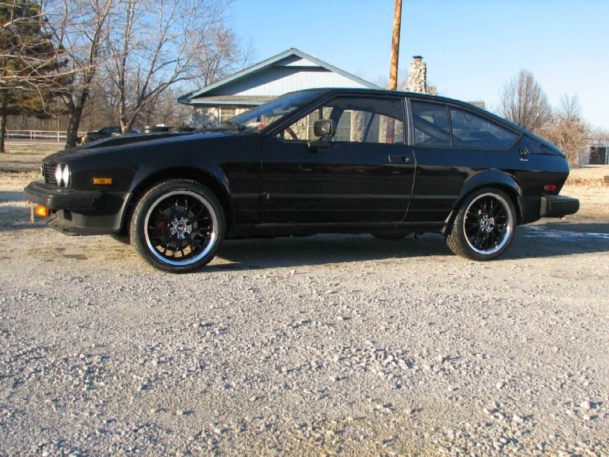

- We took a few outside shots when we repositioned some cars today. Ok, I KNOW the front end is too high. I will need to make an adjustement to the front torsion bars.
- benning_wheels_on.jpg (226.28 KiB) Viewed 8952 times

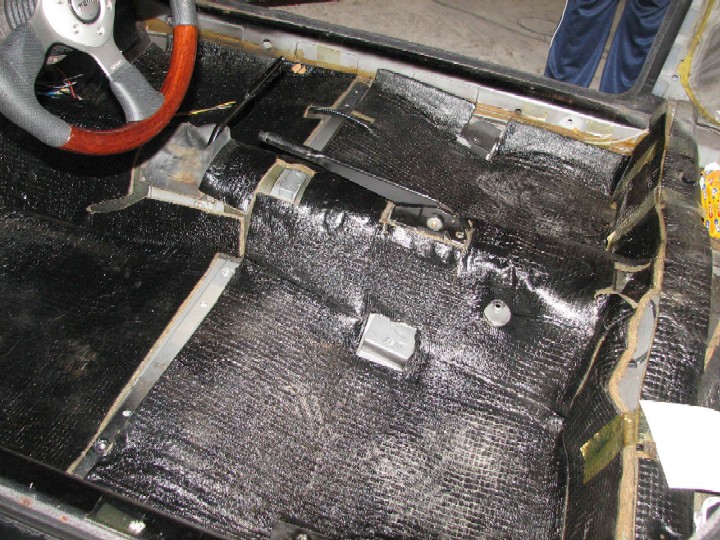

You might have noticed the seats have disapperared, to be replaced by Corbeau leather TRS model. The interior will be given three additional layers of dampner and then new cut and sewn oxblood carpet will be laid (perhaps best described as dark burgundy).
- Benning_Interior.jpg (169.1 KiB) Viewed 8927 times
