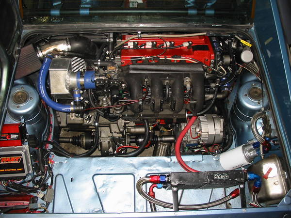

It's easier to attach a picture than to try and explain this manifold thing. Although this picture is somewhat censored you can clearly see, we bolt the pipe carrying air from the supercharger, and through the intercooler to the stock manifold. This works very well.
With all things equal, a supercharged Alfa 12 valve V6 will put out more power than a supercharged Alfa 4cyl. by a large margin. The problem for the V6 arises when you run into another limitation. For example if your transaxle can only handle 300hp and you can get that with either supercharged motor, the 4cyl may be the way to go for packaging, originality, and if it weighs less, performance. Of course you are right about the V6 not having to work as hard to make that amount of power. It's not a clear cut choice. If you want the V6, go with it. I am just saying I would stick with the original engine type, but that's me, and it's not my car.

Re the manifold - I take it the alfa has direct port injection and there is a throttle body somewhere in there? I could see then how you could install using the standard manifold with the injectors mounted on fabricated bosses? Intercooling may be an issue with the mid engined setup getting more air to the back, although I do have some ideas in this regard, it would require changing the rear buttresses for solid items and moving more to 037 scoops.

In the picture I posted the throttle body is located before the supercharger. This particular setup goes air filter, throttle body, supercharger, intercooler, intake plenum. More often I leave the throttle where it is and go air filter, supercharger, intercooler, throttle body, plenum. There are advantages and disadvantages to each configuration.

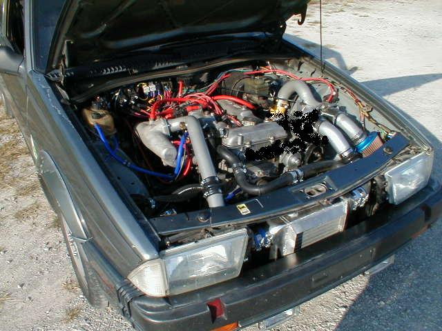

Hi Bruce,Bruce wrote:I was going to suggest a Thema 16v turbo engine which will give you easily 300hp but those are getting quite rare now!
You're not kidding! And it's not a straightforward install. Has been done though. This is Ken Haven's car from the States.

I guess that as the inlet is charged or 'forced' you can get away with more a more convoluted inlet tract? Can you give me a brief synopsis of the pros and cons to each?Greg Gordon wrote:In the picture I posted the throttle body is located before the supercharger. This particular setup goes air filter, throttle body, supercharger, intercooler, intake plenum. More often I leave the throttle where it is and go air filter, supercharger, intercooler, throttle body, plenum. There are advantages and disadvantages to each configuration.

Think of it this way; the intake tract I showed in that picture is no more complex than it would be with either a turbo or centrifugal supercharger using an air to air intercooler. It's just not a problem.
I just don't have time to go over all the pros and cons of the various throttle positions right now. It's a complex subject that gets into all sort of other areas for example, bypass valves and fuel injection tuning issues. I will try and get to it when I have time.
