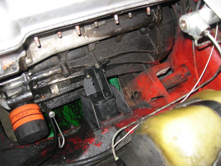

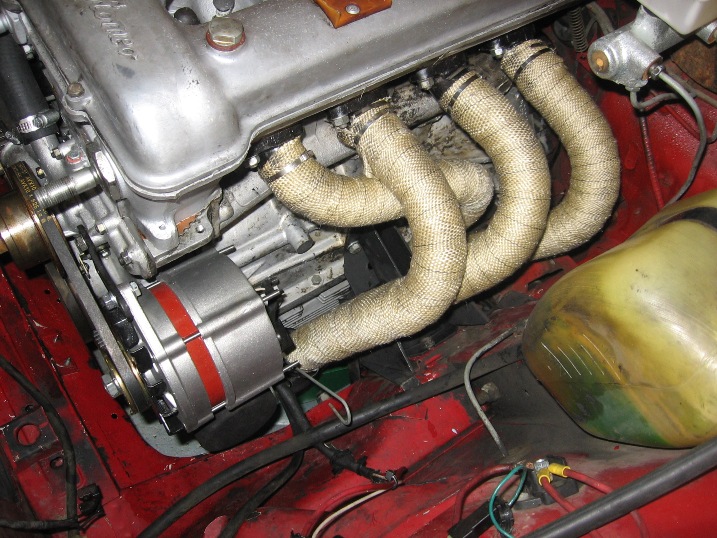

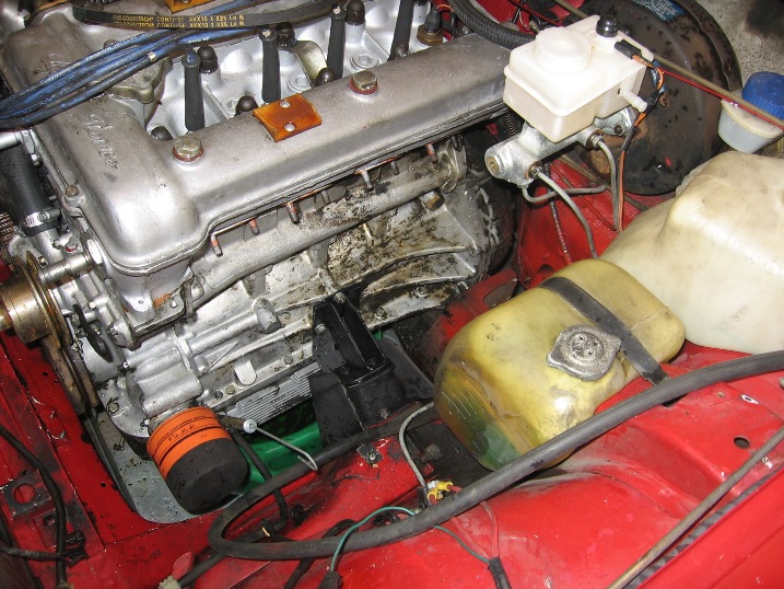

so had some time to work on the fetta:
1) removed old exhaust, what a pain in the d*ck
2) installed rear part of 'new' exhaust (see pic) had to drop the trans a few inches. another pain in the d*ck
3) replaced L and R engine mounts. Major pain in the d*ck. the new mounts were slightly taller than the old ones (no not because the rubber is new, the metal parts are slightly taller). Lots of prying and shifting, but went in OK with a 2x4 and a mallet.
4) repaired left mount heat shield
5) repaired the hood hinges and spring mounts. the sheet metal here was all jangled and bent from some dope shutting the hood and catching the spring on a broken spring guide. ugly.
6) new outside headlights. the hella H4 ones fit, the cheap chinese ebay ones in the red and white box don't fit.
7) test fit the new CSC headers (had to use a hydraulic spreader to spread the inner tubes a little bit, then went on just fine..from Performatek)
got a set of new (really, new) front spoilers OEM. to be installed soon. 1/4 in rivets fit the alfa holes perfectly. bought a harbor freight rivet gun (get the bigger one) AWSOME. works every time.
The center ANSA muffler I bought off someone a few months back weighs a ton and is going in the trash. However, the rear muffler is well made and reasonably weighted. stock cat was on the car but has been hollowed out. there is a center resonator, not sure if I will use or not.
see pics

Re: XRAD'S ALFETTA
Hey Mr Chrome, I just can't let this go.
That engine bay is a disgrace. How in the hell can you work on your machine without giving it a clean down first and then proceed with restoration?? That's fully loopy. Bit like getting ready for the ball with your jacket and tie on but forgetting to put your pants on. It's just plain wrong, wrong I tell you, wrong, wrong .
You could start an ecological farm in all that shmoo.
Otherwise you're doing a good job from what is visible through the grease..
Re: XRAD'S ALFETTA
You see, grease, I see rust protection!! hahah
Re: XRAD'S ALFETTA
grease...??? what grease??? I thought all alfas were this color.........
Re: XRAD'S ALFETTA
oh yeah..there is an engine in there.....

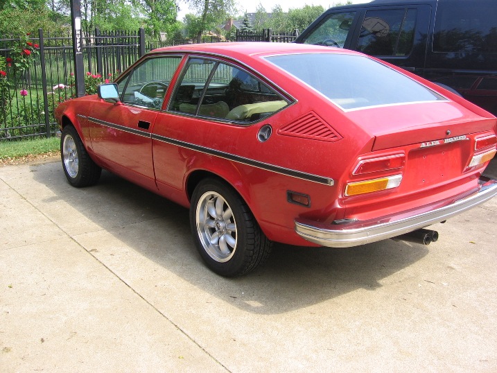

Re: XRAD'S ALFETTA
If you have not seen the build details over on alfabb, here is a few pics.
Much work done...
few final things to tidy up. more interior work, exhaust...etc..
Much work done...

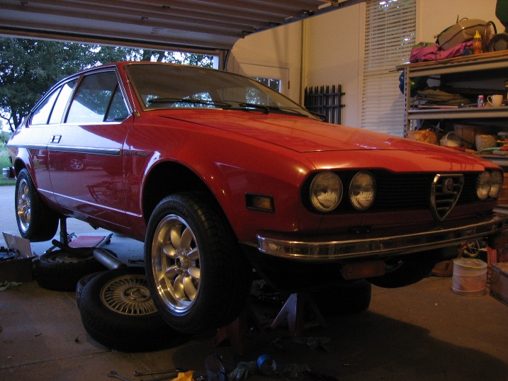

Re: XRAD'S ALFETTA
Those wheels look outstanding! Are they 14in? how much for the set?
Re: XRAD'S ALFETTA
Thanks Bro! You seem to really like the ROTA wheels
550$ US for set delivered from California. I prepaid a few months ago.
check out
18racing
the RB wheel
true 4x98, 15in, offset 35+mm, 58.5 hub( which fits fine) VERY light...maybe 12lbs I will weigh one
You will have high import tax?
I am using 205 55 15's G-force sports 85$ each, super tire...quiet, great grip..firm sidewall, and looks good
check out
18racing
the RB wheel
