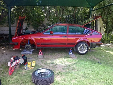

Sure 75 evo very welcome here . I took some pics of the carbi car before I loaded it Into container . I also gave it full service including water pump and cam belts . Some pics to follow . Probably would have finished the race car ( front mount)if never had to spend time on this car . Things got kinda hectic selling white race car(71)which included engine transplant and dyno and its snags . So time was shared between three cars . Some pics of service and at car delivered at couriers . Last time it sees sun with zero humidity.

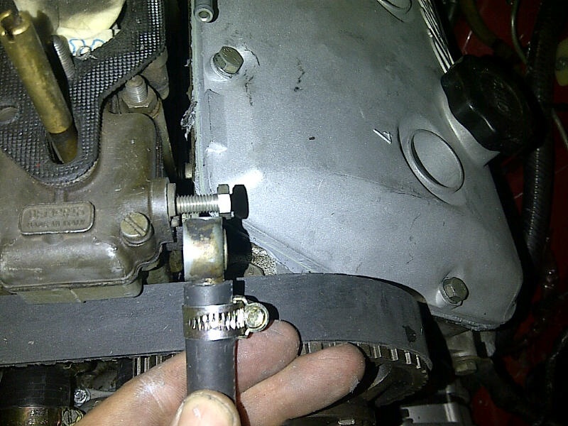

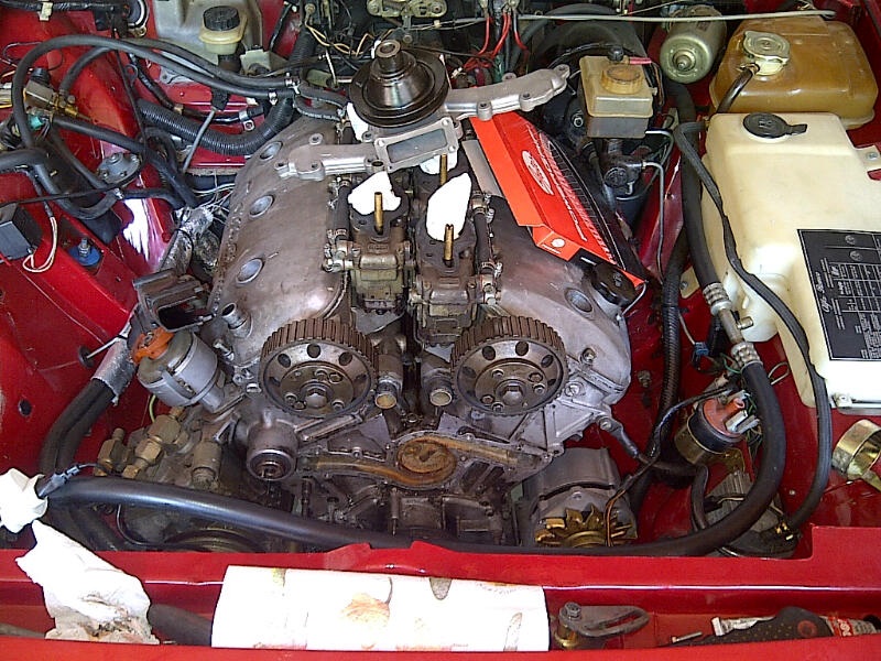

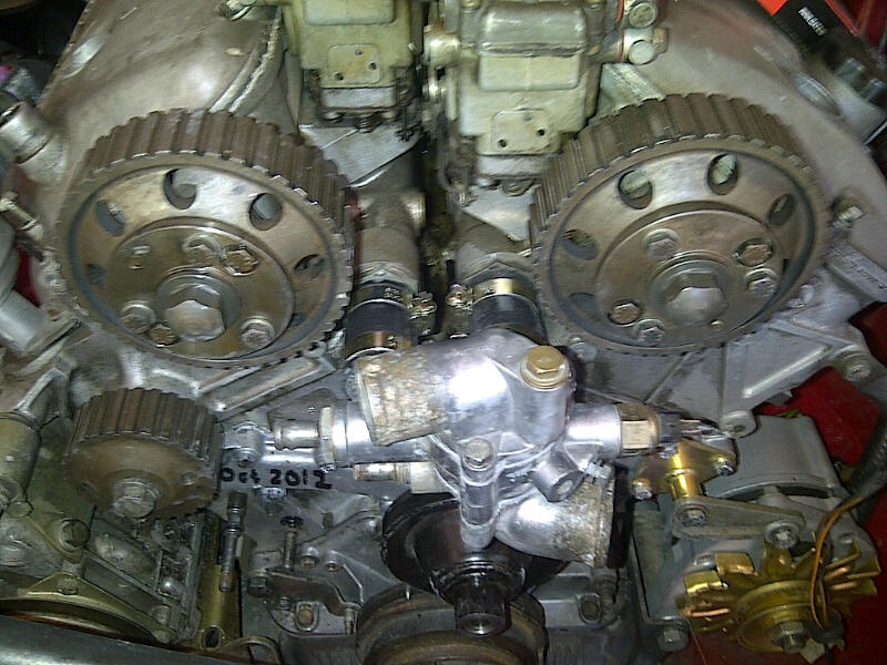

Some pics of belts and water pump replacement

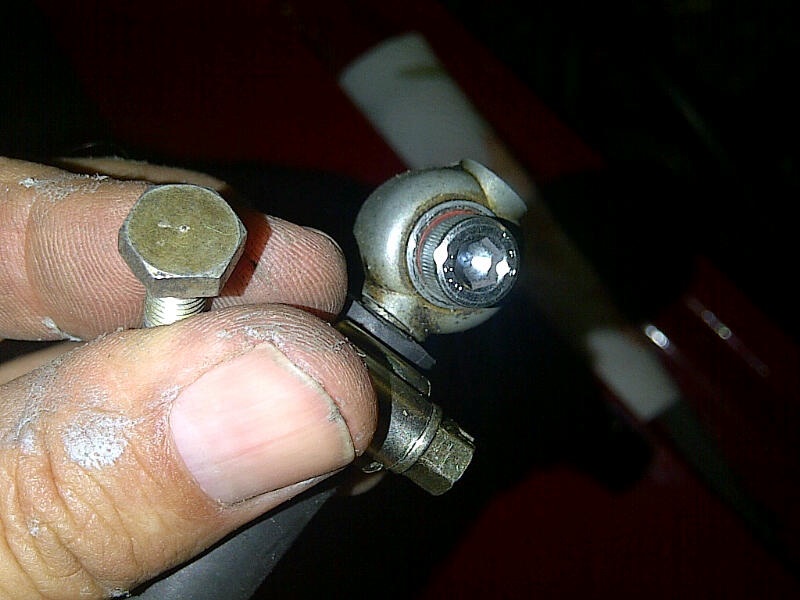

Fuel leaks are a problem . Tried changing from hex head to cap screw as edges of hex head interfere on sides when tightening banjos on . This gets good even pressure on paper washers .
Rust proofing and oil change .
kevin wrote:Fuel leaks are a problem . Tried changing from hex head to cap screw as edges of hex head interfere on sides when tightening banjos on . This gets good even pressure on paper washers .
Hang on a minute here, are you not using banjo bolts for this? How is that even possible? :?
That's the main problem in design is ifthe TWO paper washer are not perfect then you have a leak and also the banjo housing does not a have square face to it .. The fuel flows in the banjo housing and has two seals but the thread the bolt goes into is not recessed as in atypical banjo fitting and has tiny holes around inner housing . Tricky to explain . Will find a side view pic .
Temperature change is a problem so they normally sweat or drip on start up an then they are perfect . I was trying to get some custom washers made as all the Wurth copper and aluminium ones did not work , only the paper type . Can't use o rings either but I had some chap making some " alcohol " resistant urethane based seals for me . These fitting are the biggest pain on these cars if not right .
Why not just put regular banjo bolts in there and a couple of copper washers?
We thought of that but the material the carbs are made of are very brittlle and its always risky tightening up a paper washer and becomes even worse trying to seal up a copper washer unless the coper is extremely soft . Also the vibration on the copper leads to bolts loosening . Their is another thread here which shows all the bolts wire locked once in position . The faces that the washers go up against are not flat which does not help with a good seal for copper and also needs extra torque when tightening the 5mm bolts . If they snap its game over . Best solutions are really good quality paper washer that the cars came out with ( can't get - ) or custom washes made as mentioned or finally deal with the Wurth paper type which is a bit hard .
