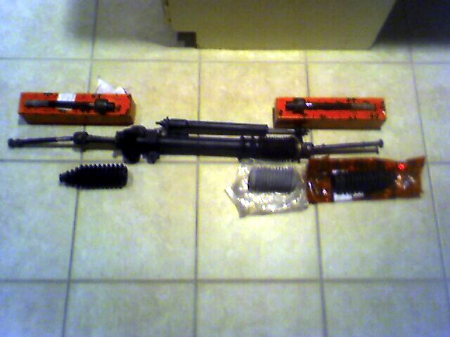

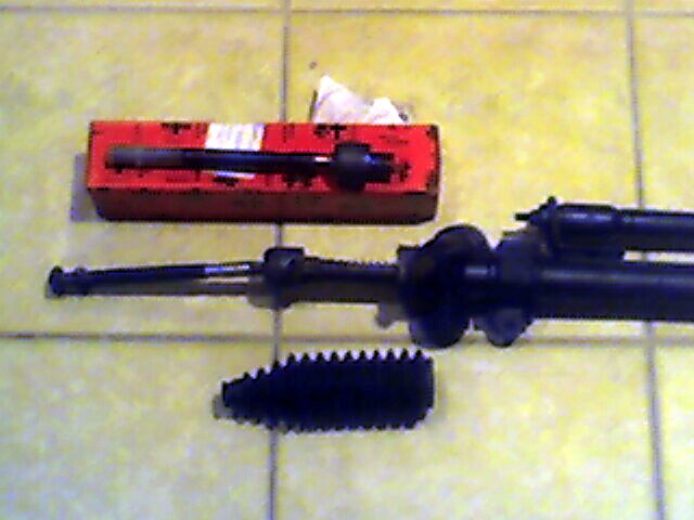

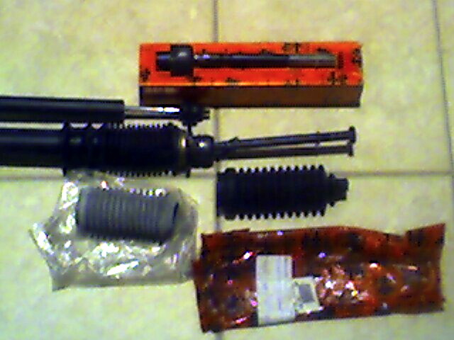

I was sourcing the last parts that I need to finish my project. I was going to send my steering rack to Texas but I did not get aroung to doing this in time so I decided to rebuild this myself. I had Jon Norman look at it today and he confirmed what everyone else said that these steering racks do not break. I had 0 play so it passed inspection. I was able to purchase 2 new boots, inner boot, and 2 new inner control arms. Only one control arm was worn but I figured might as well replace both since I am doing the work anyway. I will rebuild this on Saturday if I do not have to work. I am just missing the boot that covers where the steering column connects to the rack. This part is no longer available so I am going to look at my old part and try to custom make some type of boot. I was told that there are some racing parts that maybe able to be interchanged. Does anyone know anything about this Here are pictures of the new parts.
Alfa Steering Rack new parts #3.JPG (70.27 KiB) Viewed 9446 times
Alfa Steering Rack new parts #2.JPG (60.53 KiB) Viewed 9446 times
Alfa Steering Rack new parts.JPG (58.74 KiB) Viewed 9446 times

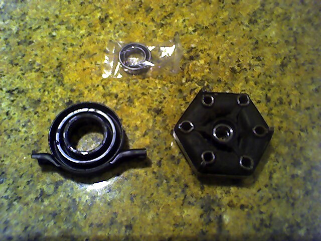

I was also so lucky to source the last parts of my drive shaft so that I can complete this issue and send out the drive shaft to be rebuilt and balanced. I actually found a rear guibo at a fair price along with the center bearing and new housing. Both my old parts were ok and I am saving them for the future. I am just happy to get this rear guibo since I was giving up and the plan was going to be use the old part again. I am sure they would not have failed but it did not make sense to replace the front guibo and center guibo without the rear guibo. I will be bring this next week to have my drive shaft issue completed. Here are some pictures of my very hard to find and valuable part. I am definately going to look for extra ones. I know that the front guibo wears out first but who knows what can happen. We now have all parts to complete my project

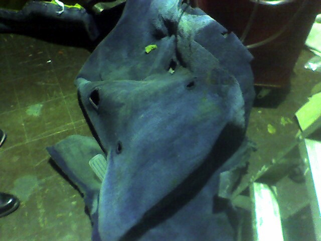

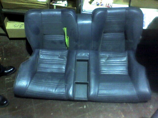

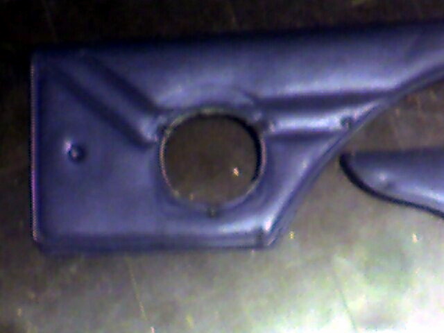

Finally, we have met with Joe who will be doing the interior restoration for me. We have decided to restore this factory stock but with better materials. I am changing the car to Black leather with red piping. I am not sure if I will also do red stitching but Joe will give me an example. Joe thinks that red piping would look good but was not too sure about the stiching.

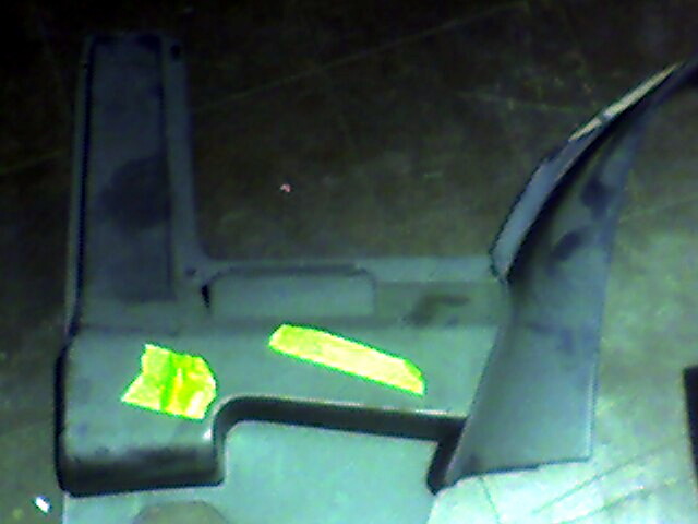

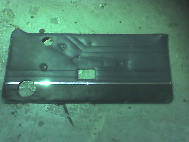

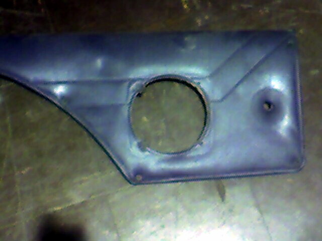

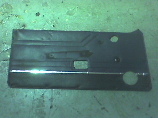

All the interior parts are with Joe so he is starting work as soon as possible. We went over the goals for the interior and I am posting some before pictures to share with the Forum.
Alfa Interior Before Rear Panel #5.JPG (49.23 KiB) Viewed 9095 times
Alfa Interior Before Rear panel #4.JPG (42.92 KiB) Viewed 9097 times
Alfa Interior Before Rear Seats #3.JPG (69 KiB) Viewed 9094 times
Alfa Interior Before Fnt Seats #2.JPG (68.53 KiB) Viewed 9095 times
Alfa Interior Before Carpet #1.JPG (63.19 KiB) Viewed 9095 times

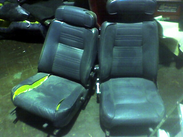

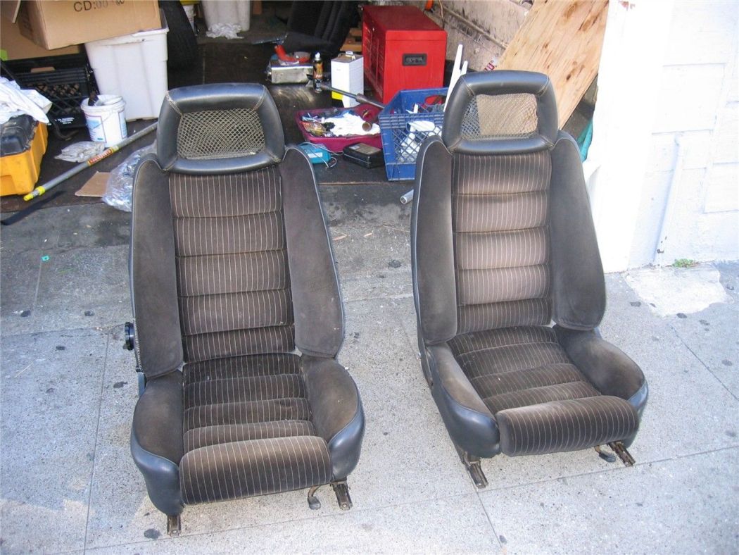

Here our photos of the 85 Alfa Seats that we will be restoring rather than my original 82 Alfa Seats.
85 GTV6 Front Seats-before restore #2.jpg (170 KiB) Viewed 8999 times
85 GTV6 Front Seats-before restore #1.jpg (153.97 KiB) Viewed 8999 times

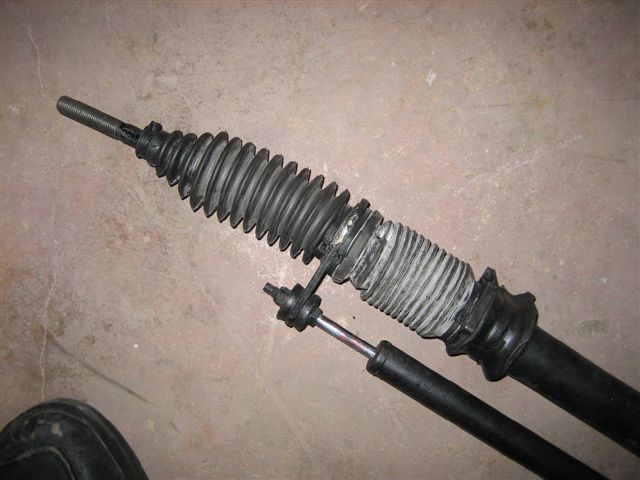

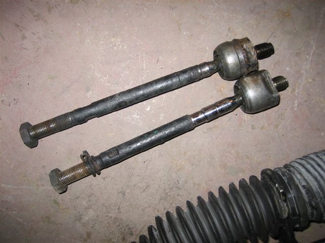

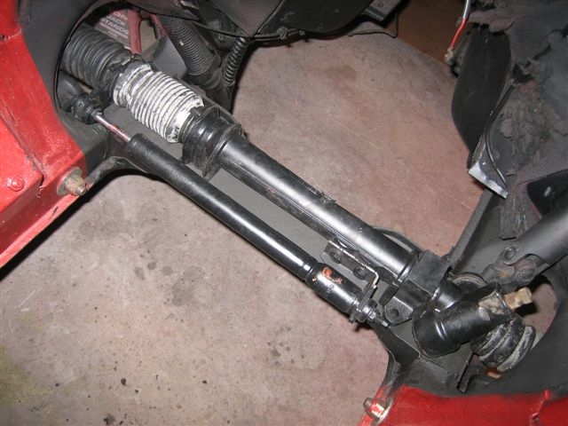

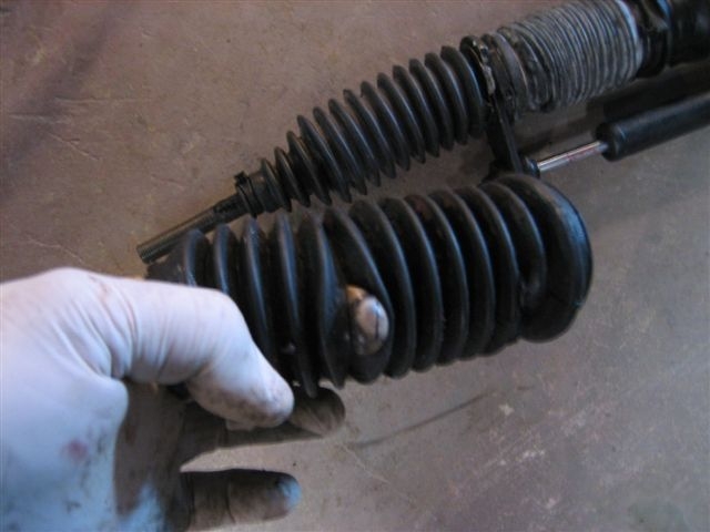

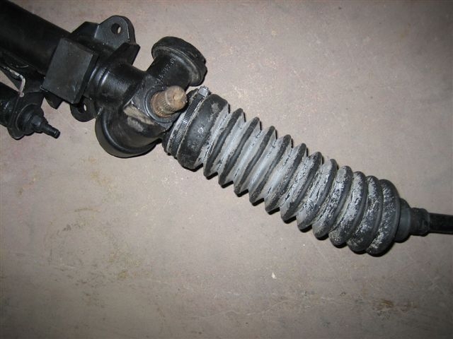

We have rebuilt the steering rack and grinded down standard wrenches so that they would be slim enough to remove the inner tie rods and allow us to change the rubber boots. Here are some pictures of this.
Alfa Steering Rack #5.JPG (159.21 KiB) Viewed 8723 times
Alfa Steering Rack #4.JPG (132.88 KiB) Viewed 8723 times
Alfa Steering Rack #3.jpg (51.73 KiB) Viewed 8724 times
Alfa Steering Rack #2.JPG (119.17 KiB) Viewed 8724 times
Alfa Steering Rack #1.JPG (146.63 KiB) Viewed 8724 times

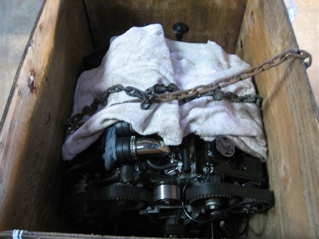

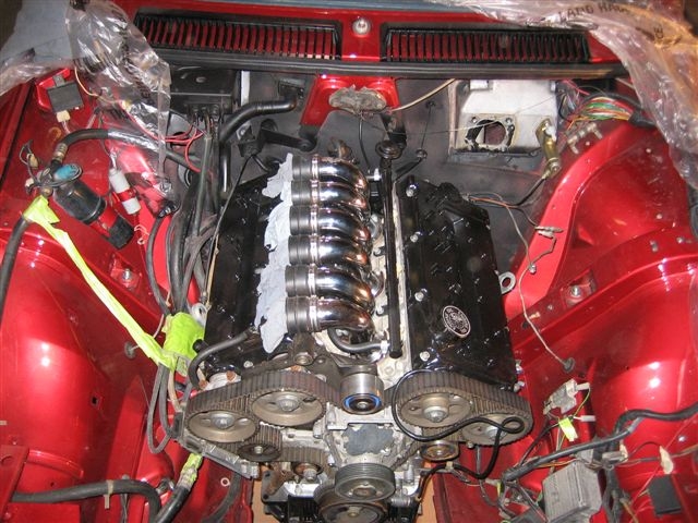

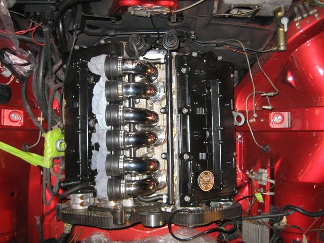

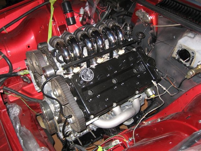

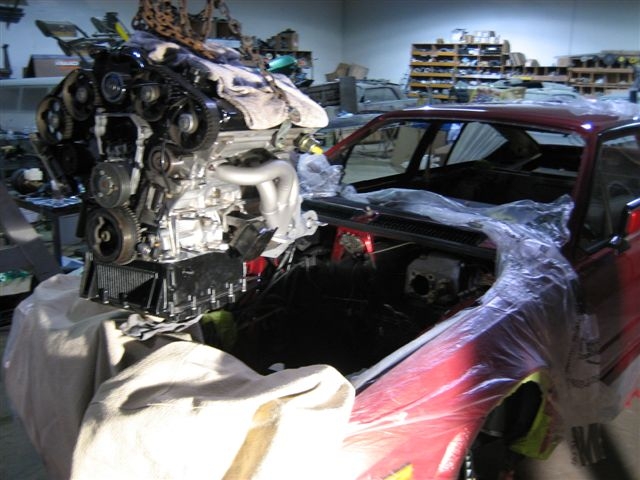

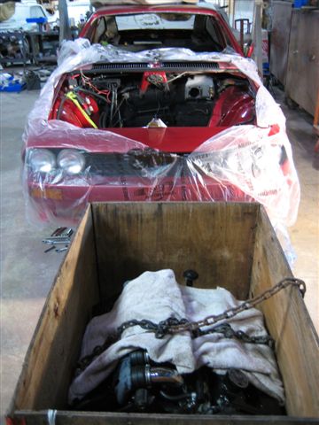

Once this was done we moved onto the engine install. JJ prepared the engine and double checked everything. We put in freeze plugs for the old heater hoses and did the final tweeks to the engine mounts. We then installed the engine with 4 guys. The engine went right in and it definately was alot easier with the Brake Master Cylinder, radiator, etc out. It took about 10 mins. Here are the pictures of the engine being installed.
Alfa engine installed #4.JPG (173.02 KiB) Viewed 8718 times
Alfa engine installed #3.JPG (158.33 KiB) Viewed 8719 times
Alfa engine installed #2.jpg (46.09 KiB) Viewed 8718 times
Alfa engine installed #1.JPG (143.58 KiB) Viewed 8720 times
