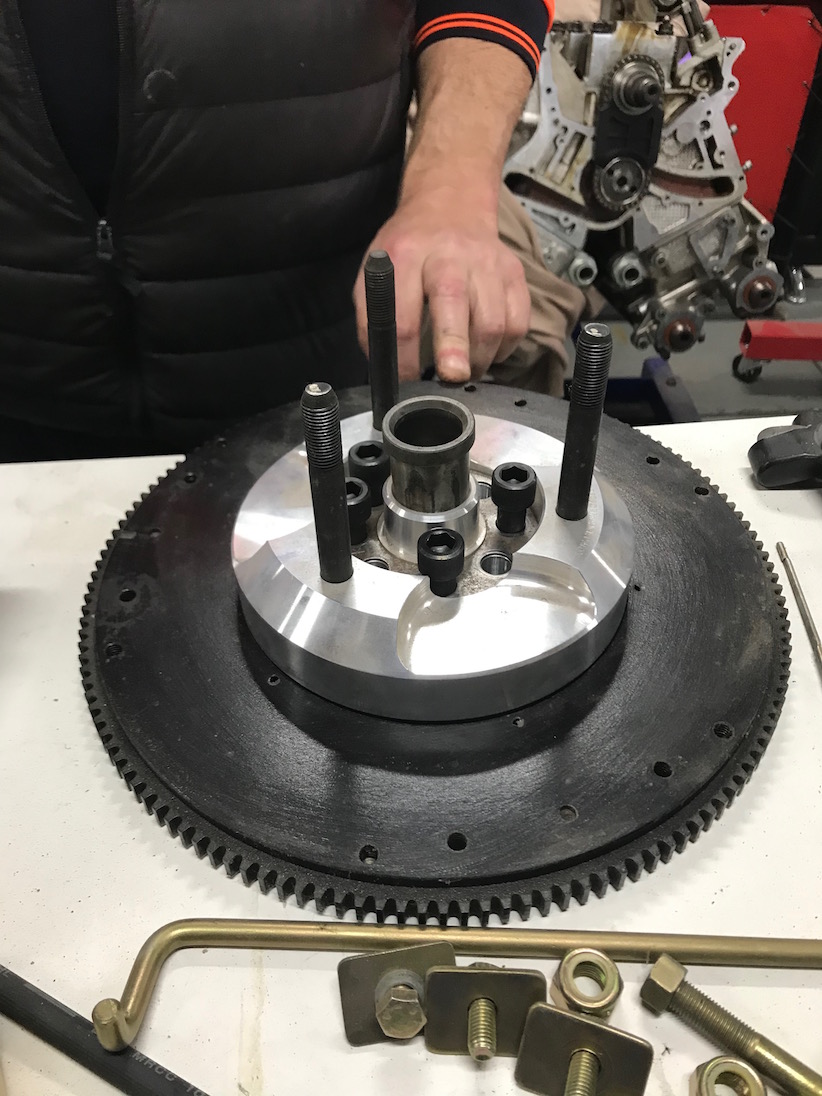

What you can do in the meantime is I can send you all the drawings , specs and adaptors if you want to the BMW ZF box conversion. I just helped my friend do his in SA on his race car and he's definitely not complaining about any handling issues.
The flywheel and clutch is now off the shelf basically .

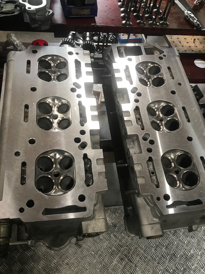

Valves and seats had a performance oriented radius machined in.
Inlet ports untouched, but the dividing walls were knife-edged.

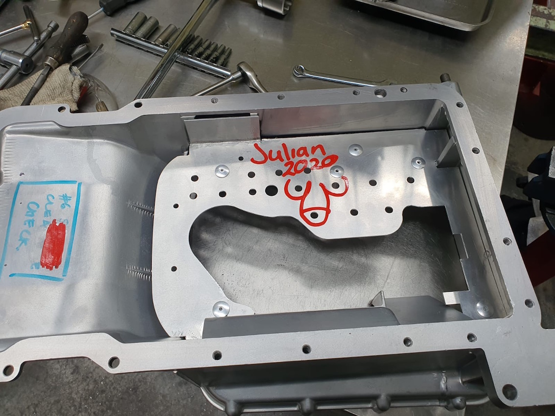

2.5 sump mid section modified to take a windage tray (see Mikey's artwork - he is a Toyota turbo fan
) and a billet bottom plate from a guy in Melbourne fitted.

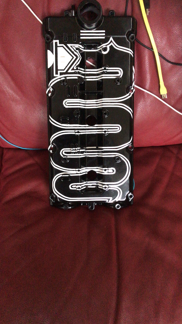

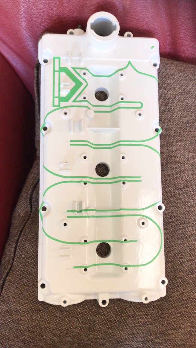

I masked and painted the Rocker covers...the first pair I did didn't work, so I gifted them to Frank (engine builder) and did another set.

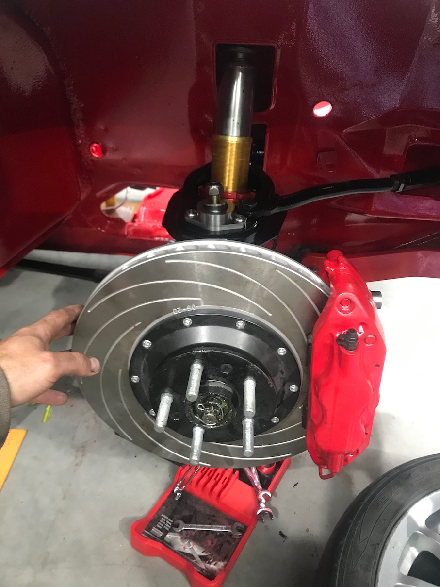

Brakes: front are 147 GTA series 2 Brembos (330mm) I thought I would go down the path of using 147 GTA 305mm discs, but these are a different arrangement to the Alfetta and mount from the outside. This loses a lot of wheel well space, so I bit the bullet and went with some Tarox 330mm floating discs. After much stuffing around, I've gotten them on, but I fear they may be too large. I have some AP 4 spots with floating discs as well and will see if these are more suitable when I get down there next.
Rear are vented EB Spares with new calipers.

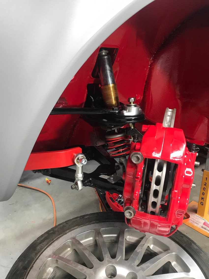

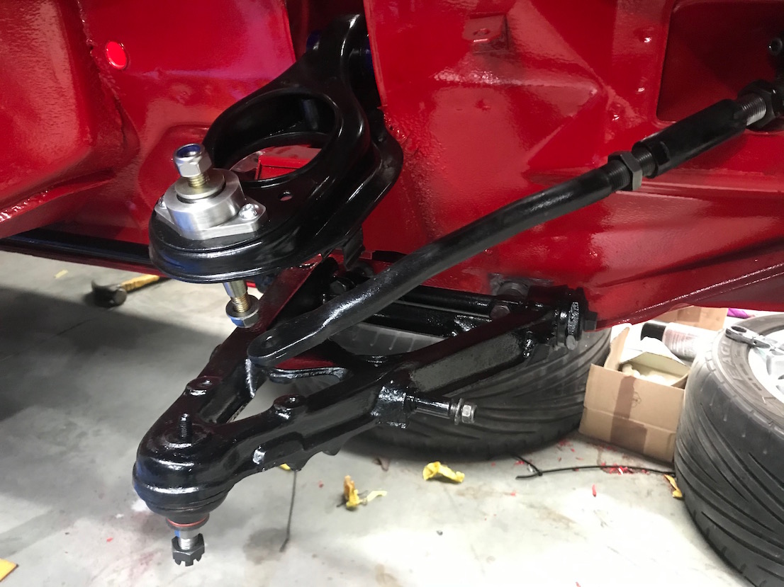

Suspension completely dismantled. New LCA bushes, new poly UCA bushes and EB spares extended pin UCA ball joint for roll centre correction. cleaned and prepped then painted all the arms and the T Bars, reassembled with the RS coilovers, fitted the RS front and rear sway bars with uniball drop links and the RS rose jointed watts link.
Dedion- ground it right back to bare metal in spots and prepped and painted it bush was still great, so avoided using the EB spherical bearing I have. Matching RS rear set up with the shocks and height adjustable springs and perches installed.

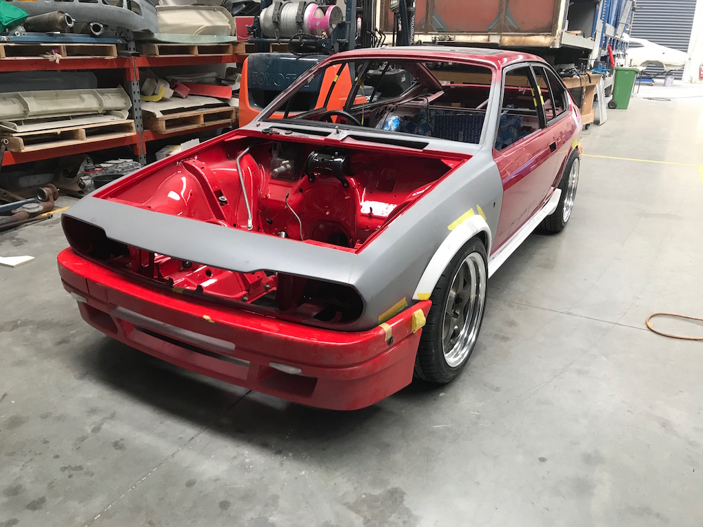

Body was stripped.

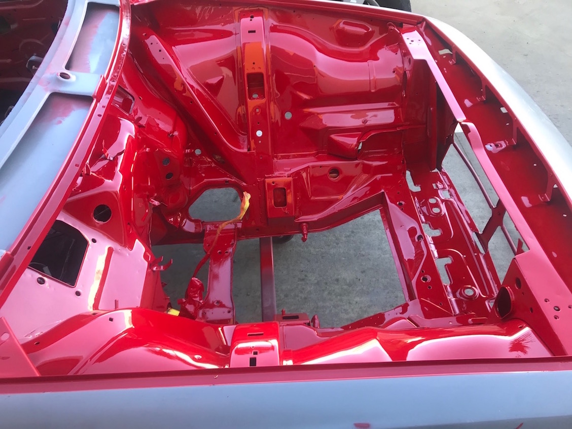

I hit all the rusty spots in the engine bay with a wire wheel on a drill and rust converted them to make the panel beating simpler.

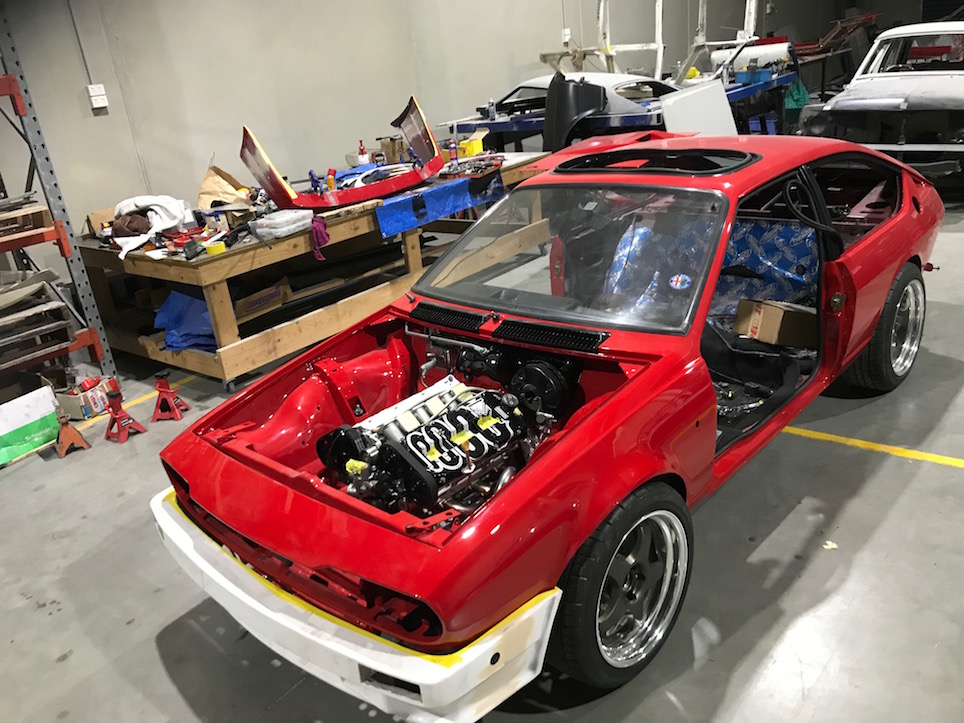

A jig was created using a very straight GTV6 with the engine out. I then cut my old V6 mounts out, as I suspected these may have caused issues with driveline alignment . Also, I was just being a bit anal
New mounts welded in.

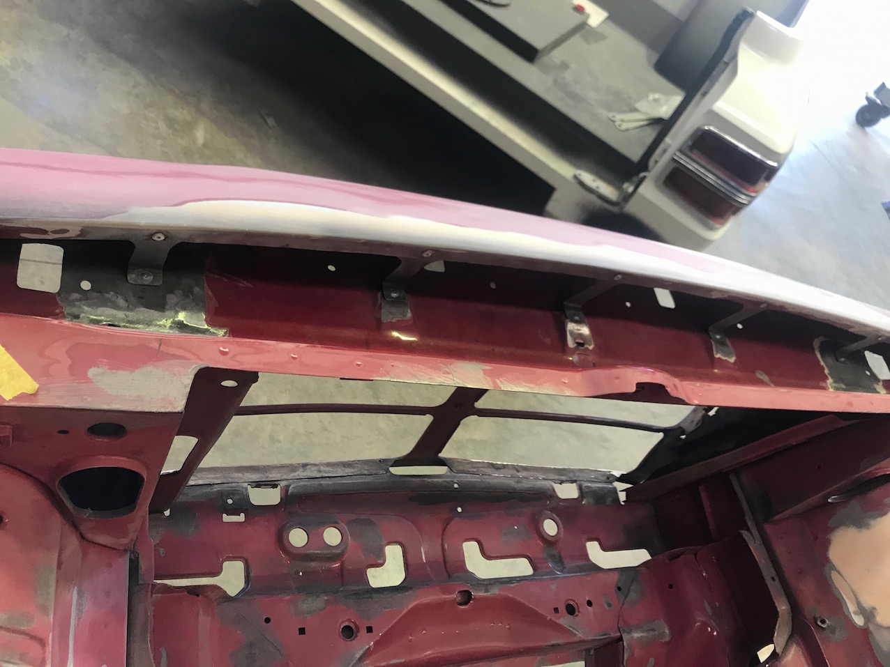

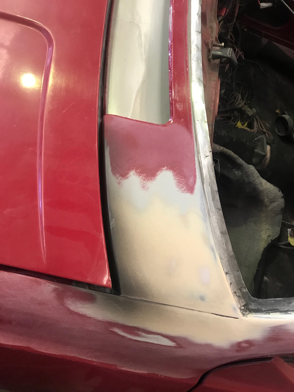

Some bog was found underneath the Windscreen scuttle, so the Panel beater drilled the spot welds out and fixed the whole panel, and created a clearer passageway for water to flow out of. The Tabs that prop up the front nose cone were re-made from wider pieces of metal.

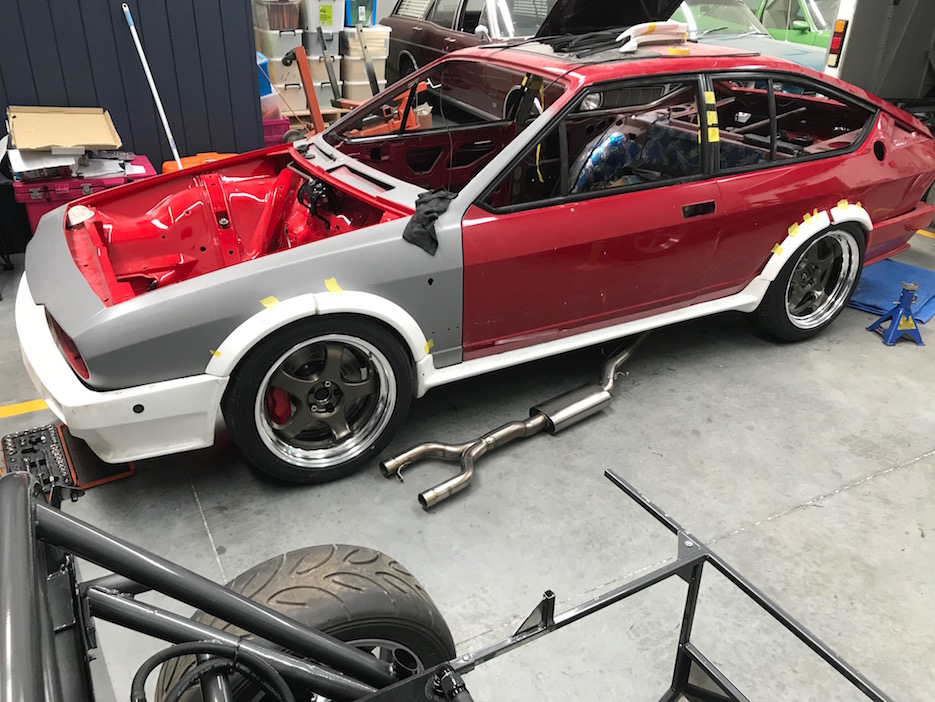

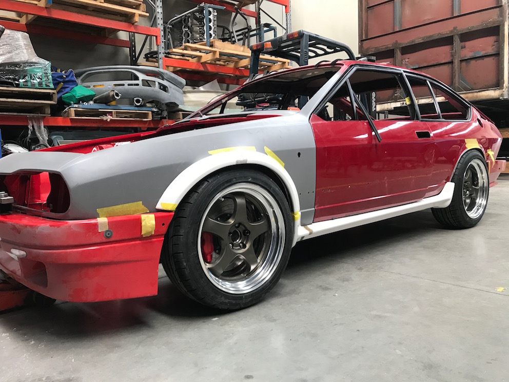

There is no easy way to say it- I cut the guards! The wheels were too wide. I don't care, though- the GP arches will cover it.
The GP Kit arches were horrible and we needed to section and lengthen them. Ive got a 75 EVO bumper as well as the GP bumper to go on.
lots of fiddling making new brackets... I folded them up out of 3mm plate steel. Used Rivnuts on the side mounts, front and rear.
Rivnuts to mount the Side skirts. Just going to Urethane the arch flares on and pray that they don't fall off.... Should be fine hahahaha

Re: My rebuild!
part 1
- Painted bay
- bay painted side.jpg (252.91 KiB) Viewed 14682 times
- Nose Cone Tabs
- Nose Cone.jpg (251.3 KiB) Viewed 14682 times
- Engine Bay with mount jig
- Mount Jig.jpg (248.88 KiB) Viewed 14682 times
- Bay in Primer
- bay primer.jpg (229.1 KiB) Viewed 14682 times

- Painting Suspension 2.jpg (251.89 KiB) Viewed 14682 times
- mask rocker.jpg (253.76 KiB) Viewed 14682 times
- Painting Rockers.jpg (252.28 KiB) Viewed 14682 times
- Rockercoversnake.jpg (250.25 KiB) Viewed 14682 times
- flywheel coupling2.jpg (227.85 KiB) Viewed 14682 times

Re: My rebuild!
4
- Frontscuttle.jpg (213.08 KiB) Viewed 14682 times
- Frontscuttle3.jpg (222.09 KiB) Viewed 14682 times

Re: My rebuild!
5
- front suspension complete.jpg (222.29 KiB) Viewed 14682 times
- front suspension complete2.jpg (214.62 KiB) Viewed 14682 times
- front suspension complete3.jpg (236.16 KiB) Viewed 14682 times
- front suspension complete4.jpg (244.21 KiB) Viewed 14682 times

Re: My rebuild!
6
- Evofitup.jpg (237.91 KiB) Viewed 14682 times
- GPfitup6.jpg (225.18 KiB) Viewed 14682 times
- GPfitup3.jpg (203.33 KiB) Viewed 14682 times
- GPfitup.jpg (213.99 KiB) Viewed 14682 times
- Complete bare bay.jpg (243.29 KiB) Viewed 14682 times

Re: My rebuild!
7
- Camtiming.jpg (243.35 KiB) Viewed 14684 times
- IMG_1284.jpg (237.17 KiB) Viewed 14684 times
- Engine top.jpg (237.16 KiB) Viewed 14684 times

Re: My rebuild!
8
- Russcutting5.jpg (226.19 KiB) Viewed 14683 times
- EngineIncar.jpg (235.3 KiB) Viewed 14683 times
- Bonnet on.jpg (246.36 KiB) Viewed 14683 times

Re: My rebuild!
I also put the EB spares shift linkage rebuild kit through my linkage, and got a bit carried away and had all the locks and strikers electroplated...
- sump cock.jpg (235.36 KiB) Viewed 14683 times
- ShiftLinkage2.jpg (219.38 KiB) Viewed 14683 times
- ShiftLinkage.jpg (221.89 KiB) Viewed 14683 times
- Doorstriker.jpg (232.75 KiB) Viewed 14683 times
Re: My rebuild!
Very nice work.
I really like the valve covers
sumpcock is a nice touch
