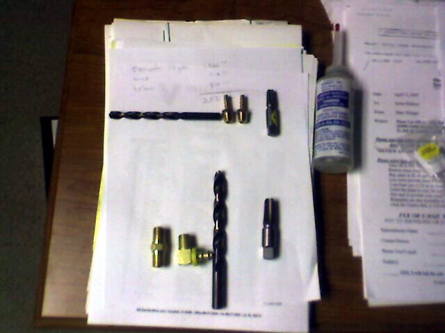

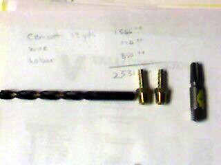

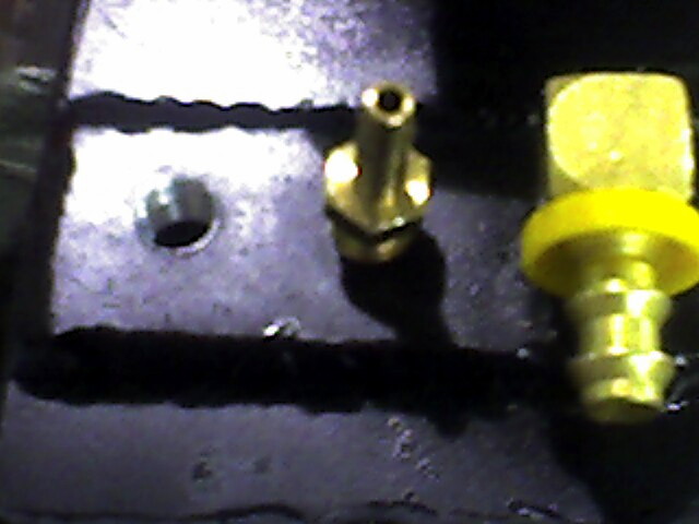

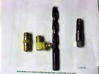

So the weekend is here and I went to look for the tools to complete the plen. set up. Its been along time since we had the speed shop so I forgot how carefully you need to find the right supplier to purchase and measure your bolts correctly. After spending a couple of hours looking for this we determined that for the size for the fitting for the Brake Vacuum hose for the plen. and the size for the fitting for the Oil Seperator for the air intake are the same. JJ gave us the one fitting for the Brake Vacuum hose and we found one that was the same size for the Oil Seperator connection to the air intake pipe.
The drill size is 7/16" and the tap is 1/4" x 18 NPT (National Pipe Tap).
Here is the picture of the connectors and tools for referrence
Alfa Tap Set up #2.JPG (15.2 KiB) Viewed 8829 times

We also were able to find two new connectors that matched the connector that JJ gave us as an example for the Go tech vacuum hose and the Fuel vacuum hose.
The drill size is 21/64" and the tap is 3/16 HB x 18 MPT (Male-National Pipe Tap.)
Here are the pictures for referrence.
Alfa Tap Set up #1.JPG (13.2 KiB) Viewed 8828 times

We finally purchased special oil to cool down the tapping process and make it smoother to accomplish this task without any errors.
Here is the last picture of this. We were all tired from work so we decided to do this tommorow if time permits so to have a fresh start. If anyone has any suggestions on a proceedure to do this let us know. It looks straight forward but of course we have no room for error.
Alfa Tap Set up #3.JPG (53.85 KiB) Viewed 8827 times

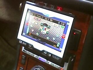

I originally was going to put back the Blaupunk Berlin that would be the correct radio for this time period and have it set up to play MP3's. However, I could go with my Kenwood set up similar to a company car. I don't know why I am still thinking original condition since I changed the seats but what does the Forum think. Modern Kenwood set up (TV/DVD/Back up Camera/Nav) or the Classic Blaupunk Berlin??
Here is a picture of the Kenwood Head and I have already posted the Blaupunk Berlin in a prior post.

cchan,
With drilling and tapping aluminum go easy (it is really soft) and keep the drills and taps square to the hole and steady. Its very easy to wallow out your holes to where the fittings won't seal. See if you can't get the part clamped into a drill press and use the drill press to guide your tap after drilling your hole. (put the tap in the drill chuck and turn it by hand.) Don't tap using the drill motor as it turns too fast, doesn't stop where you want it to, and doesn't reverse.

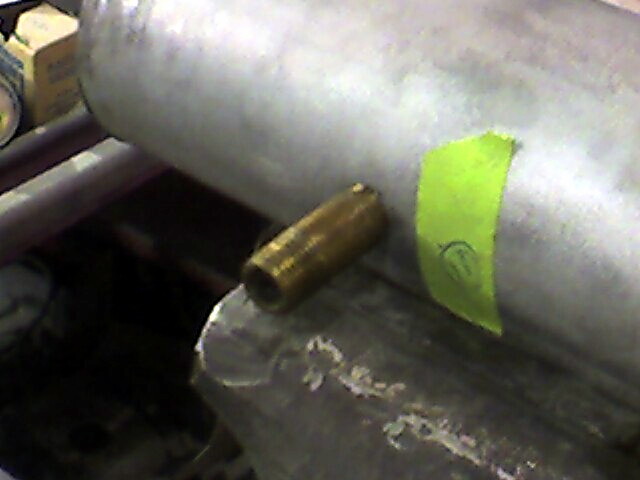

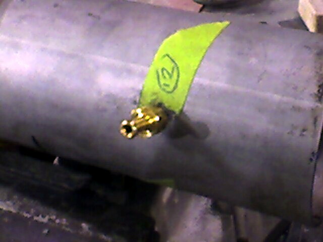

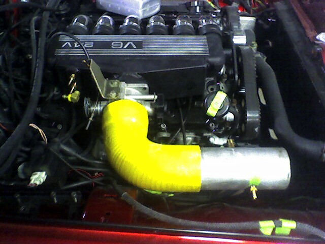

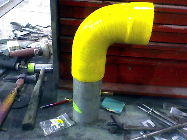

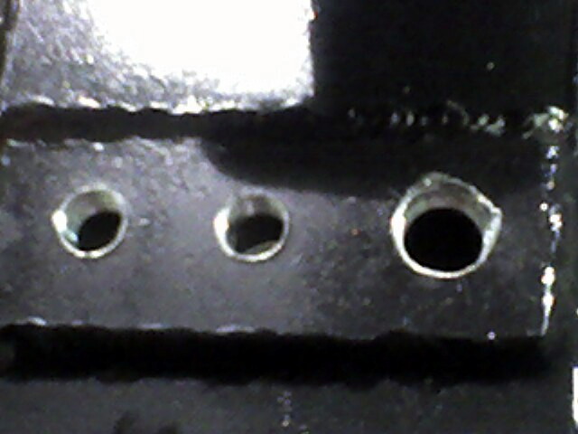

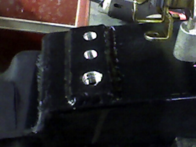

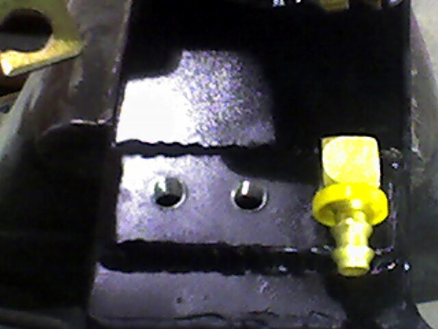

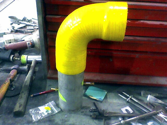

We have been able to complete the tapping and installing the connectors to hook up the engine management hoses. Everything went well and we just need to tighten everything down. I'll wait for JJ to come back to have him suggest how much we need to thread this into the plen. and the air intake pipe. Here are the pictures of the status of this.
Alfa Engine management #5.JPG (49.74 KiB) Viewed 8707 times
Alfa Engine management #4.JPG (83.34 KiB) Viewed 8707 times
Alfa Engine management #3.JPG (80.44 KiB) Viewed 8708 times
Alfa Engine management #2.JPG (45.11 KiB) Viewed 8708 times
Alfa Engine Management #1.JPG (46.16 KiB) Viewed 8709 times

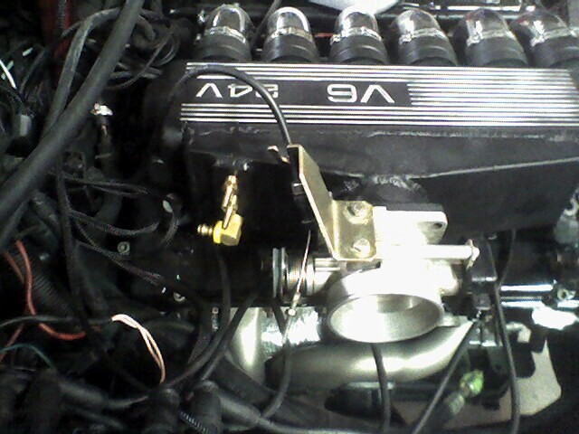

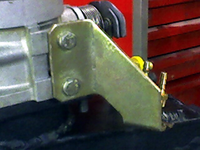

We also needed to tweek the throttle mount and bend it upwards so that the cable will attach correctly. Once we did this we then noticed that the stock throttle cable will not work and we need to source a new one to connect properly. This should be no problem but is one more detail that we were not aware of. Here are more pictures.

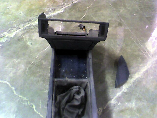

The only last connection we need to do is the Air Temp sensor. We will Drill a hole and place this on the side of the air intake up stream from the oil seperator and this will complete this part of the system. Then all we need to do is hook up the tubing and were done.

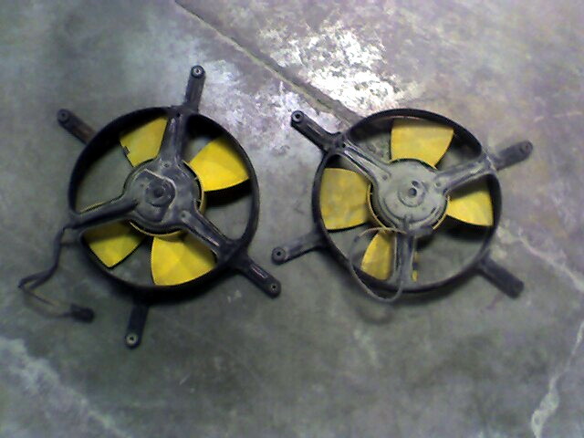

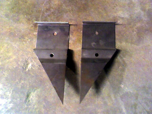

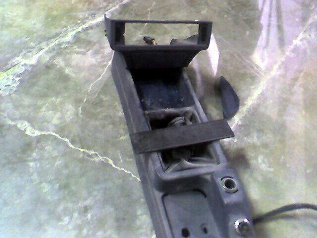

Now that this is almost finished we are going to start doing the center console and restore it so that we can have a sound system in the Alfa. JJ also gave us some reinforcements for the front sway bar to have them welded on. We will be doing this next along with testing, painting, and restoring my fans.
This is where we are at now. The seats should be done by now and I will stop by and drop off the center console this Friday. I hope to have some pictures of the interior to post then. If everything goes right, we will have the Alfa running and dyno tuned next week and have the interior finished as well.
Alfa Reforcements for front sway bar.JPG (78.16 KiB) Viewed 8703 times

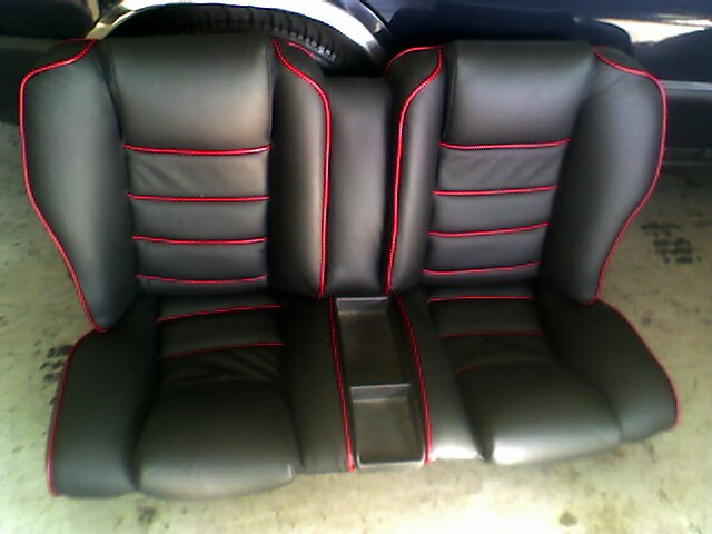

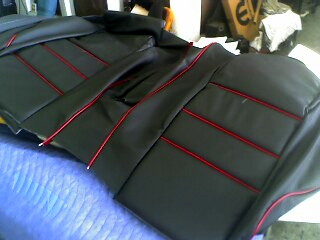

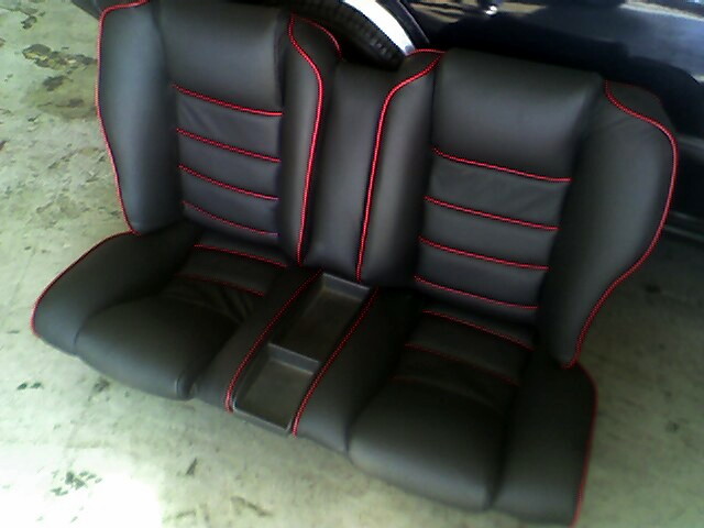

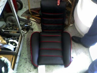

So it's Friday and I went to look at the seats. Things are moving ahead slowly and the sear seats are done. We just need to recondition the plastic insert tray. Here are some pictures of the rear seats. The front seats were not quite done as there was a small issue. This will be taken cared of and I will post pictures when I go there again.
Alfa Restored Seats #2.JPG (53.8 KiB) Viewed 8657 times
Alfa Rear Seats Restored #1.JPG (56.88 KiB) Viewed 8654 times
