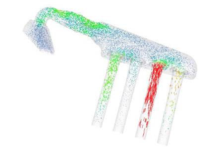

Engine long block works isn't really moving but the parts around it is:
Youtube link, Plenum Simulations
Never mind the graphics at the bend in between the IC tank and the TB, the time that went in to the mesh in that area was low.

Re: Mats Strandberg (SWE)
Very very nice! I guess that's an advantage of working on the automotive industry.... :D
Post by MALDI »
First and foremost, thanks for posting! You do the BB credit.
Now some friendly, naive questions:
The runners aren't long and straight like that, are they? Is the length correct but the topology simplified to ease the computational time? What if the runners were curved, wouldn't that change everything?
:oops:
You're making me blush...
The runners are actually just straight because it doesn't matter computational wise unless you're very interested in what is happening in the valve area, so you are right. They were actually modeled true to begin with but it was concluded that they would work equally well if straight. The volume is the same and a "valve model" added at the end. All cam data is from my cams and the Throttle body is indeed a model of the 75 TS unit that I will use.
I added an intercooler tank and the pipe because there were thoughts about using secondary resonance to try to lower lag ( :shock: ) but once I communicated that I use it from 5000rpm and up we put that aside. :lol:
Now I only have to fabricate the damn thing... :wink:

:shock: again .. very cool tools you've got within reach :P
Maybe a 155/164 ts plenum a good starting point/ short cut?

Thanks for the nice comments. :)
Maurizio: I'm just whining, you know I have it all in CAD, just plot it 1:1 and trace it in alu, pipes are easy. Lenght and cut quarters. :)
