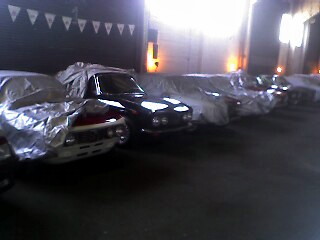

I ran into my old friend and client the other day and shared with him my project. I knew him for over 18 year on and off but I did not realize that he also collected Alfa's. I could not believe his storage area. He has over 15 Alfa's that are actually all in good running order. Mostly GTV's along with a GTV6, Alfetta, and 164 Quad. We have been tring to decide who will assist us with the final mechanical issues and we have decided to use his consultant to help us complete the job. Here is a picture of his Alfa's.

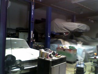

We were also able to get the lifts installed. We installed 1 lift outside and two inside since this is how my associate wanted to have his set up. I wish we had this installed earlier to help JJ but at least we have them now. Here is the shop now. It is going to be alot easier to complete this project now. Here is our new lifts.

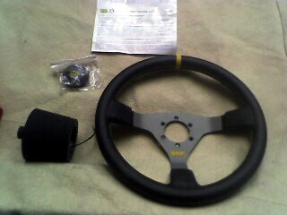

Finally, we were going to install the new steering wheel to complete this part. JJ sold me this steering wheel along with an extention. I forgot the extention part at the warehouse so we could not do this today. The bay bridge is closed so needless to say traffic is not at its best so I did not want to go back and get it.
We were wondering if the extension is worth it to correct the steering wheel set up. I was wondering what others have done in terms of this extention. Try to set the steering for a more American setup or stay with the original steering position. Any suggestions would be appreciated. Here is a picture of the new steering wheel.
- New Steering Wheel.JPG (18.02 KiB) Viewed 7892 times
I have a long extension and a deep dish wheel (90mm) to get it as far back as I want it, still need about an inch or so to get it perfect.

Thanks for the pictures of your extension Alfettish, mine is exactly the same. I like your right hand drive Alfa. Your interior is really clean as well. Really Cool.
