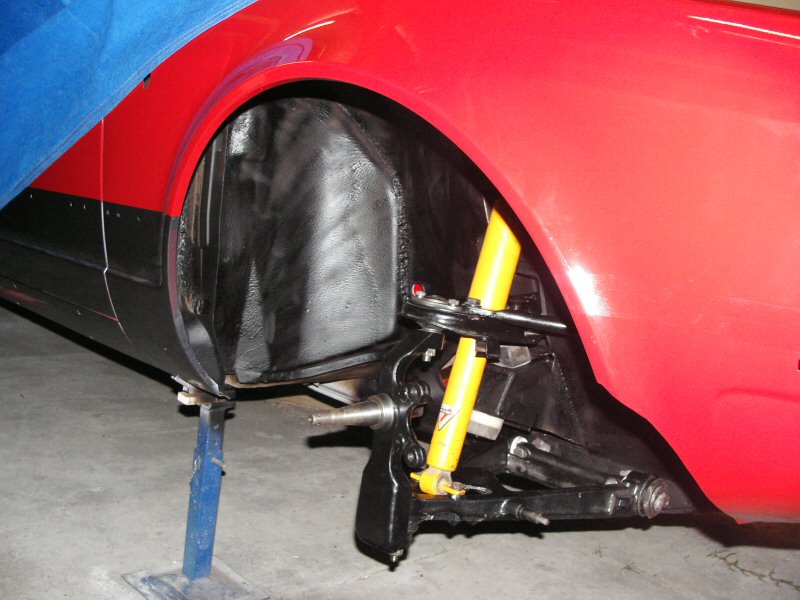

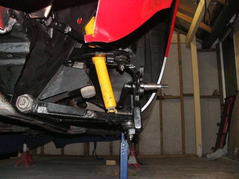

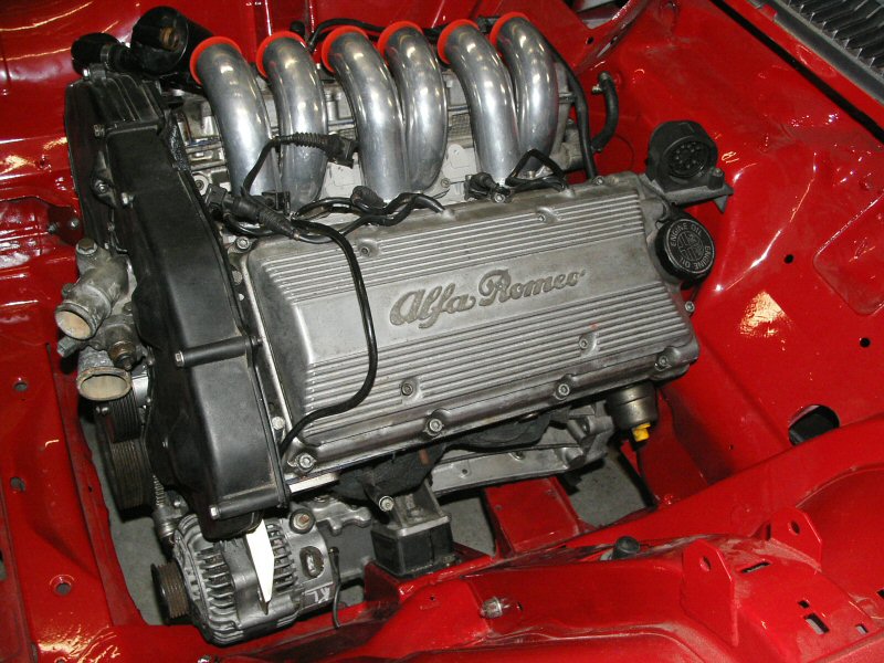

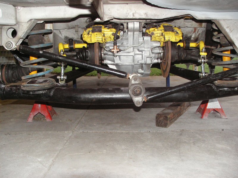

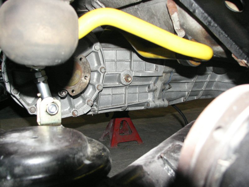

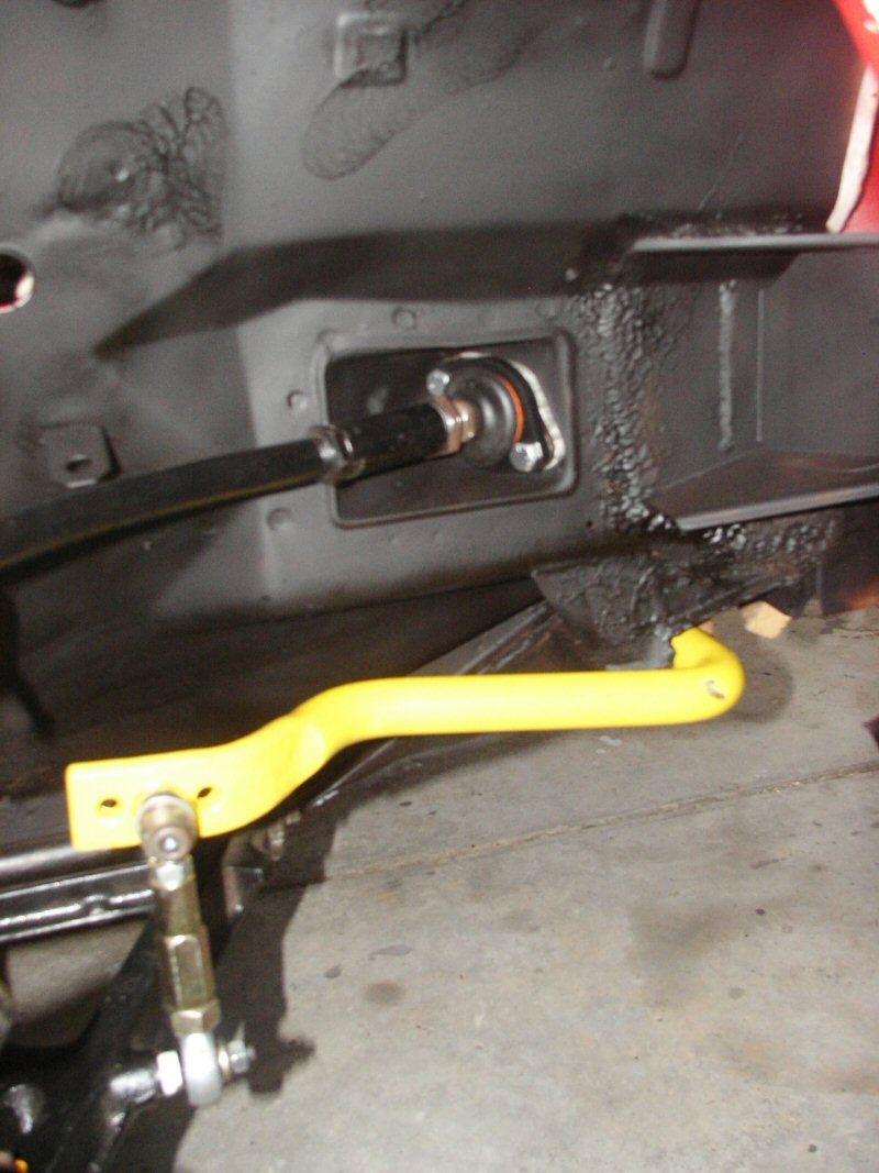

Waaaaaaaaay too long since any real progress, so....
Today the engine and driveline went in !!! :D :D :D :D :D :D :D :D :D
Front suspension (less T bars) is also in and the drop spindles do wonders for the camber gain.
A few pics to get started (I have 2 more days off work to get a sh1tload more done) 8)
The 24v heart in its natural resting position
08-01-13 004.jpg (129.87 KiB) Viewed 9359 times
Trans & rear AR bar
Trans & rear AR bar
08-01-13 005.jpg (89.82 KiB) Viewed 9360 times
Front Left
Front Left
08-01-06 006.jpg (96.47 KiB) Viewed 9363 times
Front Right
Front Right
08-01-06 011.jpg (93.34 KiB) Viewed 9366 times

Hey Dan, where did you get those drop spindles?? custom made?
:D
Daniel
Posts: 276
Joined: Sat Apr 23, 2005 11:12 pm
Post by Daniel »
Like almost everything else on my car - custom made by me.
It's easy to do if you have access to the right equipment.

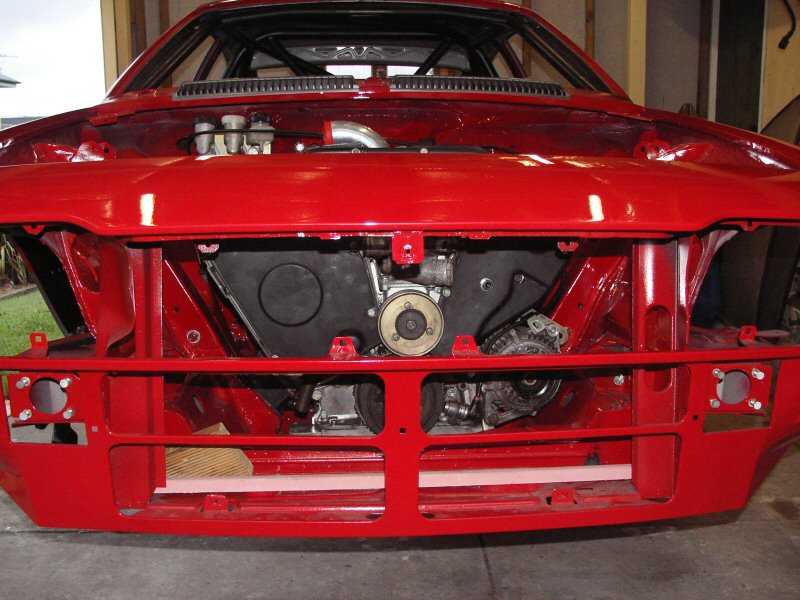

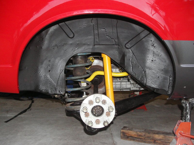

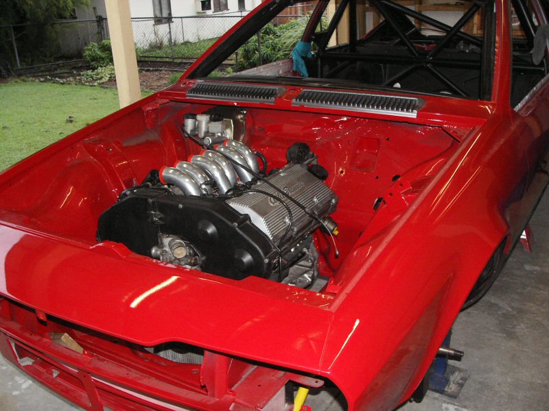

Here's some more shots of the weekend's progress - the whole driveline is in, as is the suspension.
Front Right
Front Right
08-01-15 023.jpg (121.12 KiB) Viewed 9244 times
Rear Right
Rear Right
08-01-15 005.jpg (106.36 KiB) Viewed 9243 times
Transaxle
Transaxle
08-01-15 007.jpg (115.1 KiB) Viewed 9243 times
Front end
Front end
08-01-15 008.jpg (113.05 KiB) Viewed 9243 times
Engine in !
Engine in !
08-01-15 001.jpg (114.89 KiB) Viewed 9244 times
