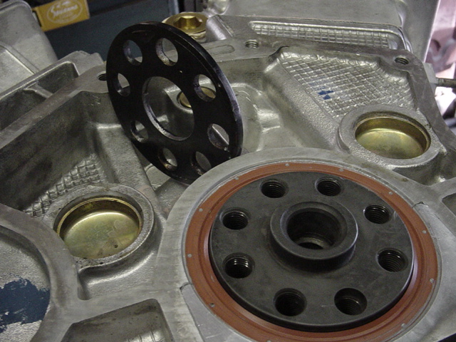

I will tentatively say yes to the question about the 2.5l bell housing mounting right up to the 3l 24v, as it would appear to be the only way to adapt the motor to the gtv6 chassis. However, I am still waiting to hear a second iteration of this from another person who popped the 24v into a gtv6 (just in case!).
You will need this 4mm spacer, pictured below, to use the stock gtv6 flywheel, and hence the transaxle setup, and also the starter mounts will need to be changed to use the newer started motor. This mod is highlighted here: http://www.alfagtv6.com/bb/viewtopic.ph ... r&start=30.
