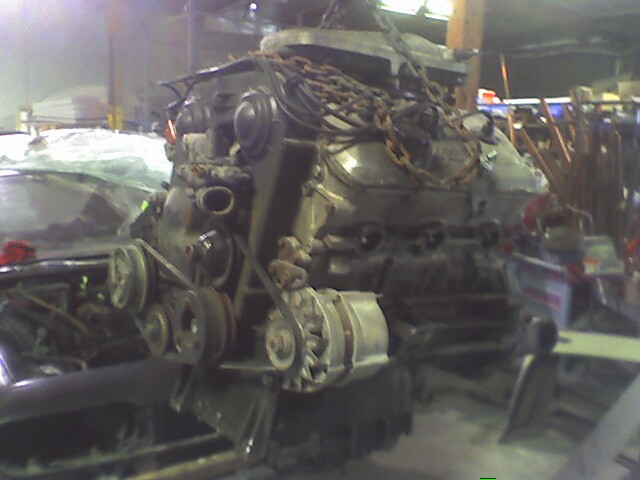

Hi Everyone,

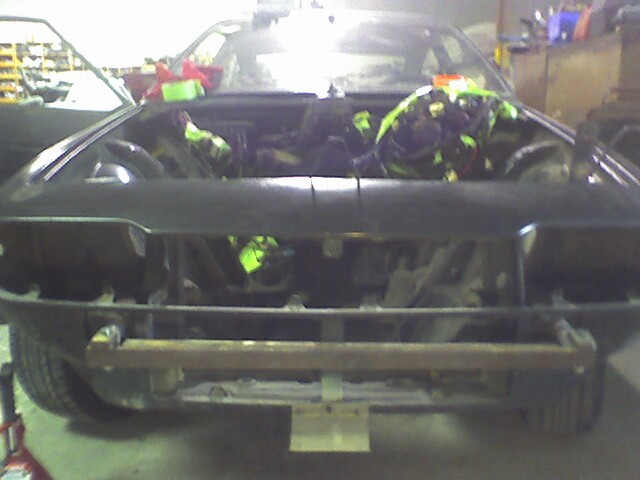

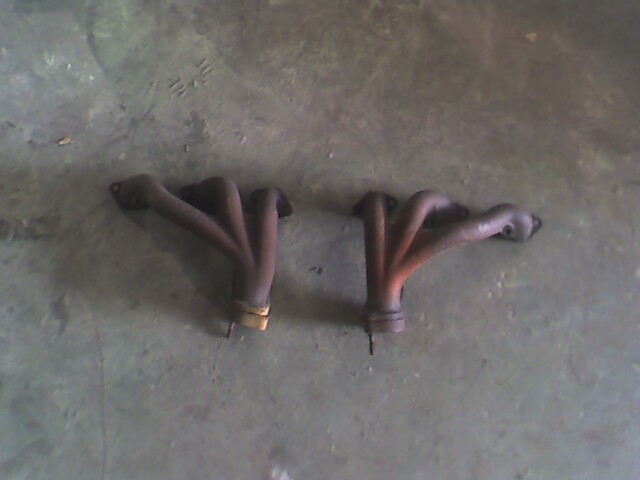

Well we worked on the car today and were able to get the engine almost out. We did the following:
1). removed the main harnes for the injector.
2). removed the secondary harnes for the injectors.
3). removed the headers.
4). removed the 3 bolts that connected the drive shaft to the rubber donut connected to the flywheel.
5). removed the mounts on the rear housing that held the engine to the chasis & exhaust.
6). removed the motor mounts.
We then hooked it up the the engine puller and &*%#, we could not get it out. I ordered the Shop Book for the GTV6 Last week and we should get it next Tuesday. It was suggested that I get this by my associate since he said we don't know much about an Alfa. I wish we had the book today. Anyway, what happened. The engine was stuck and the drive shaft did not come out of the donut. Also, it appears that the top of the flywheel cover that we did not remove. (Only removed the black cover per the suggestion of this forum). was hitting on the engine wall. Did not want to force anything we stopped. ( I was tempted to use my favorite tool, the sledge hammer).
So I was hoping for some more suggestions. It was mentioned that this would be easy but I guess that's relative. We never removed an Alfa engine and trust me, we were frustrated so we stopped and worked on another project. My questions is do we have to remove the drive shaft before we remove the engine?? It appears to remove the drive shaft one has to remove the entire exhaust system first. Once this was done there is a back connection to the rear end that is held to a rubber donut. There is also a middle section with another middle donut?? Thats up with these donuts anyway? What is the correct way to disconnect this system??
Finally, do I need to remove the top flywheel cover to remove the engine? It looks very tight and I hope this is not the case. Maybe someone can point me to the place in the Forum that discusses this proceedure. Maybe I am wrong altogether on how to take out the engine and someone can point me it the right direction. I apprecate the input and I am posting the progress pictures today. I am also showing a picture of the Zender Kit that has been prepared for painting for anyone who wants to see what it looks like off the car.

Thanks for the input. I just finished looking at the engine forum section and see that other members asked this question as well. Guess I have no choice and will remove the exhaust sytem and the drive train. Next weekend will deal with this. The exhaust is rusted alot so I hope we can do this. I noticed that it is suggested that the rear wheels are jacked up for the engine removal and I don't understand why. Can some one explain this to me.
Did not see any specific proceedure on removing the drive train. Please help me on this area if possible.

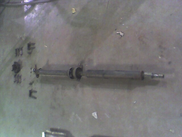

Drive Shaft Removal't
Ok, found the drive shaft removal in the tech section. Don't need help anymore on proceedure. Thank God there is this Forum. Should of read this yesterday.

Hello Everyone,

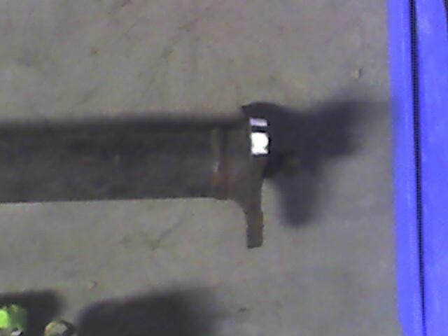

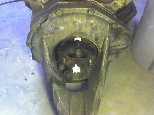

I worked on my Alfa project today and I really like to Thank Michael for his great instructions on the draftshaft removal. This along with the 2.5/3.0 GTV/Milano Service Manual solved all our issues. I think that Michael's instructions were most helpful and I think the Service Manual is for the wrong car. The only thing that was different was my bell housing plate only had 4 bolts and only one piece. We also took off the middle bolt on the dion plate so there was 7 bolts. It turned out we did not need to take out the middle one. The exhaust sytem was actually easier than we thought. The car in now ready to be stand blasted and we are comtemplating how to detail the suspension and the undercarriage. The rear suspenion in now hanging so we may remove this next week. I am posting pictures. I love my Alfa.

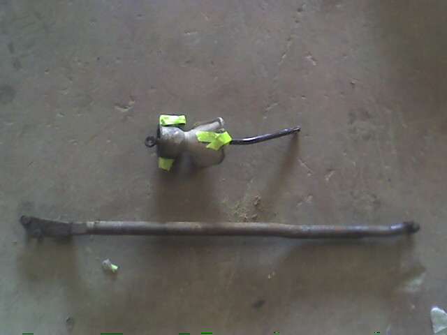

More Pictures

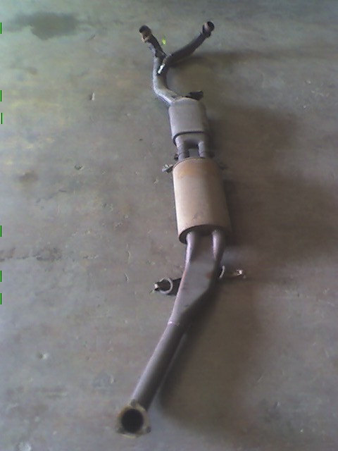

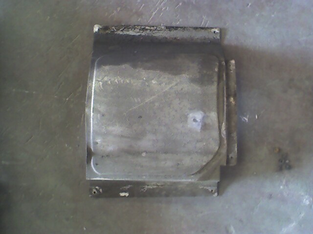

Here are more status pictures
- Alfa Engine Compartment #2.JPG (93.11 KiB) Viewed 12604 times
- Alfa Engine Front.JPG (68.64 KiB) Viewed 12604 times
- Alfa Exhaust System.JPG (40.98 KiB) Viewed 12607 times
- Alfa Gear shift mechanism.JPG (39.97 KiB) Viewed 12606 times
- Alfa Heat Shield.JPG (48.66 KiB) Viewed 12606 times

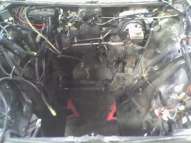

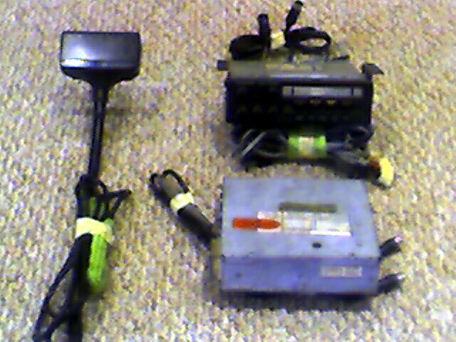

Hello Everyone,
Worked on the Alfa alittle today since my first appointment did not take as long as I thought.
We have secured all the wiring in the engine housing as well as removed all the air conditioning stuff. I removed the Blaupaunk radio system and secured all the stereo harness but left the amp in since it seemed in a safe location. We secured the ECU box so it will not get damaged on the stand blasting proceedure. The windshield is free but did not take it out completely since we need to clear a safe place for this. Don't want to break it.
We are going to brain storm on the the underneath of the car. I might as well restore the dion rear along with the front suspension as well. I am hesitant to dismantle this since it seems like alot of work. However, if we are going to paint this area we need to figure out the easiest and safest way to accomplish this. Any Suggestions??
We have also decided not to put a cap for the dash but rather remove it completely and have it professional restored since it is cracked in 4 places. Before we do this I was wondering if anyone has any experience on this? I did not look at the manual that I purchased but I think It does not show the GTV6 dash, only the Milano dash. I have looked in the Forum but I might of missed this. Any suggestions where to look or pitfalls to be aware of I would really appreciate it.
Last Questions that we have. Does anyone know where you can get the sound proofing for the rear of the engine compartment? I need to get this and I was hoping to have the stock part rather than have it custom made.
I am attaching some photos of todays progress and hope to work on my alfa again next weekend.
Thanks for all your help.

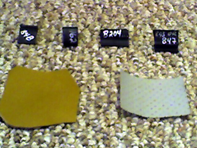

Hello Everyone,
I just recevied in the samples for the interior leather for the seat pull overs & all the rubber parts that I need for my Alfa. I am so happy since I thought that these would not be available.
I am thinking that I will restore with Custom Red paint & tan interior. The other option is a black interior. Any thoughts or suggestions on my color combination??
I am getting this from a vender called Re-Originals. Does any one have any experience with this company?

Have a great day and thanks for any futher suggestions as I work forward on the restoration of my Alfa. I have attached a photo of my samples to share this with everyone.
