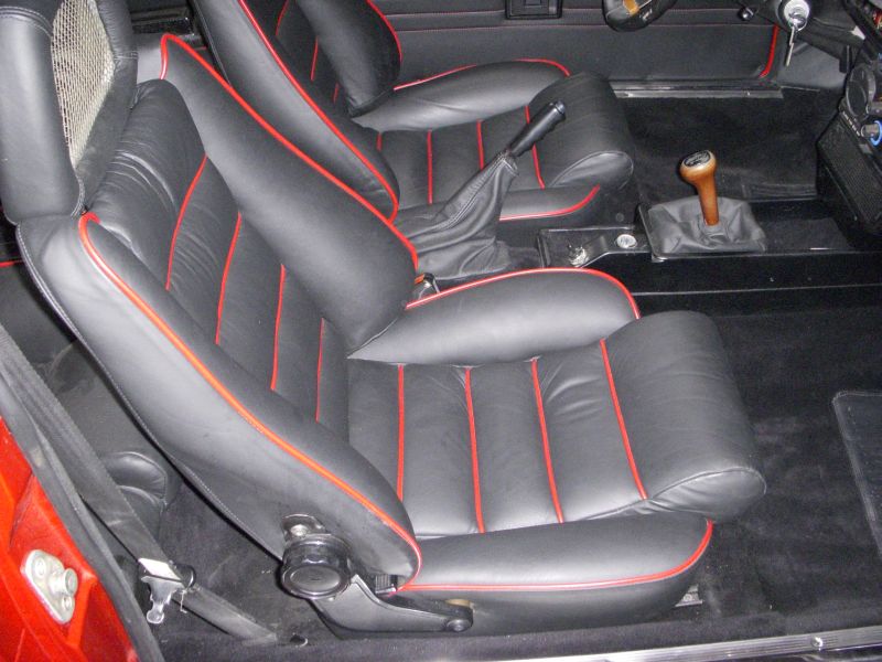

Had a chance to warm up the engine and take some shots of the interior today. I wanted to share this as promised. The interior still needs to be detailed and we did not get a chance to put on the new steering wheel yet. We need to source the extra bolts for the extension.
The Alfa is being put into storage for the winter. We will be towing the Alfa back to the warehouse in the next couple of months to complete the final detailing of the body and take care of the electrical issues. Here are some pictures and please disregard the dust. Thanks again for watching this thread and thanks to everyone who helped our team make this restoration/modification possible. We are basically done with this project for now and will post the final dyno tune results next year.

really sharp!!! Those seats look very comfortable!!!
Nice headliner. :)
That's nice!
I wouldn't put that up for more than 5 minutes....I'd be going somewhere / anywhere all the time. At least till my gas money ran out :D .

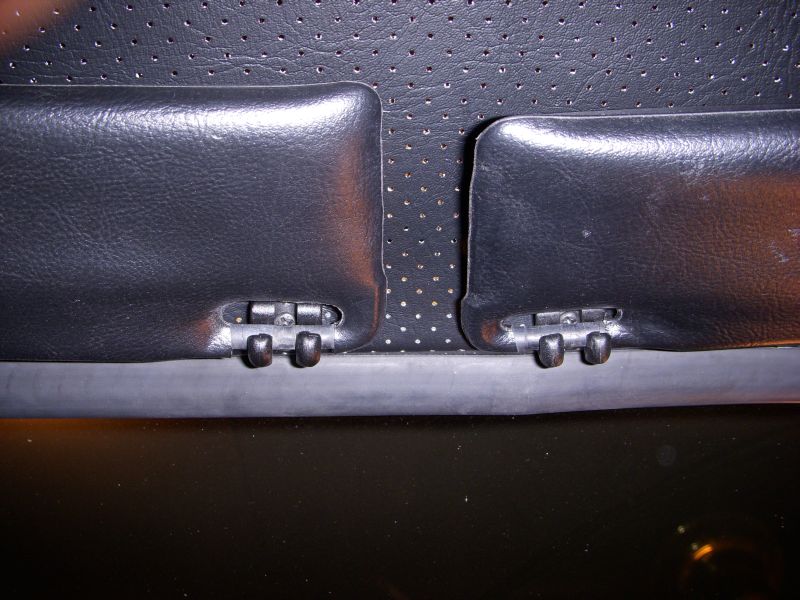

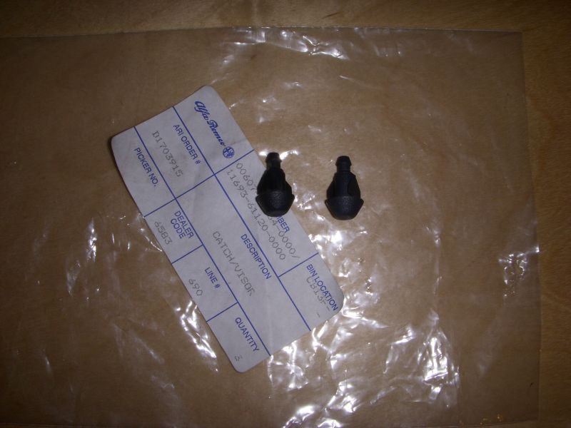

We were able to find though John Norman at Alfa Parts new sun visor clips, and windshield nozzles. We installed the new clips so that the sun visors are correct and do not hang down anymore. Hopefully, John can get me the bracket to hold down the hood and the rear window door knobs.

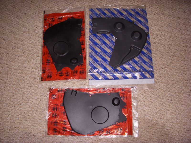

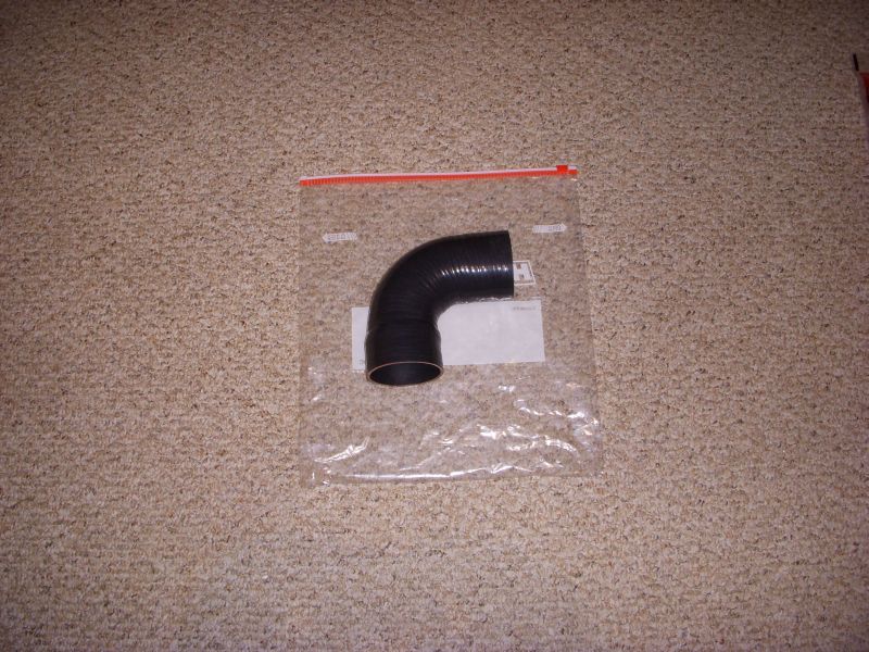

We also found the timing covers and will be installing this shortly since we do not want to have any problems that may occur by not having these installed. Finally, we decided to change the intake tube from Yellow to Black to better match our engine compartment. We will be looking around to find the hardware to install this. Here are some pictures of the progress.

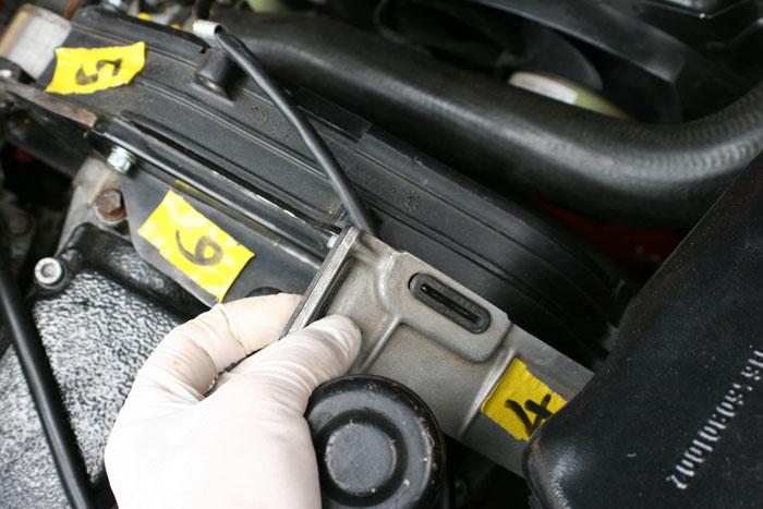

Cchan , have you got all the rest of the pieces to put the timing cover on. Should be three other pieces which go on sides and top. I have those pieces but not the the cover and will probably stay that way for another race season. Earlier in the post i mentioned a chap got a stone in his belts which led to drama but I did not not mention this was a front wheel drive GTA where it is far easier to pickup a stone from the wheels. The more I look at it the more impossible it is to get a stone into the belts if the 24v motor is mounted into 116 series. Its usually the small washer or nut that drops down when working carelessly that will catch you out.
If you put all the top covers on what about the bottom ones around the pulley?
Speaking of coolant bottles, the last three brand new ones I bought from Alfa lasted exactly fifteen minutes (on three seperate GTV's). As soon as the water got hot it melted the crappy glue on the seam and sprayed out.
I did notice these new bottles were made differently to the origional ones as the seam was butt jointed and an overlap joint like on the old ones.
I dont know who Alfa subcontracted to, to make these but it was a total disaster for the big batch that came to S.A. Hence i use the ugly out of place 164 bottles.

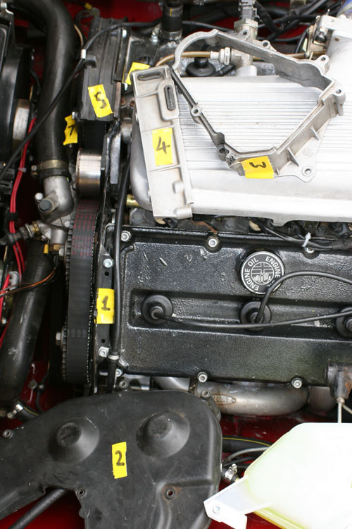

A few people have PM me on what is needed to put the timing covers on. Hopefully this pic comes out clearly showing all the labelled bits. I just took the cover off for belt tension inspection. This cover can only be removed without removing water pipes if you use short bolts to hold the cover on around the thermostat area. The other loose pieces on the engine are from another 24v ie the aluminium bracket that goes around the thermostat housing.
Another pic of 4 joins to 5 below.
