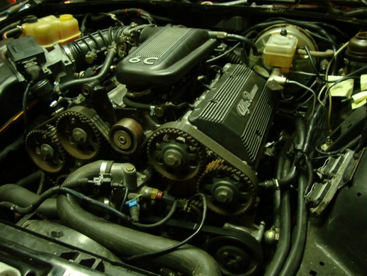

Latest pic of engine room was during wiring. Forgot to take new shots...
Resize of DSC00364.JPG (87.45 KiB) Viewed 14203 times
Re: Helloo from Serbia! (My 24v conversion)
Which Air flow meter are you using?

It's std Motronic 1.7 but I modified slightly original air filter housing to fit it. :) I hope I will switch to Vems soon...
