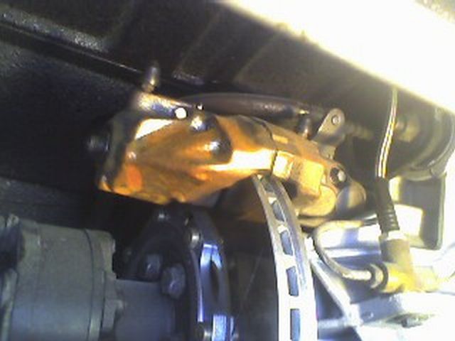

The last thing that we noticed is that the rear Giro Disk SZ Brake Calipers are rusting already? We are not sure why they would rust so fast. Has anyone experienced this as well? Should they be rust coated from the start or should we do something to correct this? (ie: remove, paint, powder coat, etc). Any suggests are welcomed.

The rear calipers, you have are stock alfa calipers with a spacer between the halves to house thicker ventilated disc. Unlike the fronts, rear calpiers are cast iron, so uless they are coated, in anything rust preventing they'll eventually rust, which except for aesthetics, won't affect anything.

Thanks for the posts, The oil is on the wrong side so it is most likely some type of leak. Now that we are aware of this we will figure it out by keeping an eye on it and determine what we need to do to address this.
In regards to the rear brake caliper rusting, we don't want any item rusting on the Alfa. What would be the best way to deal with this. Rust paint, power coat, or ceramic coating?

For oil leaks start at the tappet covers where the two half moon rubbers go over the cam shaft, next the oil breather . Sometimes the filler cap does not seal espicially if its relocated above a camshaft lobe. New o ring sorts that out. Other than this and the rear oil seal these engines dont leak. Wipe all arounf the engine ,go for drive if steering fixed then recheck with soft tissue paper. Dont worry about rear caliper. If you are not going to remove it use small brush with rust primer. Mine once rusted to i repainted them which looked good until i bled the brakes at the track(without pipe) and the paint came off. Choose your coatings carefully.

You can use everything from cheap brake caliper paint, to galvanizing. I think the latter should have longest lasting results

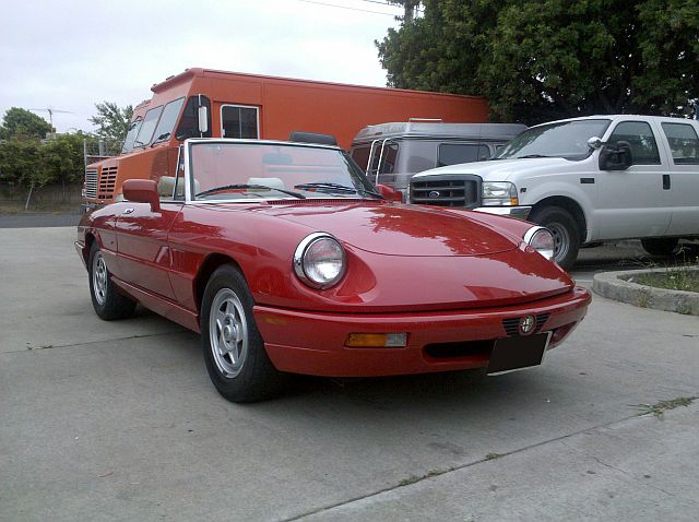

The Alfa GTV6 Project probally has less than 700 miles on it but we are going to Tow it to the warehouse to trouble shoot the clutch and take care of the other break in issues. They are the small oil leak in the front, remove and re-coat the rear calipers so they are not rusting, remove the exhaust system and install the flanges as well as coat the pipes so that they will not rust, and install the timing belt cover. So it appears that this is the end of the fun for this year in the GTV6.
However, being the Alfisti that we are. We purchased another toy for the Monterey weekend. I know it is not a GTV6 but it still is an Alfa. It is a 91 S4 spyder and we are currently doing a minor restoration as a driver. We went with the last years model in hopes that it will be reliable. This will be the Alfa for the rest of the summer.
Here are some pictures of it as of today.

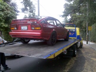

Must be either the clutch slave
or leaking internally from the clutch master cylinder (was that replaced on your rebuild?) if that it would leak into the passenger compartment and you'd never see a drip on the ground. GV

cchan, One one of my GTV's the clutch is quite high and builds up pressure(need a gap a top of pedal). This under heat ie few laps the clutch beginns to activate and start to smoke. Trick was to loosen slave bleed nipple and relieve pressure then ok for rest of track day. This car was not driven much from when the clutch was assembled and origionaly bled. Then it was used under excessive heat conditions - maybe like yours.
Suggestion , new kit installed check pedal not 95% to top, then use it with hard driving. Then tap of pressure (just an open the close of bleed nipple) with clutch pedal at top.
