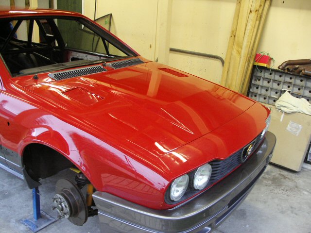

Here's some more pics of a little more progress.
I put the bonnet on and found that the Motronic's AFM didn't want to fit under it - the AFM on a 24v is way bigger than a 12v. So aftermarket management it is. Still throwing ideas around - thanks for the input and advice Mef, Brian & Baz.

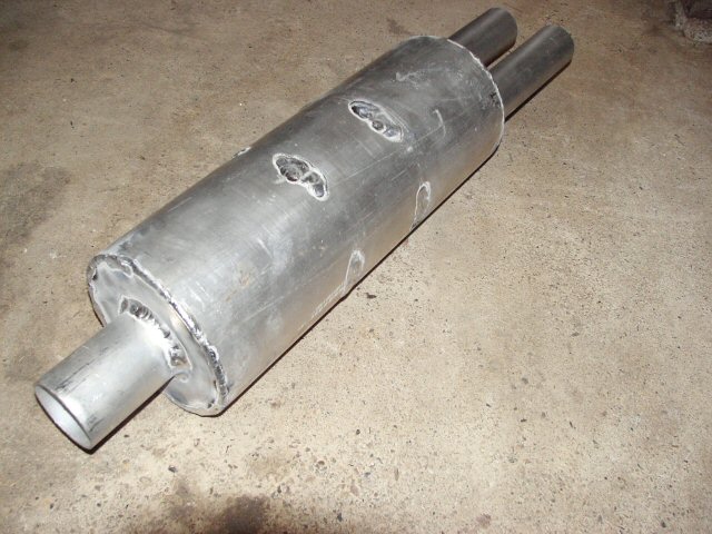

The muffler is one of 2 that I made for the rear. It is 2.5" in and twin 2" out. The system will run a 2.5" pipe per bank with an X pipe in it, maybe with a twin in/twin out 2.5" straight through centre muffler, back to the 2 rear mufflers and out of the four 2" tips. Catalytic converters are compulsory here for a road car, so these will be on the car at inspection time. :wink:
I will take more pics as I progress with it and probably stick them in the exhaust topic.

Rear Muffler
Rear Muffler

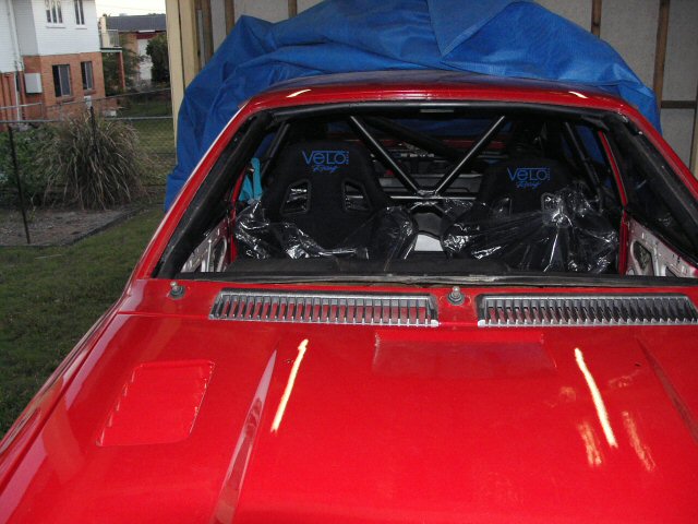

Did some muffler testing on the weekend - used a mates Mazda MX5 with straight thru 2.25" system.
This car is pretty lolud at full noise. Stuck one of my mufflers on the back and made a huge difference. I think I'll leave the centre muffler out of my system when I do it.

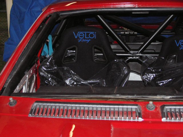

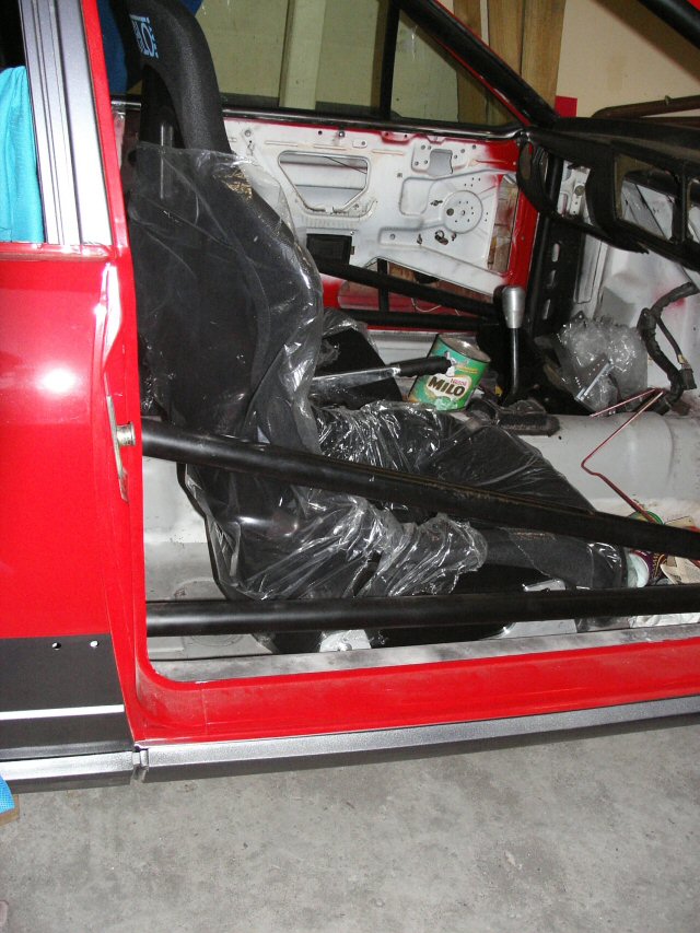

Also got a set of seats, they are about 6kg each against the original seats 20+ kg each, now I neet to fit them. Looks like the standard mount points will have to have their spot welds drilled and be relocated.
08-08-10 001.jpg (73.21 KiB) Viewed 7969 times

Milo tin may become my oil catch can ;P
08-08-10 003.jpg (128.12 KiB) Viewed 7959 times

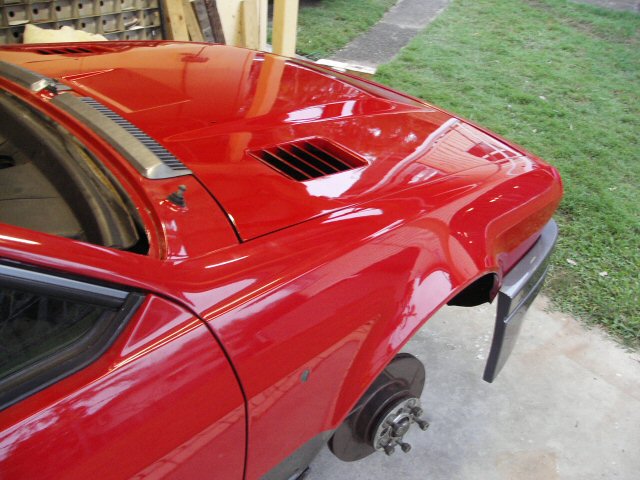

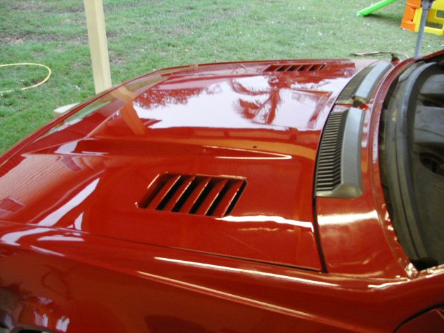

Great. I really love the hood vents. Custom job? :)
Re: Daniel's 24v
Hmm, I've seen that design before...
O yeah, on my hood. :)
Your looks nicer being flush and all.

Hey, nice vents Mats but I actually hadn't seen yours when I made mine (a couple of years ago now)
There is some evil itb engined thing (in the UK I think) with a fibreglass bonnet that has 4 vents - 2 at the front, 2 rear. I saw pics of it years back and liked the idea.
Daniel
Posts: 276
Re: Daniel's 24v
Post by Daniel »
This is the bonnet that I wanted :shock:
viewtopic.php?f=21&t=3180
I'll settle for my custom steel one for the time being

Can you give some more info on your muffler's internal? Is it a standard straightflow or does it have some chambers or a combination of chambers and straightflow. I'm looking for a muffler which can cancel the lower frequencies. Read up some patents on it and it's quite doable.

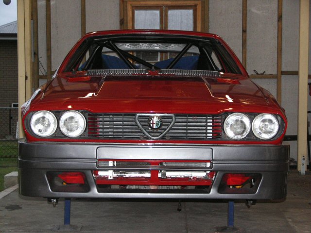

Muffler testing - is that what its called in Oz !! Car looks very stylish with the way you have done the bonnet and with those bumpers. Better than the bonnet on the 3.7l of Dawie's.

Thanks, I like the look that has come together with the bumpers and bonnet - not too overstated.
Do you think that it's a bit of a givaway that it isn't stock anymore ? Maybe the 4 two inch pipes out the back will do that. :wink:
