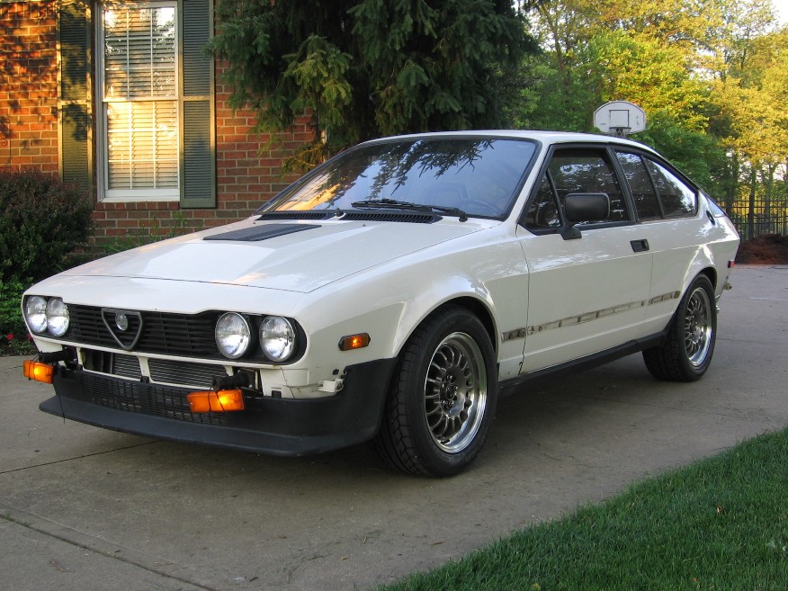

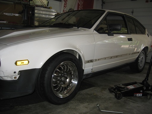

Bought one test tire 225 50 15 for fitting. I know it fits the rear..just worried about the front. Anyway, popped one on this am and it looks good. Plenty of room under fender lip while the wheel is straight. On a curve, hitting a big bump will probably cause a little rubbing. But this front end is also lowered.
The 30mm offset helps move the wheel back, but the 225 width moves it back out some. will test later for inner rubbing, but looks like enough room except for tight turns..
So if you like the look of 15's and don;t have brake upgrades, I would recommend this wheel tire size.
ALSO: you will need to get a set of longer barreled lug nuts because the originals will bottom out too soon (need about 5mm longer)
I bought a set of
24 ACORN BULGE CHROME LUG NUTS 12 x 1.5 TOTYOTA BLAZER
from ebay. Work perfectly and you can use a thin walled 3/4 inch socket to put them on.
I bought a set of

Re: xrad's gtv6
oh yeah...my speedometer also started working after a little cruise around the town!

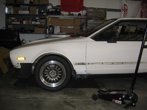

shipped from hayward california, but these are drop shipped from warehouses all over the world.
went out for a tough ride today, tight turns, big bumps, train tracks, pot holes..
I really looked closely at the new tire and wheel wells, NO rubbing areas seen anywhere, inside or out...
7mm inboard placement with the new rims (and then an extra 15mm back out w/225 tire) + ~8mm outboard from stock tire AND radius is about 5mm less. Pretty close but seems fine.
Here is a comparison of sizes (195 v 225)
Stock Tire - 195/60R15 >Search Tires Tire 1 - 225/50R15 >Search Tires
Section Width: 7.67 in 195 mm Section Width: 8.85 in 225 mm
Rim Diameter: 15 in 381 mm Rim Diameter: 15 in 381 mm
Rim Width Range: 4.5 - 7.5 in Rim Width Range: 6 - 8 in
Overall Diameter: 24.21 in 614.93 mm Overall Diameter: 23.85 in 605.79 mm
Sidewall Height: 4.60 in 116.84 mm Sidewall Height: 4.42 in 112.26 mm
Radius: 12.10 in 307.34 mm Radius: 11.92 in 302.76 mm
Circumference: 76.05 in 1931.6 mm Circumference: 74.92 in 1902.9 mm
Revs per Mile: 859.1 Revs per Mile: 872.1
Actual Speed: 60 mph 100 km/h Speedometer1: 60.9 mph 101. km/h
Speedometer Difference: - Speedometer Difference: 1.513% too fast
Diameter Difference: - Diameter Difference: 1.49%

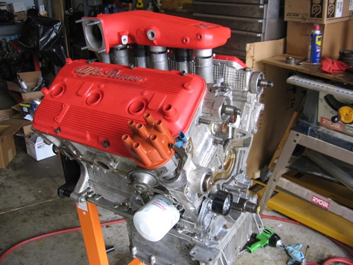

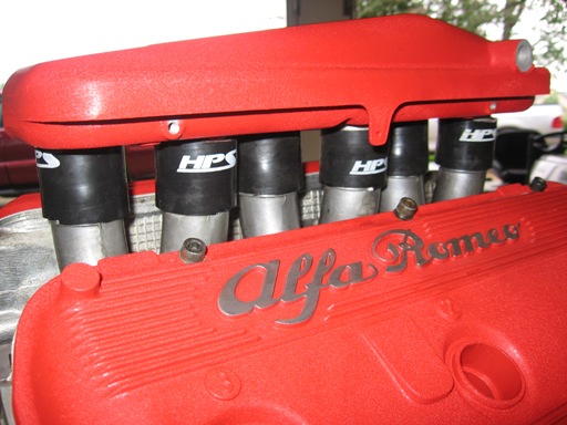

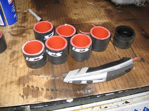

This website is a huge PITA!!! I always have to repost my stuff twice. So instead of retyping my long and informative post, I am just doing pics and one sentence
anyway, worked on 164 conversion. Coming along OK, need a few odd pieces like one m8x1.0 nut...
pics:
pics:
