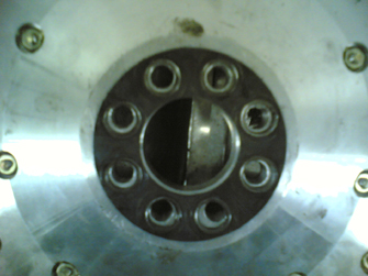

hmmm... i started taking the 24v motor apart and when i got to the clutch i figured why not bolt the 300zx fly wheel on. low and behold we have two problems. firstly the bolts to the crank are fatter than on the 2.5 motor, secondly, of the eight bolt holes two are closer than together than the rest (i.e. if the holes were enlarged they are at now only 7 of the eight bolts would line up). i have pictures of this, but i have not uploaded them yet. since this zero balanced flywheel is going to have to be balanced with the rest of the rotating assembly, will it be okay to have one oblong hole out of eight?

I guess you have figured it out but: The reason for the different distance between the holes in the flywheel and crank are that they only should fit in one way. :)
I used a 75 3,0 flywheel on my Q4 engine and then I just needed new bolts.
The Q4 bolts was to short due to thicker material in the 75 flywheel where the bolted connection is.
The 75 bolts did'nt fit due to other thread in the crank. It's fine tread in the Q4 crank.
When I compared the 75 3,0 flywheel with my GTV6 2,5 flywheel I noticed that the 3,0 one is a couple of millimeters thicker.

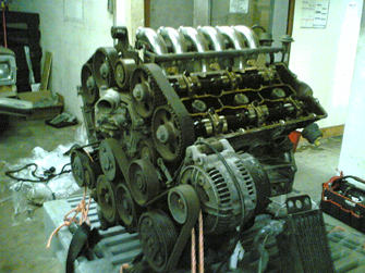

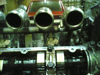

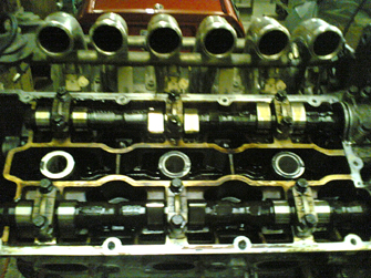

pics
Sporttunergtv6
Posts: 360
Location: New York, NY
Post by Sporttunergtv6 »

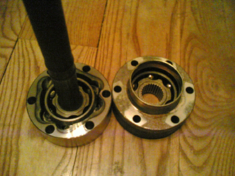

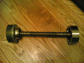

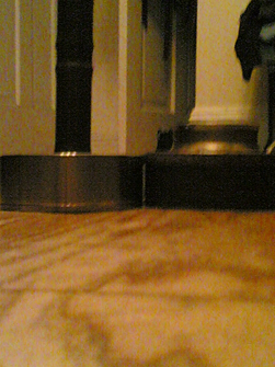

more pics: notice new 930 cv joint same except it has only one machined groove on the circumfrence (ie. you have to use the 930 boot and flange.
