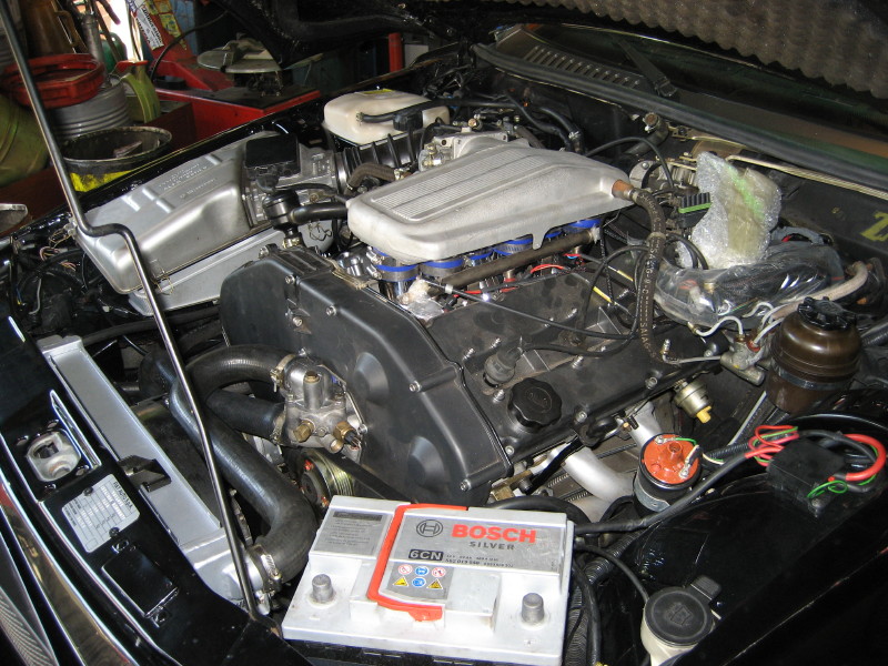

finally the engine is where it should be.
but still a lot needs to be modified for this car, heating tubes, oil pressure sender, air filterhousing....
wow, it is costing me a fortune!
i realy hope the results will be in the same way 8) 8)

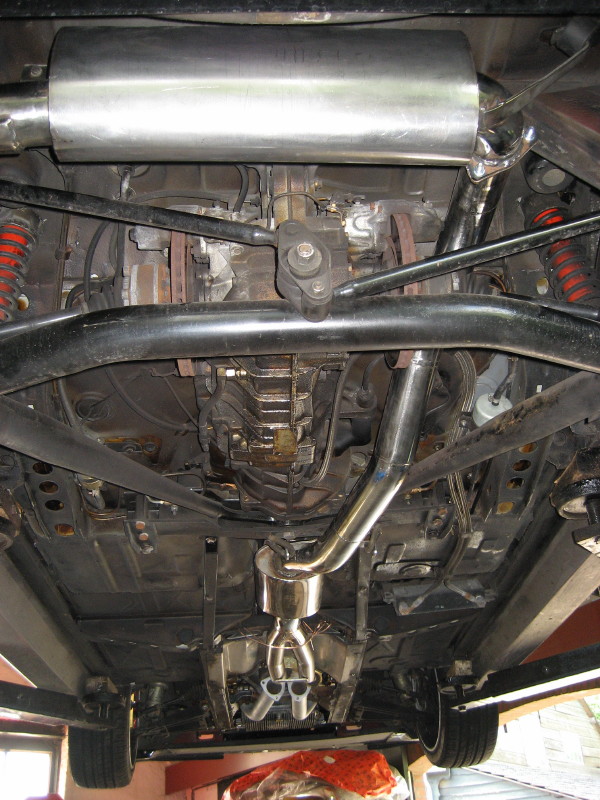

exhaust,also needs some modifications

Looks great :D Did you need to do anything about the brake booster?
What's the problem with the oil pressure sender? If the SZ is like the Milano you can either mount the separate sender (for the warning light) by fitting a "T" where the 24v gauge sender sits, or you can (try - not always easy) take out one of the allen head plugs and put the sender for the light in its own port. I have done both in the past.
BTW, interesting to see that the SZ chassis still has the perches where the 75/Milano rear springs sit on the chassis :?

that's what we're going to do: mount both senders on a T piece mounted behind the engine,far away from the heat.
the brakebooster didn't fit.i'll have to use a bmw one.
also there is no rear exit for the heating on this engine.
but as i have a seperate oilcooler we left away the original oil/water heatexchanging system and we can use one exit from the front of the engine

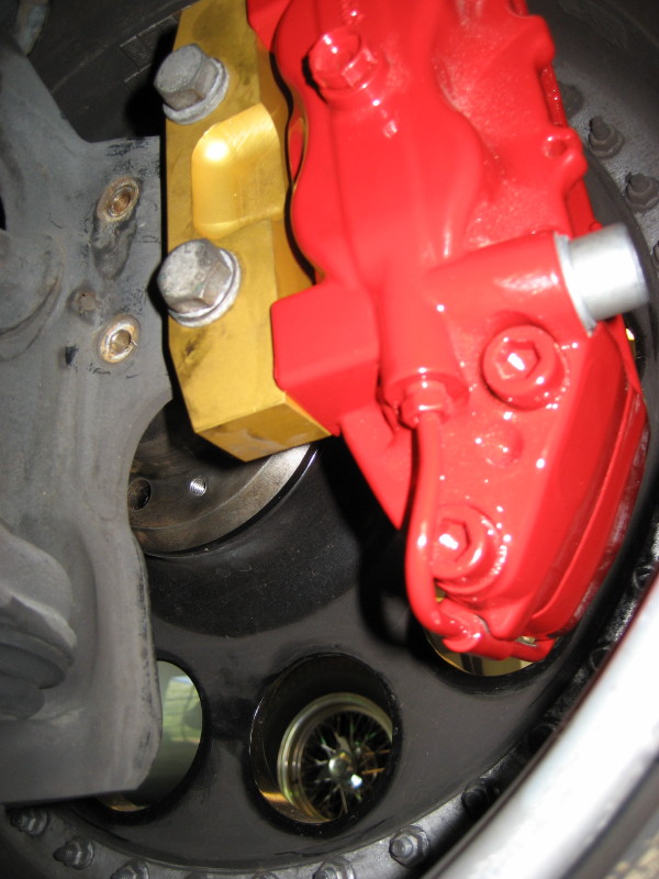

the gta brake conversion seems to fit but the centre opening in the gta disk needs to be made a bit larger to fit over the hub

Marc,
What's the plan for the airbox? Here's what Petros did:
http://alfagtv6.com/bb/files/15_136.jpg

hi zamani,
i try to keep everything as original as possible.
i use the original plastic tube with a homemade piece to fit the airbox

Marc,looking at the exhaust..two 164 front downpipes,they have some very nice flexi`s in them..Will work perfectly there..!
Im pleased to see the exhaust fits !!

barry, can i hang the exhaust rigidly against the chassis when using flexibles in front ?
and is it wise to heat the other head to open the plug for the oil light sender?or is the safer way the t piece at one exit?
