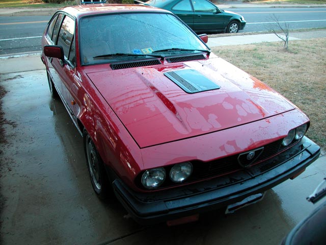

Here are a couple pic's of the car. Close to 95% complete. I just need to wrap a few things up.

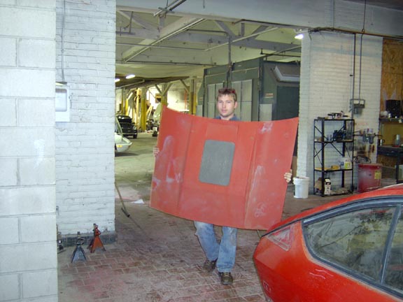

I've got a few images of what it looked like before on my phone...i'll see if i can pull them off this week! But I think you can get an idea of how bad this was when i got it by just looking at the hood.
Here's the list of suspension upgrades
Bilstien's Rear
Koni Adjustable Front
IAP Lowering Springs
Castor Rod Replacement
Poly-Bushings
SZ Dedion Bushing
It's 84 with 84,000 on the chassis and 30,000 on the motor. Next up is seats, and wheels and tires!

Me with the hood before the rebuild.

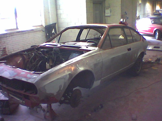

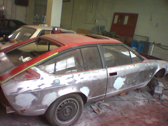

I found some of the before pics....so here they are! It's amazing how much body putty there was on this car...

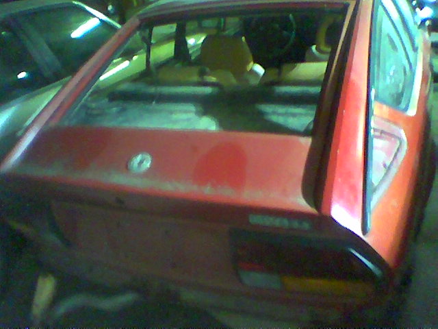

And here is the rear before and after!
What a difference!
